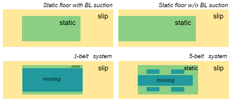

Advanced Tunnel Setup (Belts & Patch)
The “standard” external aerodynamics wind tunnel setup calls for a full moving ground configuration. Modelling setups which emulate those in wind tunnels are possible using the Belts Tool together with the Ground Patch as described below.
From the Property Editor, enable the checkbox under .
Note: Enabling Boundary Layer Suction sets the boundary condition of the ground upstream of the boundary layer suction line (blue dotted line) to a slip wall boundary condition. Enabling boundary layer suction is recommended whenever static ground conditions apply to the simulation. This includes moving belts surrounded by a static ground region.
Note: Enabling Ground Patch sets the boundary condition of a region of the ground – which extends from the center of the vehicle to upstream, downstream, and to each side a pre-set distance away from the vehicle based on the vehicle’s dimensions and belt dimensions in whenever applicable – to a zero-velocity non-slip wall boundary. Enabling the ground patch is recommended whenever static ground conditions apply to the simulation. This includes moving belts surrounded by a static ground region.
Figure 7.

Ground (Advanced)
When not using the “Standard” ground setup of full moving ground, the use of turbulence generators near the boundary layer suction region is recommended.
