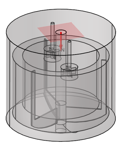

Figure 5.
- Right-click anywhere in the modeling window then pick and Small impeller 2.
- In the microdialog, set the average size to 0.00125
On the guide bar, click
to execute

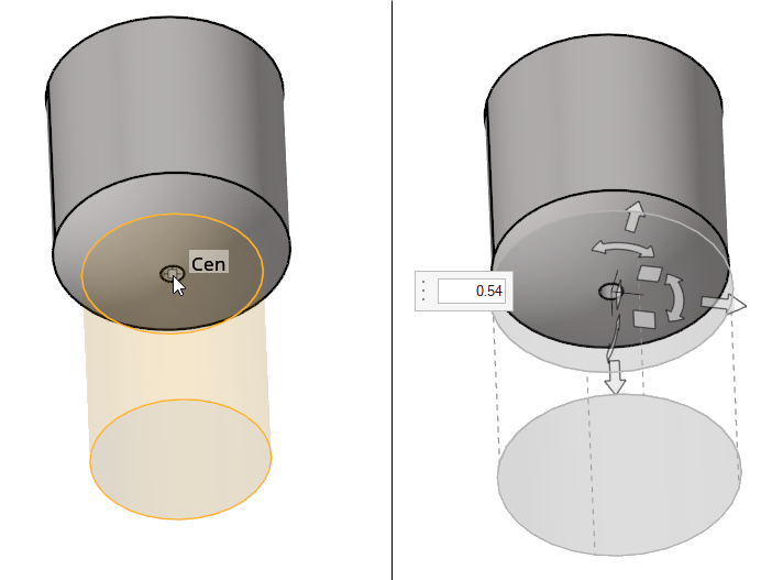

Snap the cylindrical zone to the center of the shaft as shown in Figure 7. Drag your
mouse and click anywhere on the screen to define a temporary size for the
cylinder. In the radius microdialog, enter a value of
0.54 and press Enter.
Figure 7.

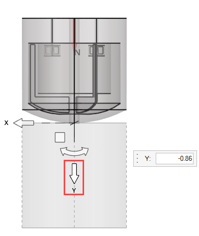

- In the new microdialog, enter a value of 1 for the Height (H) dimension.
- Click on the white arrow pointing in the Y direction to move the zone along the Y-axis.
Enter a value of -0.86 then press Enter to move the zone along the negative Y
direction.
Figure 8.
