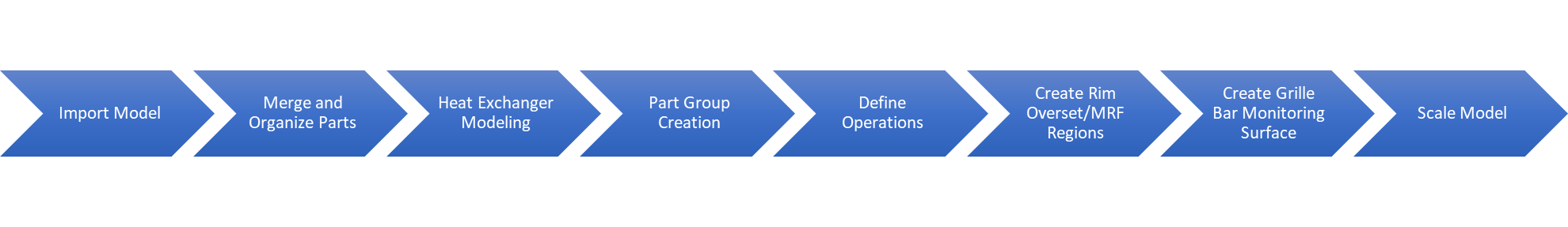

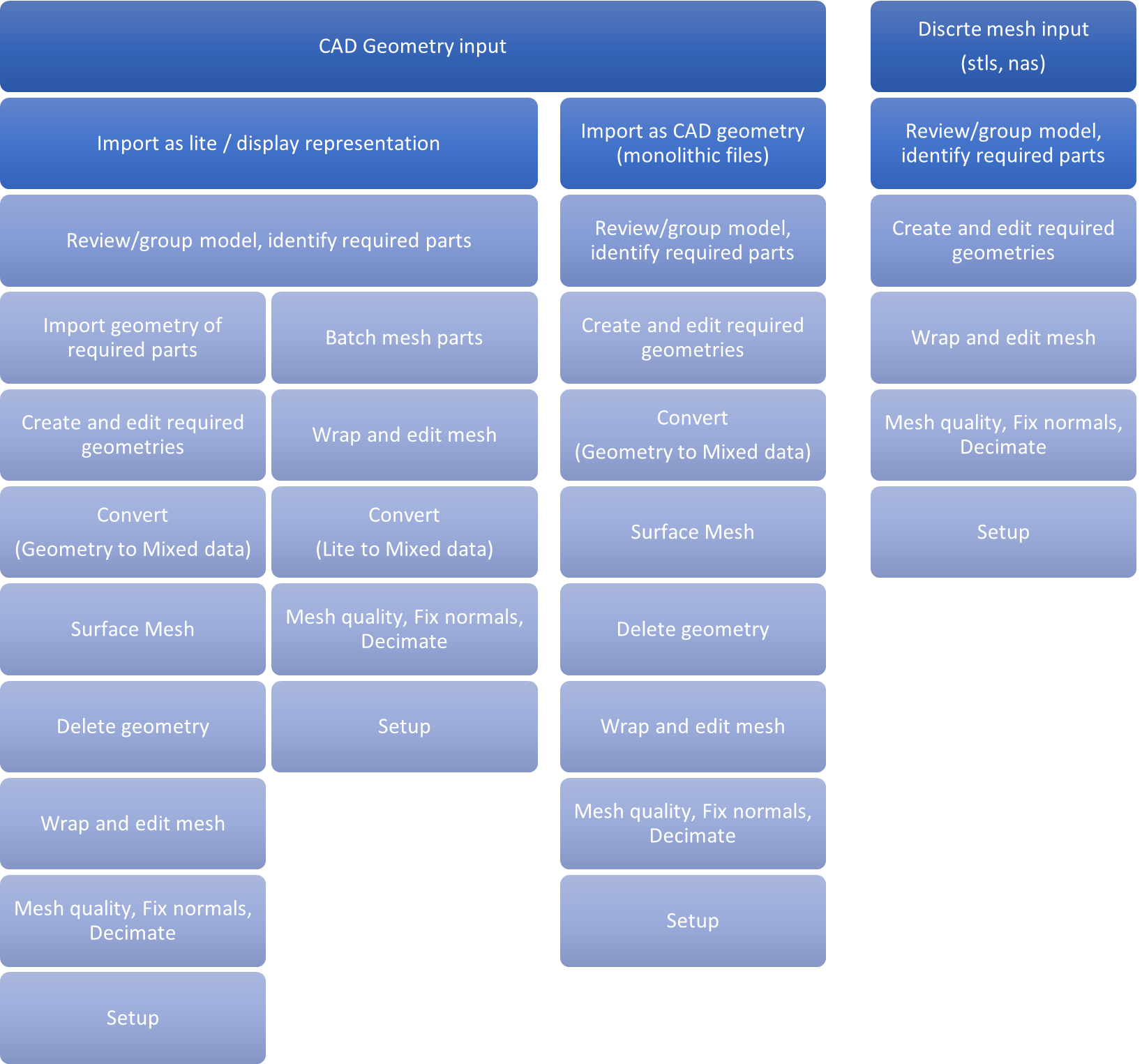

Generic Process Diagram
Tutorial Flow

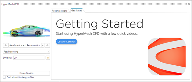

Solution and Environment Selection

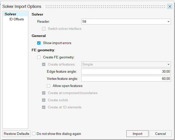

- From the horizontal toolbar, click File > Import > Solver Dek. The File Browser opens.
- From the File Browser, change the file type to STL (*.stl).
Navigate to Input Files folder and select all STL files and click Open. The
Solver Import Options Dialog opens.
Figure 4.
- Keep default options and click Import.

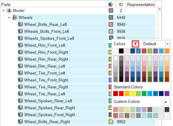

Auto-Color
- Select the parts to automatically assign different colors or use CTRL+A to select all displayed parts.
On the Part Browser: left click on any of the selected part’s color icon, then
click on the lightning bolt icon.
Figure 8.

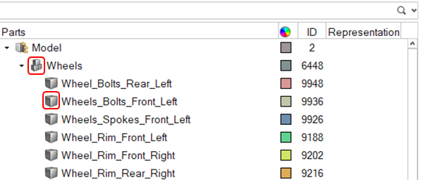

Wheels
- From the Part Browser, right click on Model, then select Create > Part Assembly.
- From the Part Browser, right click on the newly created assembly and rename as Wheels.
- Select the four imported wheel assemblies (Wheel_Front/Rear_Left/Right.stl) parts from the Part Browser and drag them into the Wheels assembly.
- From the Part Browser, right click on Model, then select Delete Empty Assemblies.

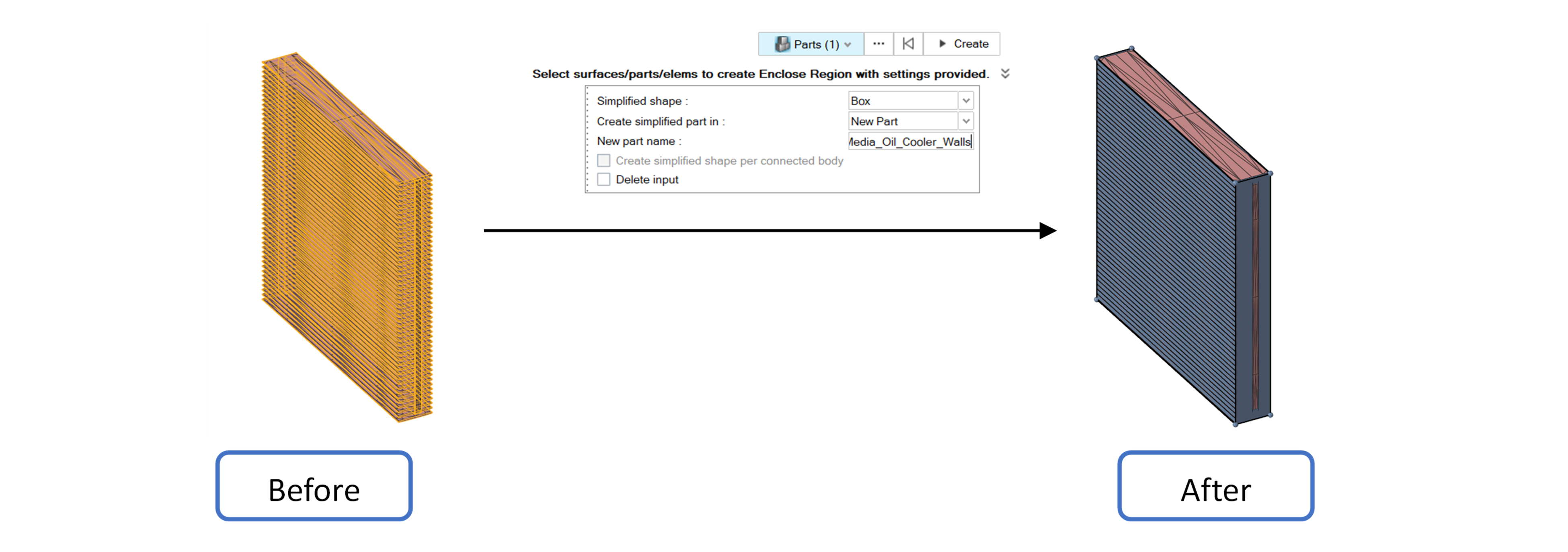

Porous Media Boxes
- From the Part Browser, type Core in the Search bar, then isolate the listed parts.
- From the ribbon selection toolbar (horizontal toolbar), click Geometry.
From the Geometry ribbon, click on the Simplify Region Tool. The Simplify
Region Guide Bar and Simplify Region Micro-Dialog open.
Figure 9.
- Select the Cooling_Module_Transmission_Oil_Cooler_Core part.
From the Simplify Region Guide Bar, set Create simplified part in to New Part,
New part name to Porous_Media_Transmission_Oil_Cooler_Walls, activate the Delete
input checkbox , then press Create.
Figure 10.
- Repeat Steps 4 and 5 for the Cooling_Module_Low_Temperature_Radiator_Core and the Cooling_Module_Condenser_Core, naming the parts as Porous_Media_Low_Temperature_Radiator_Walls and Porous_Media_Condenser_Walls respectively.

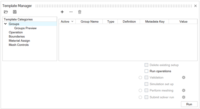

Template Manager
Part Groups
From the Geometry Ribbon click on Home > Template Manager. The Template Manager
Dialog opens.
Figure 11.
Figure 12.
Note:From the Template Manager Dialog, groups can be created by either clicking the plus sign or the three dots.
From Template Manager Dialog > Template Categories > Groups, click the three
dots button. The Group Specification Dialog opens.

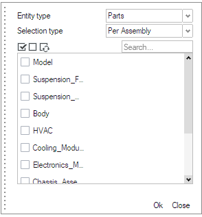

From the Group Specification Dialog, set Entity type to Parts, Selection type
to Per Assembly, enable the Create group per selection checkbox, select the
Wheels assembly and press Ok. Then press Close to close the Group Specification
Dialog.

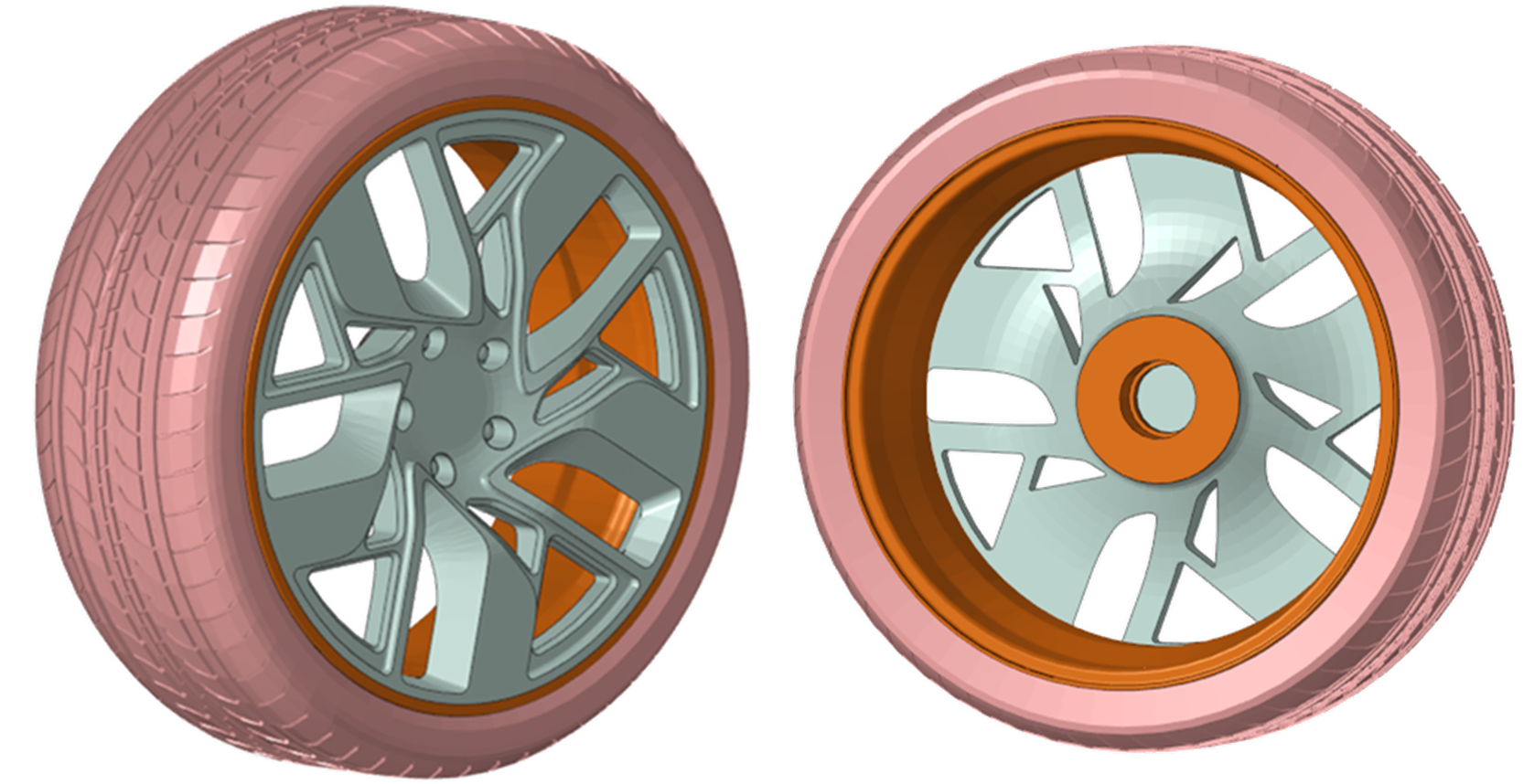

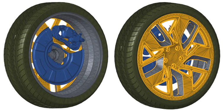

Wrap Wheels and Fix Normals
From Template Manager Dialog > Template Categories > Operation, click on the
plus sign
. A new row is added to the table.
plus sign
- From the newly created row, set Operation to Bulk Operations and Group Selection to Wheels.
- From the newly created row, click on the Edit button under the Definition column. The Operation Definition Parameters Dialog opens.
- From the Operation Definition Parameters Dialog, enable the checkboxes for CAD wrap parameters, and Fix normal. Within the CAD wrap parameters, enable Split large elements size > and set its value to 10, enable Stitch free edges and set the Stitch tolerance to 0.1, enable Resolve Overlaps and set the Overlap tolerance to 0.1, set the Maximum allowed gap to 4.0, the Baffle treatment to Remove, and the Baffle thickness to 2.0. Within the Fix normal parameters, set the Fix method to By Connectivity.
plus sign
- From the newly created row, set Operation to Bulk Operations and Group Selection to Body.
- From the Operation Definition Parameters Dialog, enable the checkboxes for CAD wrap parameters, and Fix normal. Within the CAD wrap parameters, enable Split large elements size > and set its value to 12.5, enable Stitch free edges and set the Stitch tolerance to 0.1, enable Resolve Overlaps and set the Overlap tolerance to 0.1, set the Maximum allowed gap to 5.0, enable Auto seal, set the Baffle treatment to Remove, and the Baffle thickness to 2.0, enable Leak check and set the Enclosure node coordinates to (X: 1900, Y: 0, Z:815). Within the Fix normal parameters, set the Fix method to By Connectivity.
Delete Tiny Parts and Cap Powertrain
plus sign
- From the newly created row, set Operation to Bulk Operations and Group Selection to Powertrain.
- From the Operation Definition Parameters Dialog, enable the checkboxes for Remove tiny parts, and Fill holes. Within the Remove tiny parts parameters, set Tiny parts bounding box threshold to 21.0. Within the Fill holes parameters, set the patch holes threshold to 100 and enable Consider feature edge loops.
Wrap Powertrain and Fix Normals
plus sign
- From the Operation Definition Parameters Dialog, enable the checkboxes for CAD wrap parameters, and Fix normal. Within the CAD wrap parameters, enable Split large elements size > and set its value to 15.0, enable Stitch free edges and set the Stitch tolerance to 0.1, enable Resolve Overlaps and set the Overlap tolerance to 0.1, set the Maximum allowed gap to 3.0, set the Baffle treatment to Remove, and the Baffle thickness to 2.0. Within the Fix normal parameters, set the Fix method to By Connectivity.
Wrap Fan Parts and Fix Normals
plus sign
- From the newly created row, set Operation to Bulk Operations and Group Selection to Fan_Assembly.
- From the Operation Definition Parameters Dialog, enable the checkboxes for CAD wrap parameters, and Fix normal. Within the CAD wrap parameters, enable Per part wrap, enable Split large elements size > and set its value to 10.0, enable Stitch free edges and set the Stitch tolerance to 0.1, enable Resolve Overlaps and set the Overlap tolerance to 0.1, set the Maximum allowed gap to 4.0, set the Baffle treatment to Remove, and the Baffle thickness to 2.0. Within the Fix normal parameters, set the Fix method to By Ray Tracing.
Tessellate Porous Media Surfaces
plus sign
- From the newly created row, set Operation to Tessellation and Group Selection to Porous_Media.
- From the Operation Definition Parameters Dialog, set Unmeshed surface meshing method to Faceting and Faceting size definition to Normal.
Run
Template Import/Export
To export the template, from the Template Manager Dialog, click on the save
button
on the top of the window.
To import a template into the template manager, from the Template Manager
Dialog, click on the folder
button on the top of the window.

- From the Part Browser, type Caliper in the Search bar, Isolate the Suspension_Brake_Calipers_Front and Suspension_Brake_Calipers_Rear parts, then clear the search bar and Show the Wheels assembly.
From the Discrete Ribbon go to Edit > Create Topology to open the Create
Topology Tool. The Create Topology Guide Bar opens.
Figure 15.
- From the Create Topology Guide Bar, open the Advanced Selection Tool by pressing the button with the three dots.
- From the Advanced Selection Tool, set the selection mode to By Part, then type Wheel_Rim in the search bar, group select the filtered parts and press OK.
- From the Create Topology Guide Bar, press Convert.
From the main Ribbon, click on the Convert Tool. The Convert Model Micro-Dialog
opens.
Figure 16.
- From the Convert Model Micro-Dialog, set the Convert to parameter to Mixed and press Convert.
From the Geometry Ribbon click on the Revolve Region Tool. The Revolve Region
Guide Bar opens.
Figure 17.
- From the Revolve Region Guide Bar, set the selection mode of the Rotating components to Surfaces then open the Advanced Selection Tool for the Rotating components by clicking on the first three dots button from the left in the Revolve Region Guide Bar. The Advanced Selection Guide Panel opens.
- From the Advanced Selection Guide Panel, set the selection type to By Parts and type Wheel_Rim in the Search Bar.
- Select Wheel_Rim_Front_Left from the filtered parts and close the Advanced Selection Guide Panel.
From the Viewer, unselect (Shift+ left click) the surfaces which are not part
of the spokes until the selection matches that shown in Figure 17 below.
Figure 18.
- From the Revolve Region Guide Bar, set the selection type of the Non Rotating components to Parts then select the Suspension_Brake_Calipers_Front part.
From the Revolve Region Guide Bar, press the Axis button and hover over the
wheel rim cap until the axis snaps to the wheel centerline as shown in Figure 18
below. Once it does, left click to select that as your axis of rotation.
Figure 19.
From the Revolve Region Guide Bar, set the Extraction value to Spin Surface,
the Offset Value form Rotating Region to 9, the Offset Value from Non Rotating
Region to 3 and the New part name value to VREV_Wheel_Spokes_Front_Left then
press Create. The spin surface is created.
Note: After the Revolve Region the Spin Surface are created, you may need to select these and organize them to the VREV_Wheel_Spokes_Front_Left part.
- Exit the Revolve Region Tool.

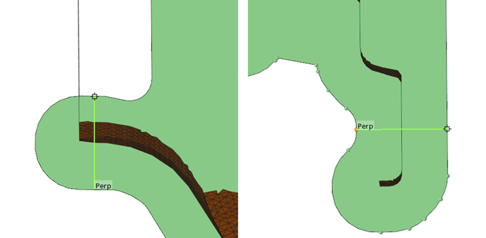

Trim the VREV_Wheel_Spokes_Front_Left surface near the hub and rim lip regions
as shown in the left and right images of the figure below.
Figure 23.
Delete the trimmed surfaces as shown in the figure below.

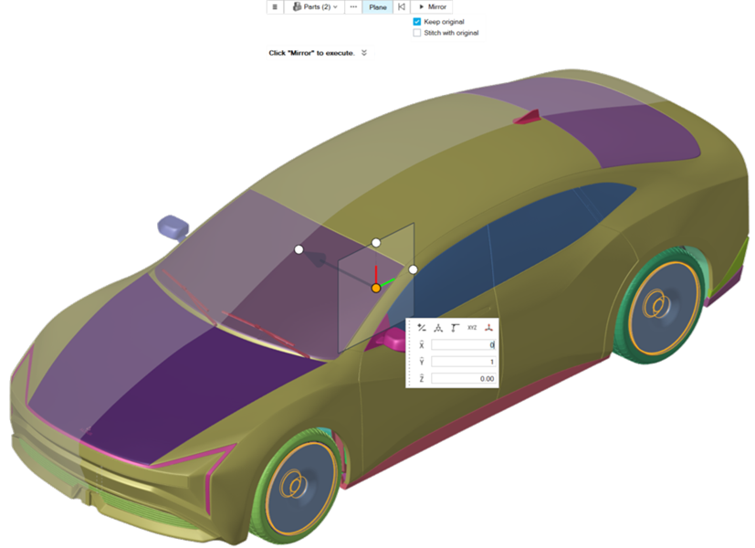

Mirror
From the Geometry Ribbon go to Edit > Mirror to open the Mirror Tool. The
Mirror Guide Bar opens.
Figure 31.
- Show all parts, then select the VREV_Wheel_Spokes_Front_Left and VREV_Wheel_Spokes_Rear_Left parts.
- From the Mirror Guide Bar, click on the Plane button. The Plane Micro Dialog opens.
- From the Plane Micro Dialog, set the plane vector to (X: 0, Y: 1, Z: 0), then click on the XYZ (position) button to specify the origin as (X: 0, Y: 0, Z: 0).
From the Plane Micro Dialog, enable Keep original.
Figure 32.
Inspect the mirror preview and from the Plane Micro Dialog, click on
Mirror.
The created parts (duplicate and mirrored) are connected to each other, not allowing to change their names. The link between them must be broken.

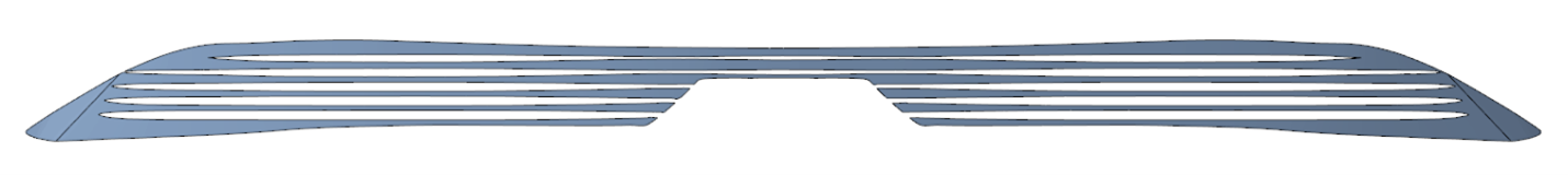

Grille Bars Monitoring Surface
- Select the Body_Exterior_Body part and isolate it.
Set the selector to Elements, then right-click anywhere in the graphics area
and activate Polyline select.
Figure 36.
Select the body area around the grille bars as shown below and isolate
it.
Figure 37.
- From the Geometry ribbon, click on the Simplify Region Tool. The Simplify Region Guide Bar and Simplify Region Micro-Dialog open.
- Set the selector to Elements and select all the displayed elements.
- From the Simplify Region Guide Bar, set Simplified shape to Convex Fit, Create simplified part in to New Part, and set the New part name to Monitoring_Surface_Grille_Bars.
- From the Simplify Region Guide Bar, click Create.
- Exit the tool.
- Select the Monitoring_Surface_Grille_Bars part and isolate it.
- From the Discrete Ribbon click on the Surface Meshing Tool. The Surface Tool Guide bar and Mesh Operations Micro Dialog open.
- From the Mesh Operations Micro Dialog, set the Meshing method to Rigid Body, the Mesh size to Maximum Size, the Maximum element size to 20, the Maximum size factor to 0.01, the Geometric feature angle to 15, and the Maximum deviation factor to 0.002, then from the Surface Tool Guide bar, click Mesh.
- Exit the Surface Meshing Tool.
- Set the selector to surfaces, then select all the Monitoring_Surface_Grille_Bars surfaces and delete them with the delete associated elements option off.
- From the Discrete Ribbon go to Edit > Create Topology to open the Create Topology Tool. The Create Topology Guide Bar opens.
- From the Create Topology Guide Bar, select the Monitoring_Surface_Grille_Bars part elements and click Convert.
Select all surfaces except the front one and delete them with the delete
associated elements option on.
Note: In case the front surface cannot be selected differently from the other surfaces, form the Discrete Ribbon, go to Edit > Update Topology. While in this tool, click on the hamburger menu located on the far left off the Guidebar and change the method from Simple to Connected.
Figure 38.

- From the viewer, select the Monitor_Surface_Grille_Bars part.
- From the Decimate Tool Micro Dialog, set Decimate with element size to 1.0 and Feature angle constraints to 1.0.
- From the Decimate Tool Guide Bar, click on Decimate.
- Place the Monitor_Surface_Grille_Bars part in a new assembly named Monitor_Surfaces.
