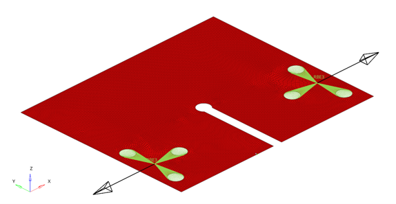

The model is a test specimen of thickness 9.5 mm, subjected to tensile loading of 1150 N at circular holes, normal to the notch. The model was meshed with first-order shell elements and the loading is applied to RBE3 elements that are connected to the holes. The Signed Von Mises (SGVON) combined stress was used.

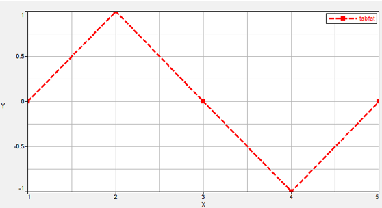

A constant amplitude load is applied in the FATLOAD entry with a scale factor of
14.1332, whose variation is:
| Time Points | Load Curve Point |
| 0 | 0.0 |
| 1 | 1.0 |
| 2 | 0.0 |
| 3 | -1.0 |
| 4 | 0.0 |
