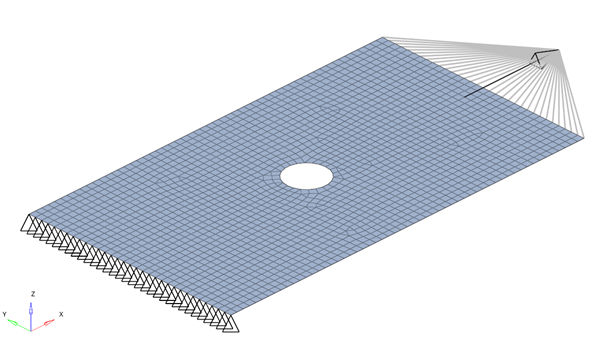

The model is a test specimen of thickness 6.0 mm, width 16.0 mm and center hole of diameter 3.0 mm. The notched plate is subjected to variable stress time history (Load of 1N and scaled with a load history profile shown below) and is assumed to follow elastic behaviour. The model was meshed with first-order shell elements and the loading is applied to RBE3 element. The Absolute Max principal combined stress was used.

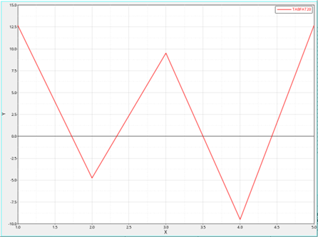

Load History Profile
| Time | Scale |
| 0 | 12.68 |
| 1 | -4.755 |
| 2 | 9.51 |
| 3 | -9.51 |
| 4 | 12.68 |
Load points are further scaled by 1000 within the fatigue event.
