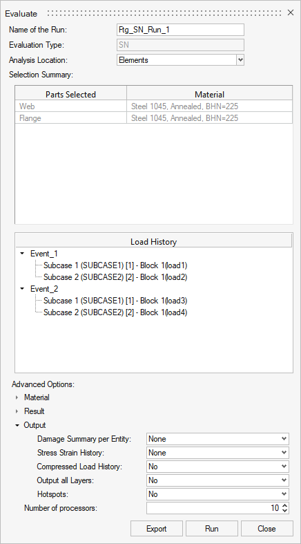

From the Evaluate tool group, click the
Run Analysis tool.
The Evaluate dialog opens.Figure 2.
- Optional: Change the name of the run.
- For Analysis Location, select Elements/Nodes.
- Review the selected parts and loadcase.
- Optional:
Under Advanced Options and Material, define the material options.
- SN Curve Extrapolation can be set to True/False for Multiple SN curve interpolation.
- Multiple Haigh Interpolation Method options are Mean Stress = Constant or Stress Ratio = Constant.
- Optional:
Under Advanced Options and Result, you can calculate the safety factor for a
specified amount of target cycles for SN uniaxial runs.
- Change the Safety Factor drop-down to Stress Ratio = Const / Mean Stress = Const / Scale.
- Enter a value for the target cycles.
- Optional:
Under Advanced Options and Result, select the Scale Result.
You can scale Life based on Equivalent Lie units or scale Damage based on Allowable Miner Sum.
- Optional:
Under Advanced Options and Result, define the static failure options for
SN.
- Change to Continue or Stop for Static Failure options.
- Retain No Check to avoid Static Failure check.
- Optional:
Define Advanced Options for output.
Supported only for Loading types: Time series, Transient, and Modal Superposition.
- Damage Summary per Entity: EventwiseDamage.csv will be written to Run folder. The option is activated when either a set or CSV with Element/Node IDs are assigned. The IDs are identified based on Analysis Location.
- Stress Strain History: Stress or Strain History based on Stress Life or Strain Life selected is output to the Run folder in RSP format. The option is activated when either a set or CSV with Element/Node IDs are assigned. The IDs are identified based on Analysis Location.
- Compressed Load History: Compressed load history file per event is output to the Run folder in RSP format. The option is activated by Yes/No.
- Output all Layers: Contour of fatigue results for all evaluated layers.
- HotSpots: Output Hotspot clusters (sets) of Elements/Nodes (based on
analysis location). On activation, the CSV sets will be written to run
directory. The following options are to be assigned:
- Number of Hotspots: number of hotspot clusters to be detected.
- Threshold Ratio: percentage of the max element damage used to create the required cluster.
- Damage Limit: entities with damage less than the damage limit will not participate in Hotspot creation.
Note: Hotspots are not supported for DangVan FOS and weld fatigue evaluation. - Optional:
Click Export to export a Batch Input File.
See for more information on batch submission.
- Optional: For a faster solution time, change the number of processors used for the run (based on availability).

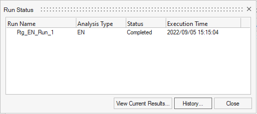

Click Run.
The Run Status dialog opens.
Figure 3.
Note: If you do not assign any time history to an event, you are prompted about the missing channel when you click Run.
