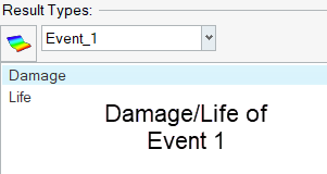

Choose the result type to contour.
By default, the fatigue results contour shows the total damage/life/safety factor/target stress, and so on.
If the Output event wise results option is turned on in , you have the option to contour total fatigue results or fatigue results specific to an event.Figure 3.
The visualization types dynamically update based on your selection from the drop-down menu.Figure 4.
Note:- The damage shown per event/total is the final damage after multiplied with repeats.
- Session files (.hlf) will retain the fatigue results of each event computed.

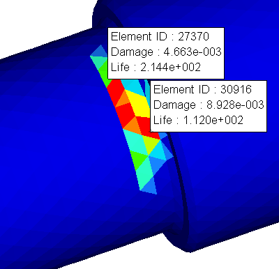

Review information for specific elements in the following ways:
- Enter an element ID in the Callouts text box. To highlight multiple elements, enter a comma separated list of IDs.
- Click
and select elements in the
modeling window.Figure 6.
Right-click on an element ID and select Delete or Delete All to remove call outs.Note: Call outs on elements are specific to the event that's contoured. -

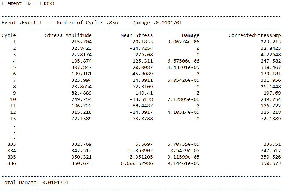

The *.rfout file contains the rainflow cycle count for each fatigue event for the queried element highlighted in damage/rainflow matrix.
The total damage, which is the cumulative damage, is written at the end of all event details.
- Element ID
- The element ID in consideration.
- Event
- The ID of the fatigue event.
- Number of Cycles
- Number of rainflow cycles detected for the current element in the current fatigue event.
- Damage (besides event header)
- Damage in the fatigue event.
- Cycle
- Rainflow cycle ID.
- Stress Amplitude
- Stress amplitude of the current cycle.
- Mean Stress
- Mean stress of the current cycle.
- Damage
- Damage value of the current cycle.
- CorrectedStressAmp
- Corrected Stress Amplitude based on mean stress model selected.Note: Corrected Stress Amplitude output is only supported for Time Series and Transient Response type of loading.

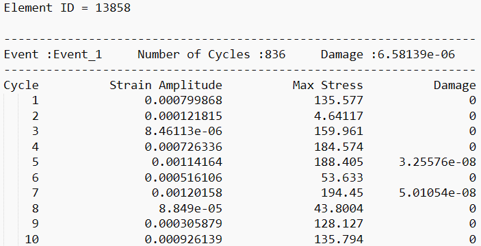

- Cycle
- Strain Amplitude
- Strain amplitude of the current cycle.
- Max Stress (SWT)
- Max stress of the current cycle.
- Mean Stress (MORROW)
- Mean stress of the current cycle.Note: Based on the mean stress model selected, one of the above columns (Max stress or Mean Stress) will be available in the rainflow matrix.
- Damage

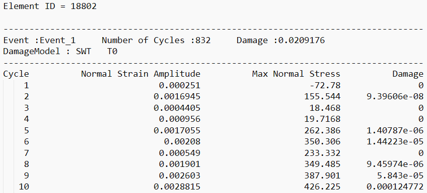

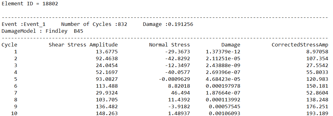

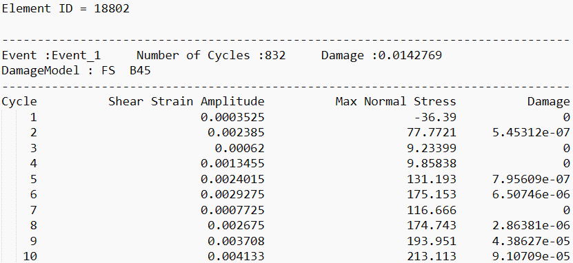

- Element ID
- Event
- Number of Cycles
- Damage Model
- Damage model being used for this cycle. Additionally, it also lists the critical plane determined to have the maximum damage (possible planes are T0, A0, A45, B45).
- Cycle
- Normal Stress Amplitude
- Stress amplitude of normal stress for the current cycle (Goodman).
- Mean Stress
- Mean stress of the current cycle (Goodman).
- Shear Stress Amplitude
- Stress amplitude for the current cycle (Findley).
- Normal Stress
- Normal stress of the current cycle (Findley).
- Damage
- Corrected stress amplitude based on mean stress model selected.
- Element ID
- Event
- Number of Cycles
- Damage Model
- Cycle
- Normal Strain Amplitude
- Strain amplitude of normal strain for the current cycle (SWT).
- Max Normal Stress
- Mean stress of the current cycle (SWT)
- Shear Strain Amplitude
- Strain amplitude for the current cycle (FS).
- Normal Stress
- Normal stress of the current cycle (FS).
- Strain amplitude for the current cycle (BM).
- Mean Stress
- Mean stress of the current cycle (BM).
- Damage

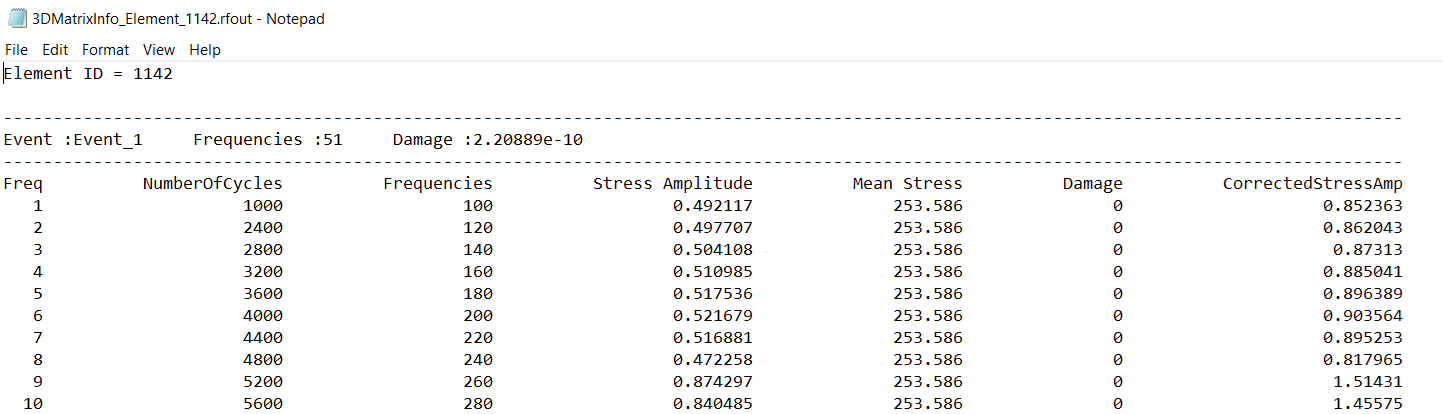

- Element ID
- Event
- Frequencies
- Number of frequencies in the Sine Sweep fatigue analysis for the current subcase.
- Total damage in the event.
- Freq
- Number/ID of the current frequency of interest.
- Number of Cycles
- Number of cycles of the particular frequency of interest.
- Stress Amplitude
- Magnitude of stress amplitude.
- Mean Stress
- Magnitude of mean stress.
- Damage
- Cumulative damage value of all cycles at the current stress amplitude.
