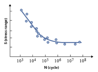

The S-N and E-N curves (and other fatigue properties) of a material is obtained from experiment; through fully reversed rotating bending tests. Due to the large amount of scatter that usually accompanies test results, statistical characterization of the data should also be provided (certainty of survival is used to estimate the worst mean log(N) according to the standard deviation of the curve and a higher reliability level requires a larger certainty of survival).
Figure 2. S-N Curve with Scatter Data
To understand these parameters, let us consider the S-N curve as an example. When S-N testing data is presented in a log-log plot of alternating nominal stress amplitude Sa or range SR versus cycles to failure N, the relationship between S and N can be described by straight line segments. Normally, a one or two segment idealization is used.

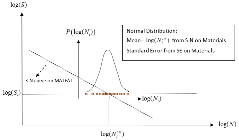

As with many processes, the distribution of Log(N) is assumed to be a Normal Distribution. There is a full population of possible values of log(N) for a particular value of log(S). The mean of this full population set is the true population mean and is unknown. Therefore, statistically estimate the worst true population mean of log(N) based on the input sample mean SN curve in Materials and Standard Error in the Material DB and My Material tabs of the sample. The SN material data input in the Material DB and My Material tabs is based on the mean of the normal distribution of the scatter in the particular user sample used to generate the data.
Figure 4. Probability Function of the Log(N) Normal Distribution for S-N Scatter. of a particular user-defined sample data

If the specified S-N curve is directly utilized, without any perturbation, the sample mean is directly used, leading to a certainty of survival of 50%. This implies that OptiStruct does not perturb the sample mean provided in the Assign Material dialog. Since a value of 50% survival certainty may not be sufficient for all applications, HyperLife can internally perturb the S-N material data to the required certainty of survival defined by you. To accomplish this, the following data is required.
  1. Standard Error of log(N) normal distribution (SE in Assign Material).
  2. Certainty of Survival required for this analysis (Certainty of Survival in the Fatigue Module context).
A normal distribution or gaussian distribution is a probability density function which implies that the total area under the curve is always equal to 1.0.
The user-defined SN curve data is assumed as a normal distribution, which is typically characterized by the following Probability Density Function:

The standard deviation of the sample (which is unknown, as you input only Standard Error (SE) in the Assign Material dialog).
The above distribution is the distribution of the user-defined sample, and not the full population space. Since the true population mean is unknown, the estimated range of the true population mean from the sample mean and the sample SE and subsequently use the user-defined Certainty of Survival to perturb the sample mean.
Standard Error is the standard deviation of the normal distribution created by all the sample means of samples drawn from the full population. From a single sample distribution data, the Standard Error is typically estimated as S E = ( σ s n s ) MathType@MTEF@5@5@+= feaagKart1ev2aaatCvAUfeBSjuyZL2yd9gzLbvyNv2CaerbuLwBLn hiov2DGi1BTfMBaeXatLxBI9gBaerbd9wDYLwzYbItLDharqqtubsr 4rNCHbGeaGqiVu0Je9sqqrpepC0xbbL8F4rqqrFfpeea0xe9Lq=Jc9 vqaqpepm0xbba9pwe9Q8fs0=yqaqpepae9pg0FirpepeKkFr0xfr=x fr=xb9adbaqaaeGaciGaaiaabeqaamaabaabaaGcbaGaam4uaiaadw eacqGH9aqpdaqadaqaceaacfWaaSWaaSqaaiabeo8aZnaaBaaameaa caWGZbaabeaaaSqaamaakaaabaGaamOBamaaBaaameaacaWGZbaabe aaaeqaaaaaaOGaayjkaiaawMcaaaaa@3FB0@ , where σ s MathType@MTEF@5@5@+= feaagKart1ev2aqatCvAUfeBSjuyZL2yd9gzLbvyNv2CaerbuLwBLn hiov2DGi1BTfMBaeXatLxBI9gBaerbd9wDYLwzYbItLDharqqtubsr 4rNCHbGeaGqiVu0Je9sqqrpepC0xbbL8F4rqqrFfpeea0xe9Lq=Jc9 vqaqpepm0xbba9pwe9Q8fs0=yqaqpepae9pg0FirpepeKkFr0xfr=x fr=xb9adbaqaaeGaciGaaiaabeqaamaabaabaaGcbaGaeq4Wdm3aaS baaSqaaiaadohaaeqaaaaa@38DE@ is the standard deviation of the sample, and n s MathType@MTEF@5@5@+= feaagKart1ev2aqatCvAUfeBSjuyZL2yd9gzLbvyNv2CaerbuLwBLn hiov2DGi1BTfMBaeXatLxBI9gBaerbd9wDYLwzYbItLDharqqtubsr 4rNCHbGeaGqiVu0Je9sqqrpepC0xbbL8F4rqqrFfpeea0xe9Lq=Jc9 vqaqpepm0xbba9pwe9Q8fs0=yqaqpepae9pg0FirpepeKkFr0xfr=x fr=xb9adbaqaaeGaciGaaiaabeqaamaabaabaaGcbaGaamOBamaaBa aaleaacaWGZbaabeaaaaa@380E@ is the number of data values in the sample. The mean of this distribution of all the sample means is actually the same as the true population mean. The certainty of survival is applied on this distribution of all the sample means.
The general practice is to convert a normal distribution function into a standard normal distribution curve (which is a normal distribution with mean=0.0 and standard error=1.0). This allows us to directly use the certainty of survival values via Z-tables.
Note: The certainty of survival is equal to the area of the curve under a probability density function between the required sample points of interest. It is possible to calculate the area of the normal distribution curve directly (without transformation to standard normal curve), however, this is computationally intensive compared to a standard lookup Z-table. Therefore, the generally utilized procedure is to first convert the current normal distribution to a standard normal distribution and then use Z-tables to parameterize the input survival certainty.
For the normal distribution of all the sample means, the mean of this distribution is the same as the true population mean μ , the range of which is what you want to estimate.
Statistically, you can estimate the range of true population mean as:
log( N i sm )−z*SE≤μ≤log( N i sm )+z*SE MathType@MTEF@5@5@+= feaagKart1ev2aqatCvAUfeBSjuyZL2yd9gzLbvyNv2CaerbuLwBLn hiov2DGi1BTfMBaeXatLxBI9gBaerbd9wDYLwzYbItLDharqqtubsr 4rNCHbGeaGqiVu0Je9sqqrpepC0xbbL8F4rqqrFfpeea0xe9Lq=Jc9 vqaqpepm0xbba9pwe9Q8fs0=yqaqpepae9pg0FirpepeKkFr0xfr=x fr=xb9adbaqaaeGaciGaaiaabeqaamaabaabaaGcbaGaciiBaiaac+ gacaGGNbGaaiikaiaad6eadaqhaaWcbaGaamyAaaqaaiaadohacaWG TbaaaOGaaiykaiabgkHiTiaadQhacaGGQaGaam4uaiaadweacqGHKj YOcqaH8oqBcqGHKjYOciGGSbGaai4BaiaacEgacaGGOaGaamOtamaa DaaaleaacaWGPbaabaGaam4Caiaad2gaaaGccaGGPaGaey4kaSIaam OEaiaacQcacaWGtbGaamyraaaa@539A@
That is,
log( N i sm )−z*SE≤log( N i m )≤log( N i sm )+z*SE MathType@MTEF@5@5@+= feaagKart1ev2aqatCvAUfeBSjuyZL2yd9gzLbvyNv2CaerbuLwBLn hiov2DGi1BTfMBaeXatLxBI9gBaerbd9wDYLwzYbItLDharqqtubsr 4rNCHbGeaGqiVu0Je9sqqrpepC0xbbL8F4rqqrFfpeea0xe9Lq=Jc9 vqaqpepm0xbba9pwe9Q8fs0=yqaqpepae9pg0FirpepeKkFr0xfr=x fr=xb9adbaqaaeGaciGaaiaabeqaamaabaabaaGcbaGaciiBaiaac+ gacaGGNbGaaiikaiaad6eadaqhaaWcbaGaamyAaaqaaiaadohacaWG TbaaaOGaaiykaiabgkHiTiaadQhacaGGQaGaam4uaiaadweacqGHKj YOciGGSbGaai4BaiaacEgacaGGOaGaamOtamaaDaaaleaacaWGPbaa baGaamyBaaaakiaacMcacqGHKjYOciGGSbGaai4BaiaacEgacaGGOa GaamOtamaaDaaaleaacaWGPbaabaGaam4Caiaad2gaaaGccaGGPaGa ey4kaSIaamOEaiaacQcacaWGtbGaamyraaaa@58F7@
Since the value on the left hand side is more conservative, use the following equation to perturb the SN curve:
log( N i m )=log( N i sm )−z*SE MathType@MTEF@5@5@+= feaagKart1ev2aaatCvAUfeBSjuyZL2yd9gzLbvyNv2CaerbuLwBLn hiov2DGi1BTfMBaeXatLxBI9gBaerbd9wDYLwzYbItLDharqqtubsr 4rNCHbGeaGqiVu0Je9sqqrpepC0xbbL8F4rqqrFfpeea0xe9Lq=Jc9 vqaqpepm0xbba9pwe9Q8fs0=yqaqpepae9pg0FirpepeKkFr0xfr=x fr=xb9adbaqaaeGaciGaaiaabeqaamaabaabaaGcbaGaciiBaiaac+ gacaGGNbGaaiikaiaad6eadaqhaaWcbaGaamyAaaqaaiaad2gaaaGc caGGPaGaeyypa0JaciiBaiaac+gacaGGNbGaaiikaiaad6eadaqhaa WcbaGaamyAaaqaaiaadohacaWGTbaaaOGaaiykaiabgkHiTiaadQha caGGQaGaam4uaiaadweaaaa@4A56@

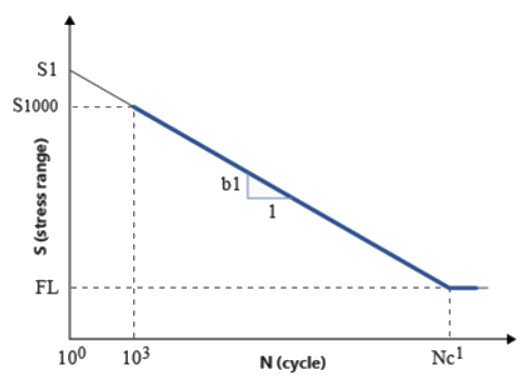

This section describes how a slope-based SN curve is modified in HyperLife.

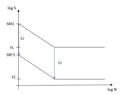

If the certainty of survival is not 0.5 and standard error (SE) is not 0.0, an SN curve is modified by shifting SRI1 and FL.
Figure 5.
S R I 1 ’   =   S R I 1   x   C r MathType@MTEF@5@5@+= feaahqart1ev3aaatCvAUfeBSjuyZL2yd9gzLbvyNv2CaerbuLwBLn hiov2DGi1BTfMBaeXatLxBI9gBaerbd9wDYLwzYbItLDharqqtubsr 4rNCHbGeaGqiVu0Je9sqqrpepC0xbbL8F4rqqrFfpeea0xe9Lq=Jc9 vqaqpepm0xbba9pwe9Q8fs0=yqaqpepae9pg0FirpepeKkFr0xfr=x fr=xb9adbaqaaeGaciGaaiaabeqaamaabaabaaGcbaaeaaaaaaaaa8 qacaWGtbGaamOuaiaadMeacaaIXaGaaiygGiaabccacqGH9aqpcaqG GaGaam4uaiaadkfacaWGjbGaaGymaiaabccacaWG4bGaaeiiaiaado eacaWGYbaaaa@438E@
FL’ = FL x Cr MathType@MTEF@5@5@+= feaahqart1ev3aaatCvAUfeBSjuyZL2yd9gzLbvyNv2CaerbuLwBLn hiov2DGi1BTfMBaeXatLxBI9gBaerbd9wDYLwzYbItLDharqqtubsr 4rNCHbGeaGqiVu0Je9sqqrpepC0xbbL8F4rqqrFfpeea0xe9Lq=Jc9 vqaqpepm0xbba9pwe9Q8fs0=yqaqpepae9pg0FirpepeKkFr0xfr=x fr=xb9adbaqaaeGaciGaaiaabeqaamaabaabaaGcbaaeaaaaaaaaa8 qacaWGgbGaamitaiaacMbicaqGGaGaeyypa0JaaeiiaiaadAeacaWG mbGaaeiiaiaadIhacaqGGaGaam4qaiaadkhaaaa@4056@
Cr =  10 z x b1 x SE MathType@MTEF@5@5@+= feaahqart1ev3aaatCvAUfeBSjuyZL2yd9gzLbvyNv2CaerbuLwBLn hiov2DGi1BTfMBaeXatLxBI9gBaerbd9wDYLwzYbItLDharqqtubsr 4rNCHbGeaGqiVu0Je9sqqrpepC0xbbL8F4rqqrFfpeea0xe9Lq=Jc9 vqaqpepm0xbba9pwe9Q8fs0=yqaqpepae9pg0FirpepeKkFr0xfr=x fr=xb9adbaqaaeGaciGaaiaabeqaamaabaabaaGcbaaeaaaaaaaaa8 qacaWGdbGaamOCaiaabccacqGH9aqpcaqGGaGaaGymaiaaicdapaWa aWbaaSqabeaapeGaamOEaiaabccacaWG4bGaaeiiaiaadkgacaaIXa GaaeiiaiaadIhacaqGGaGaam4uaiaadweaaaaaaa@44A8@
Where z is a z-value in standard normal distribution that corresponds to the certainty of survival.

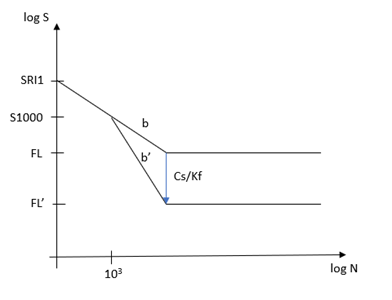

Surface Condition and Fatigue Strength Reduction Factor
A factor for surface condition (Cs) and fatigue strength reduction factor (Kf) are applied to fatigue limit to modify slope of the SN curve after 1000 cycles in the following manner.
F L ’ =   F L   *   C s /   K f MathType@MTEF@5@5@+= feaahqart1ev3aaatCvAUfeBSjuyZL2yd9gzLbvyNv2CaerbuLwBLn hiov2DGi1BTfMBaeXatLxBI9gBaerbd9wDYLwzYbItLDharqqtubsr 4rNCHbGeaGqiVu0Je9sqqrpepC0xbbL8F4rqqrFfpeea0xe9Lq=Jc9 vqaqpepm0xbba9pwe9Q8fs0=yqaqpepae9pg0FirpepeKkFr0xfr=x fr=xb9adbaqaaeGaciGaaiaabeqaamaabaabaaGcbaaeaaaaaaaaa8 qacaWGgbGaamitaiaacMbicqGH9aqpcaqGGaGaamOraiaadYeacaqG GaGaaiOkaiaabccacaWGdbGaam4Caiaac+cacaqGGaGaam4saiaadA gaaaa@4276@

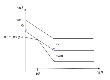

Overall SN Curve Modification
Figure 8.
Combining factors from certainty of survival, surface condition, fatigue strength reduction factor, and static failure, the final SN curve that is used in damage calculation is depicted in Figure 8.

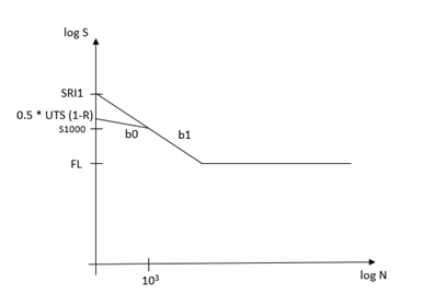

The following adjustment is applied to multi-mean stress SN curves, multi-stress ratio SN curves and Haigh diagram.
