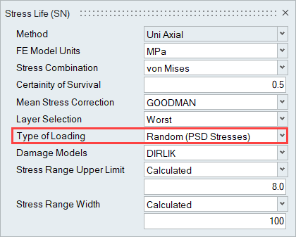

Setup
After loading an FE result file that contains a Random subcase, Random Response Fatigue is activated by setting the Type of Loading field to Random (PSD Stresses). The supported result datatypes for Random Fatigue are Segalman Von mises PSD stresses (Stress Life only) or Absolute Max Principal PSD Stresses (Stress Life and Strain Life).
Figure 3.

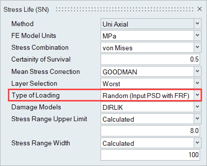

Setup
After loading an FE result file that contains a Frequency Response Analysis subcase, Random Response Fatigue is activated by setting the Type of Loading field to Random (Input PSD with FRF).
If the power spectral density of the loading versus frequency is of Magnitude and Phase, it is converted to real and imaginary.
Figure 4.

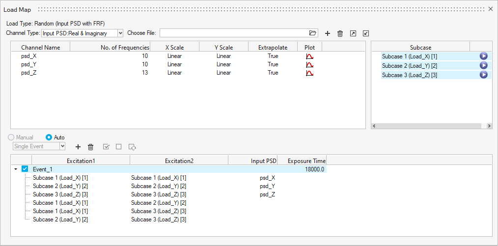

Loadmap:
Input PSD is based on the Channel Type selection.
  • Input PSD: Real and Imaginary
  • Input PSD: Magnitude and Phase
The event is created with the correlations based on the number of Frequency Response Subcases selected. The imported channels (input power spectral density of the Loading vs Frequency) are then assigned to each correlation.
Figure 5. Event Creation in the Load Map Dialog for Random Fatigue with FRF Stresses and Input PSD
Excitation1 and Excitation2 refer to the correlations of the FRF subcases. The Input PSDs are used to scale the complex stresses. If the Input PSDs are of the Phase and Magnitude form, they are internally converted to Real and Imaginary.
