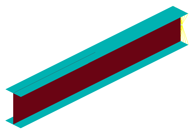

Import the Model
From the Load model and result dialog, browse and select
HL-1020\Ibeam.h3d for the model
file.
The Load Result field is automatically populated. For this tutorial, the same file is used for both the model and the result.
Click Apply.

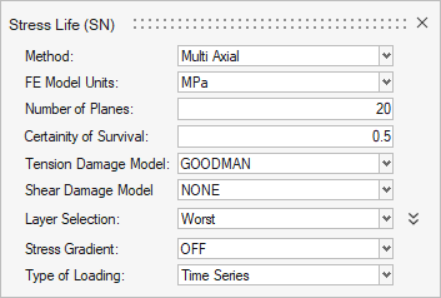

The SN dialog opens. -
Define the SN configuration parameters.
- Select Multi Axial as the method.
- Select MPa for the FE model units.
- Enter a value of 20 for the number of planes.
- Enter a value of 0.5 for the certainty of survival.
- Select GOODMAN for the Tension Damage Model.
- Select NONE for the Shear Damage Model.
- Select Worst for the layer selection.
- Select Time Series for the type of loading.
Figure 4.
- Exit the dialog.

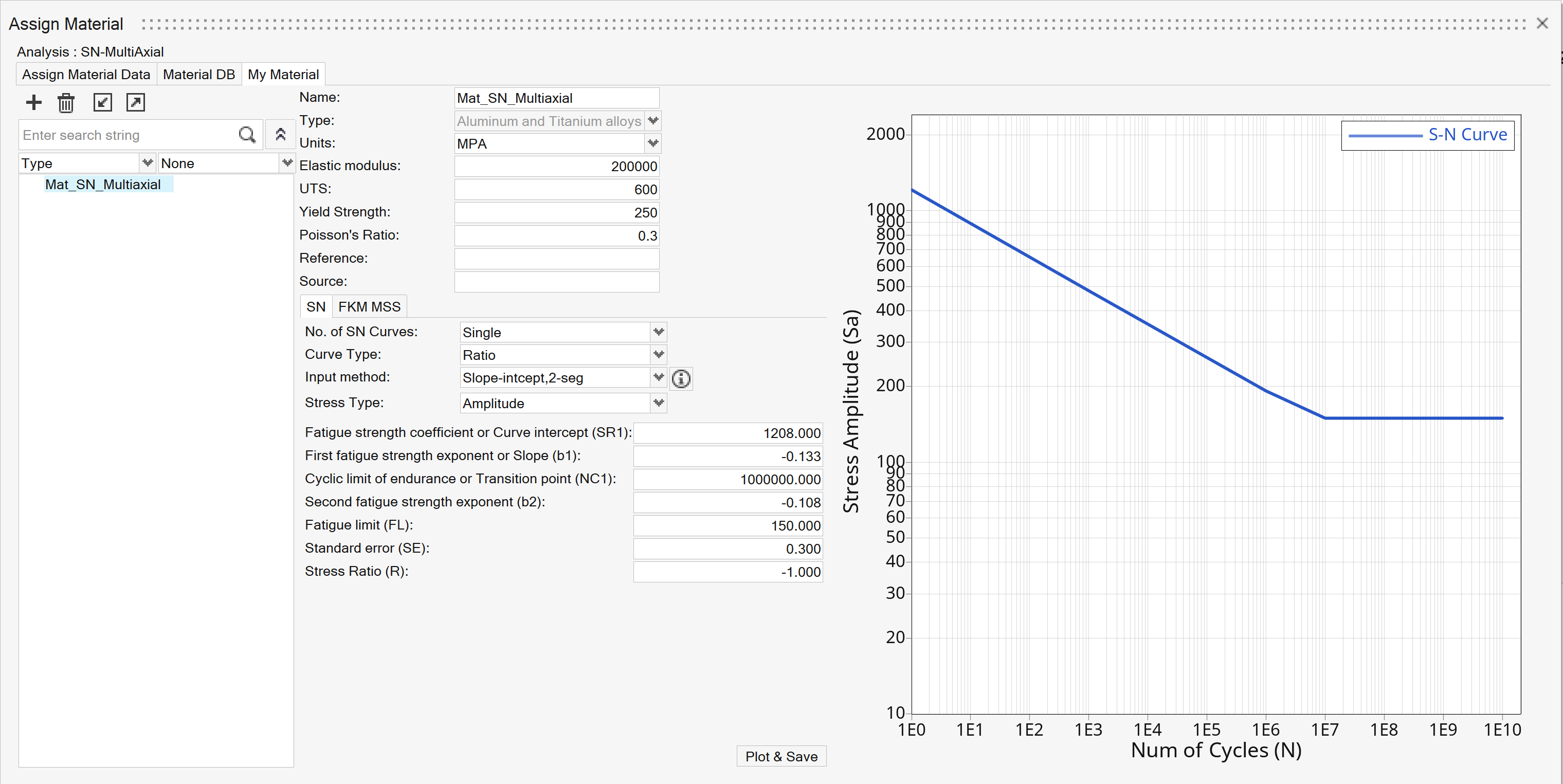

Assign Materials
Click the Material tool.
Figure 5.
The Assign Material dialog opens. - Activate the checkboxes next to the parts Flange and Web.
Create a new material.
- Right-click on Mat_SN_multiaxial and select Add to Assign Material List.
Return to the Assign Material Data tab and select
Mat_SN_multiaxial from the Material drop-down menu
for both Flange and Web.
The Material list is populated with the materials selected from Material Database and My Material.
Figure 7.
- Exit the dialog.

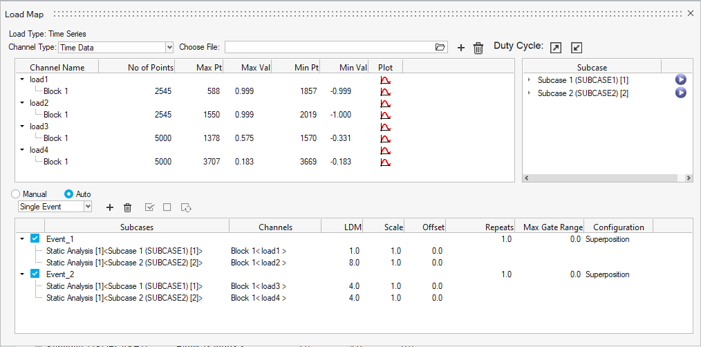

Assign Load Histories
Click the Load Map tool.
Figure 8.
The Load Map dialog opens. - From the Channel Type drop-down menu at the top of the dialog, select Time Data.
Click
in the Choose File
field and browse for load1.csv.
Click
to add the load case.
- Repeat steps 3 and 4 for load2.csv, load3.csv, and load4.csv.

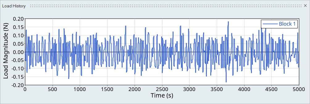

- Optional:
Click
to view a plot of the loads.
Figure 9. Load 1
Figure 10. Load 2

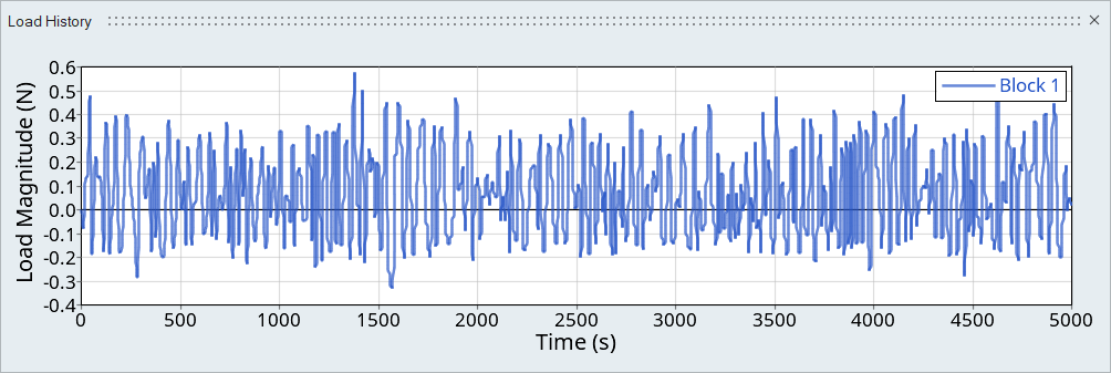

Figure 11. Load 3
Figure 12. Load 4
Tip: Expand the width of the dialog to view a clearer picture of the plot. - On the bottom half of the dialog, set the radio button to Auto for event creation.
Select both the load 1 (block1) and load 2
(block1) channels and Subcase 1 and
Subcase 2, then click
to create the first event.
- In a similar manner, create a second event by selecting load 3 (block1), and load 4 (block1), Subcase 1, and Subcase 2.
- Activate the checkboxes for the two events.
Set the Scale as shown in the image below.
Figure 13.
- Exit the dialog.

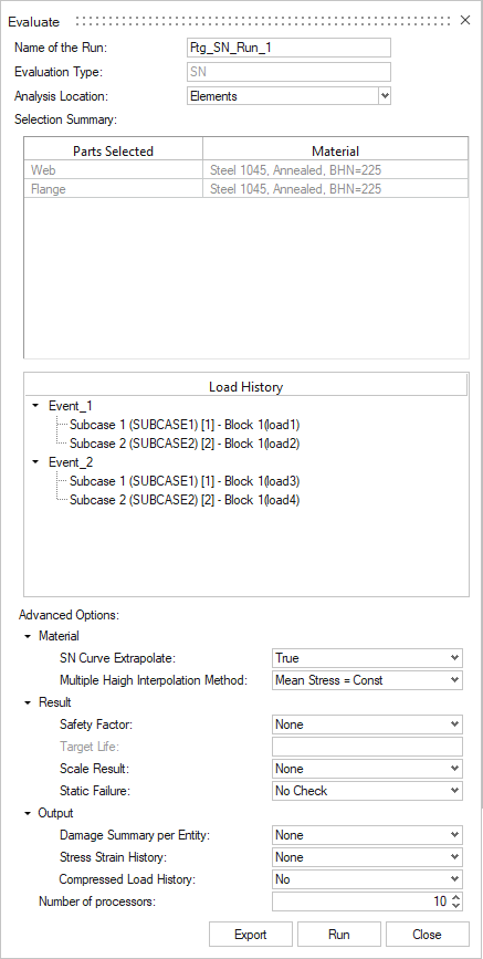

Evaluate and View Results
From the Evaluate tool group, click the
Run Analysis tool.
Figure 14.
The Evaluate dialog opens.Figure 15.
- Optional: Enter a name for the run.
Click Run.
Result files are saved to the home directory and the Run Status dialog opens.

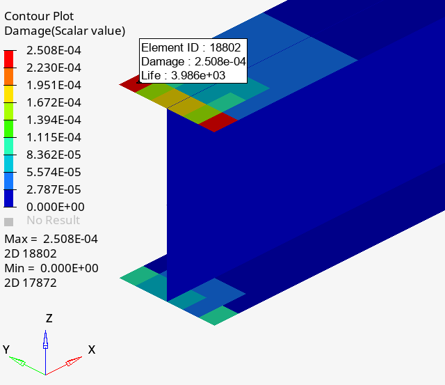

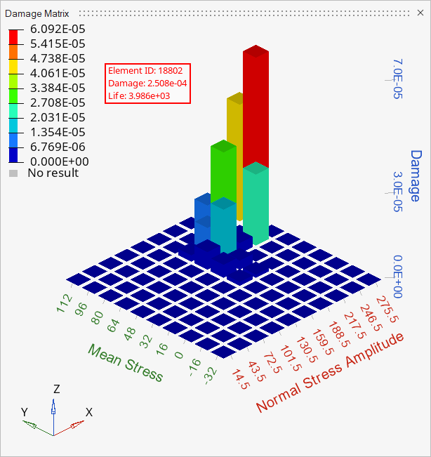

The contour below highlights the total damage (Event 1 + Event 2).
Figure 16.

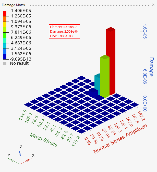

Figure 17. Event 1: Damage matrix for element 18802
Figure 18. Event 2: Damage matrix for element 18802
