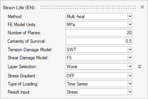

Define the EN configuration parameters.
- Select Multi Axial as the method.
- Select MPa for the FE model units.
- Enter a value of 20 for the number of planes.
- Enter a value of 0.5 for the certainty of survival.
- Select SWT for the tension damage model.
- Select FS for the shear damage model.
- Select Worst for the layer selection.
- Select Time Series for the type of loading.
Figure 4.
- Exit the dialog.

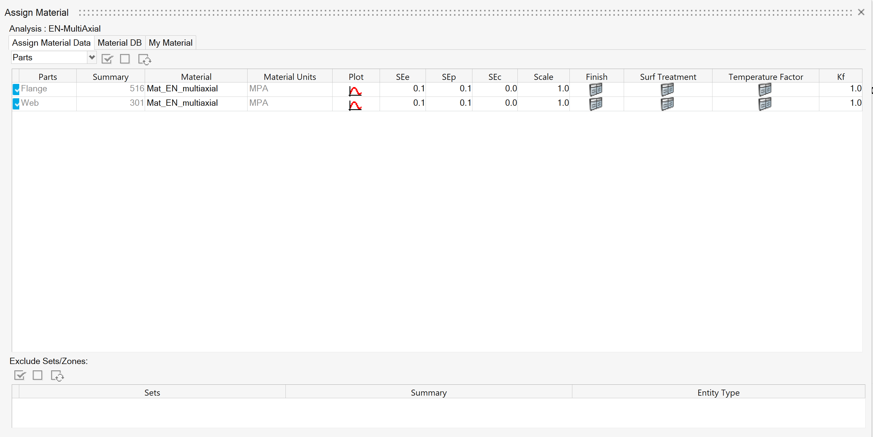

Assign Materials
Click the Material tool.
Figure 5.
The Assign Material dialog opens. - Activate the checkboxes next to the parts Flange and Web.

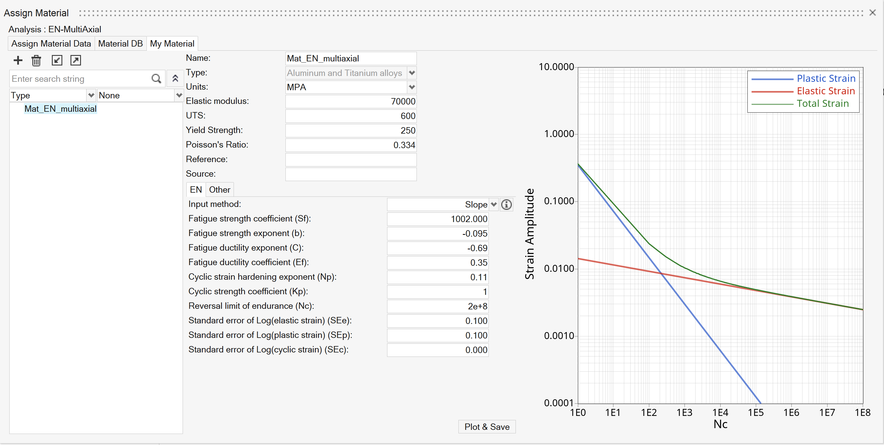

Create a new material.
- Right-click on Mat_EN_multiaxial and select Add to Assign Material List.
Return to the Assign Material Data tab and select
Mat_EN_multiaxial from the Material drop-down menu
for both Flange and Web.
The Material list is populated with the materials selected from Material Database and My Material.
Figure 7.
- Exit the dialog.

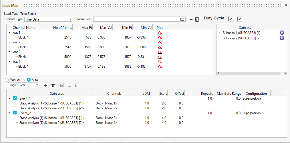

Assign Load Histories
Click the Load Map tool.
Figure 8.
The Load Map dialog opens. - From the Channel Type drop-down menu at the top of the dialog, select Time Data.
Click
in the Choose File
field and browse for load1.csv.
Click
to add the load case.
- Repeat steps 3 and 4 for load2.csv, load3.csv, and load4.csv.
- Optional:
Click
to view a plot of the loads.
Figure 9. Load 1
Figure 10. Load 2
Figure 11. Load 3
Figure 12. Load 4
Tip: Expand the width of the dialog to view a clearer picture of the plot. - On the bottom half of the dialog, set the radio button to Auto for event creation.
Select both the load 1 (block1) and load 2
(block1) channels and Subcase 1 and
Subcase 2, then click
to create the first event.
- In a similar manner, create a second event by selecting load 3 (block1), and load 4 (block1), Subcase 1, and Subcase 2.
- Activate the checkboxes for the two events.
Set the Scale as shown in the image below.
Figure 13.
- Exit the dialog.

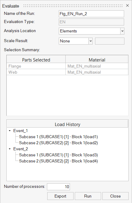

Evaluate and View Results
From the Evaluate tool group, click the
Run Analysis tool.
Figure 14.
The Evaluate dialog opens.Figure 15.
- Optional: Enter a name for the run.
Click Run.
Result files are saved to the home directory and the Run Status dialog opens.
- Once the run is complete, click View Current Results.

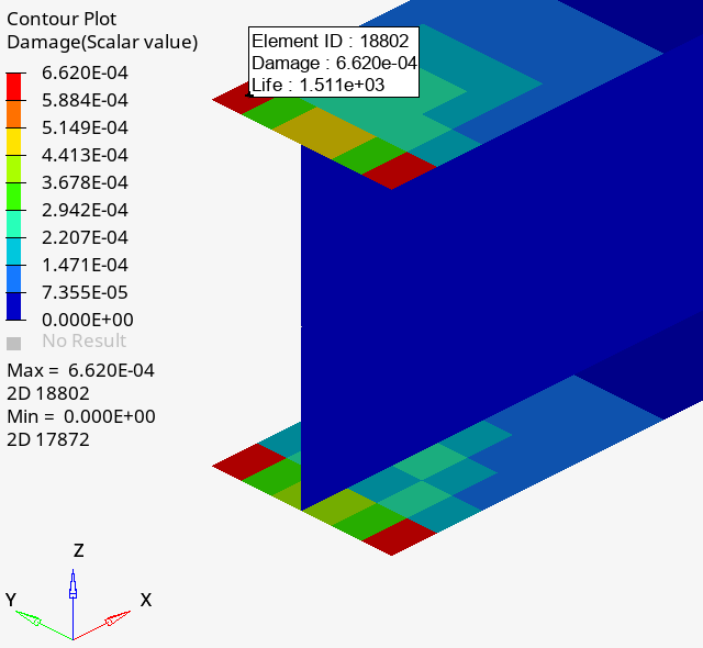

Use the Results Explorer to
visualize various types of results.

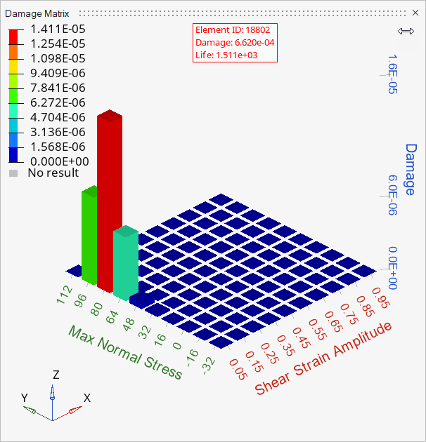

The contour below highlights the total damage (Event 1 + Event 2).
Figure 16.

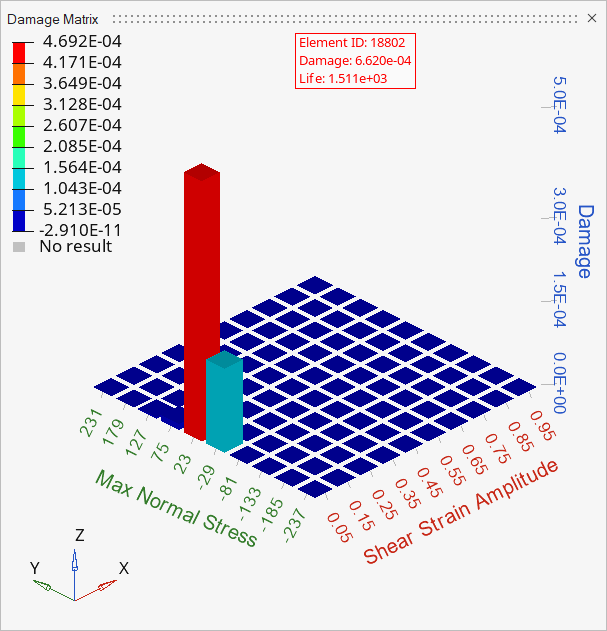

Figure 17. Event 1: Damage matrix for element 18802
Figure 18. Event 2: Damage matrix for element 18802
