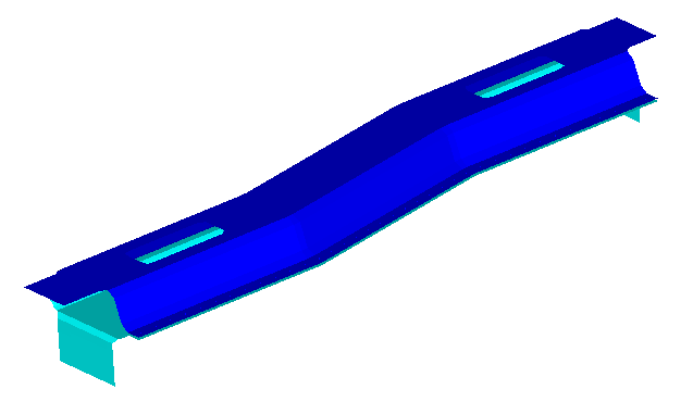

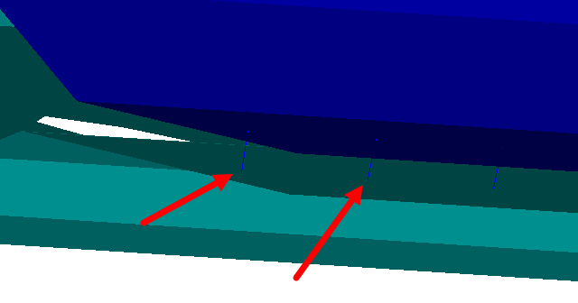

The spot welds are modelled with CBAR elements between the two plates.
Figure 3.

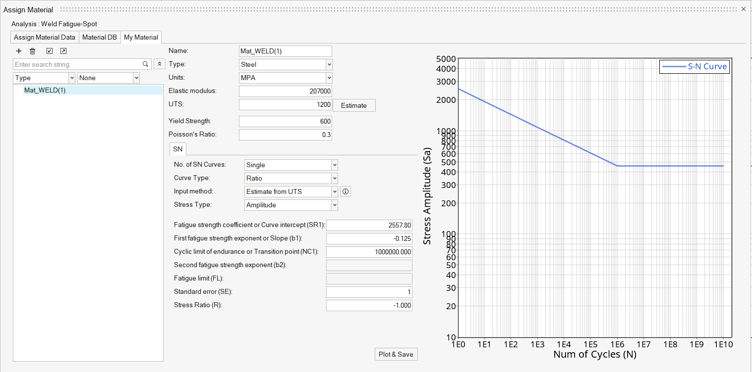

Click
A new material named Mat_WELD("n") is created. - Select Estimate from UTS as the input method.
- Select Steel as the type and enter a value of 1200 for UTS.
- Change the Yield Strength to 600.
- Click Estimate to obtain SN parameters.
- Enter a value of 1.0 for the Standard error (SE).
Click Plot & Save.
Figure 7.

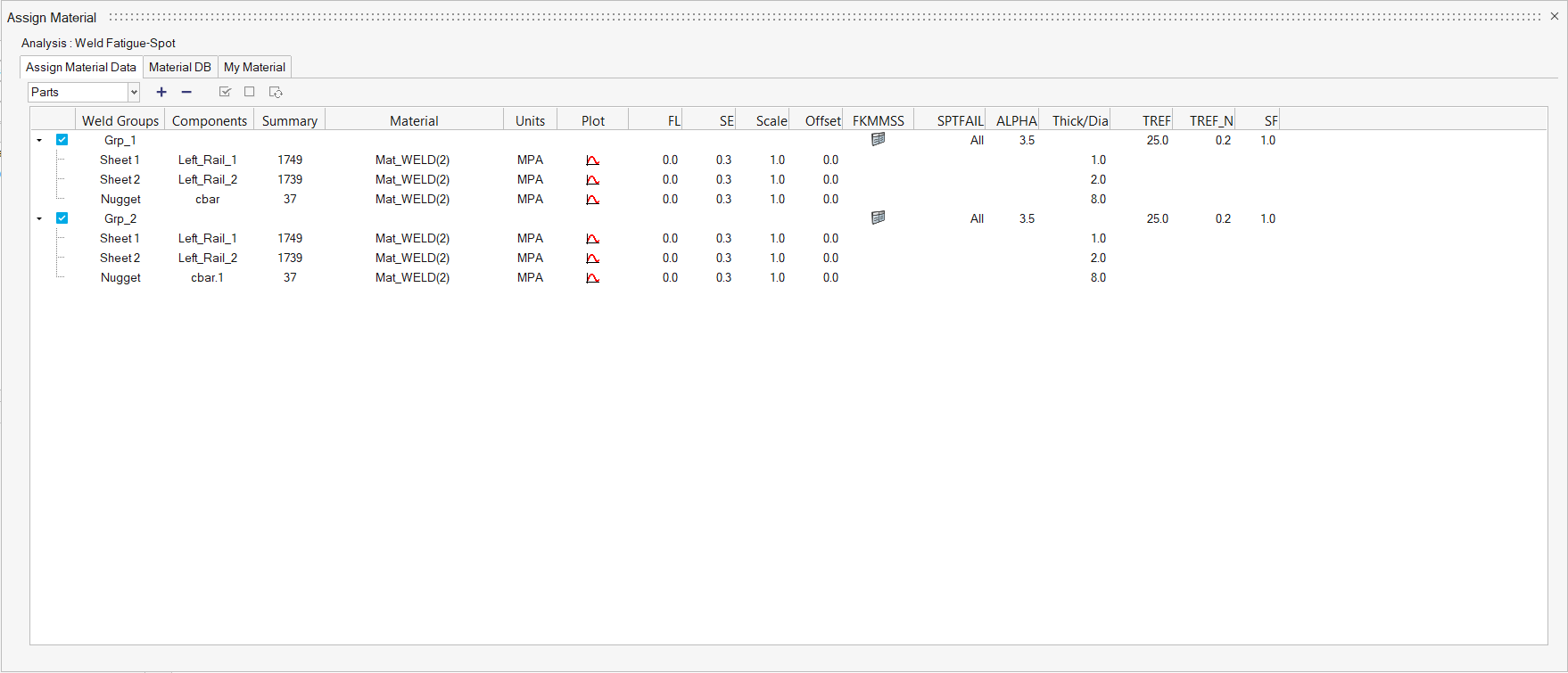

- Right-click on Mat_Weld("n") and select Add to Assign Material List.
- Return to the Assign Material Data tab.
- Select Mat_Weld("n") from the Material drop-down menu for every part.
- For both groups, enter a value of 2.0 for the Thickness/Diameter of Sheet 2.
For both groups, enter a value of 8.0 for the
Thickness/Diameter of Nugget.
Figure 8.
- Exit the dialog.

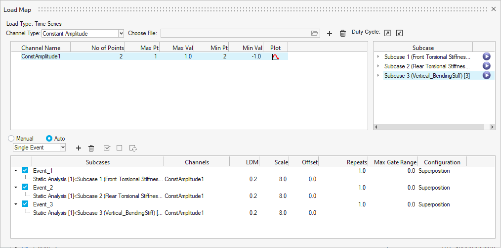

Assign Load Histories
Click the Load Map tool.
Figure 9.
The Load Map dialog opens. - From the Channel Type drop-down menu at the top of the dialog, select Constant Amplitude.
Click
to add the load case.
Tip: Click
to view a plot of the load.Figure 10.
On the bottom half of the dialog, set the radio button to
Auto for event creation and select Single
Event from the drop-down menu.
This option assists in automatically creating an event based on the subcase and channel selection.
Select both Subcase 1 and
ConsAmpEvent1 and click
next to Single Event.
An Event_1 header is created. -
Select Subcase 2 and
An Event_2 header is created. - In a similar manner, create an Event_3 header.
- Activate the checkboxes for all three events.
- Set LDM to 0.2, Scale to 8.0 and Offset to 0.0 for Subcase 1.
Right click on the Scale and LDM
fields for Subcase 1 and select Apply value to all
events.
Figure 11.
- Exit the dialog.

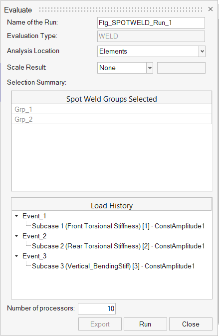

From the Evaluate tool group, click the
Run Analysis tool.
Figure 12.
The Evaluate dialog opens.Figure 13.
- Optional: Enter a name for the run.
Click Run.
Result files are saved to the home directory and the Run Status dialog opens.

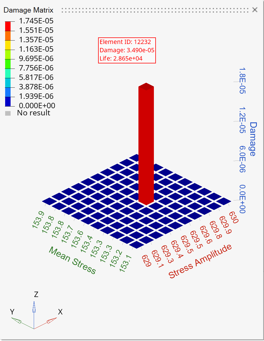

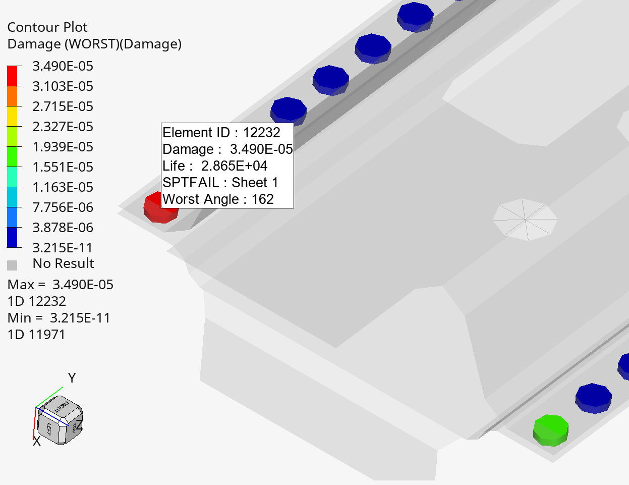

- Once the run is complete, click View Current Results.
Use the Results Explorer to
visualize various types of results.
Figure 14.
Figure 15.
The life of the critical spot weld is around 1.591e4 cycles.
