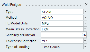

The Weld dialog opens. - Set the type to SEAM.
- Set the certainty of survival to 0.6.
Accept all other default parameters.
Figure 4.
- Exit the dialog.

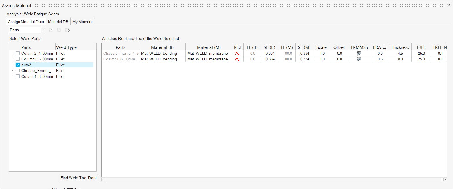

The Assign Material dialog opens. - Using the drop-down menu at the top, left of the dialog, change the components from Sets to Parts.
- In the Select Weld Parts window, activate the checkbox next to auto2.
Click Find Weld Toe, Root.
The adjacent attached components are displayed.

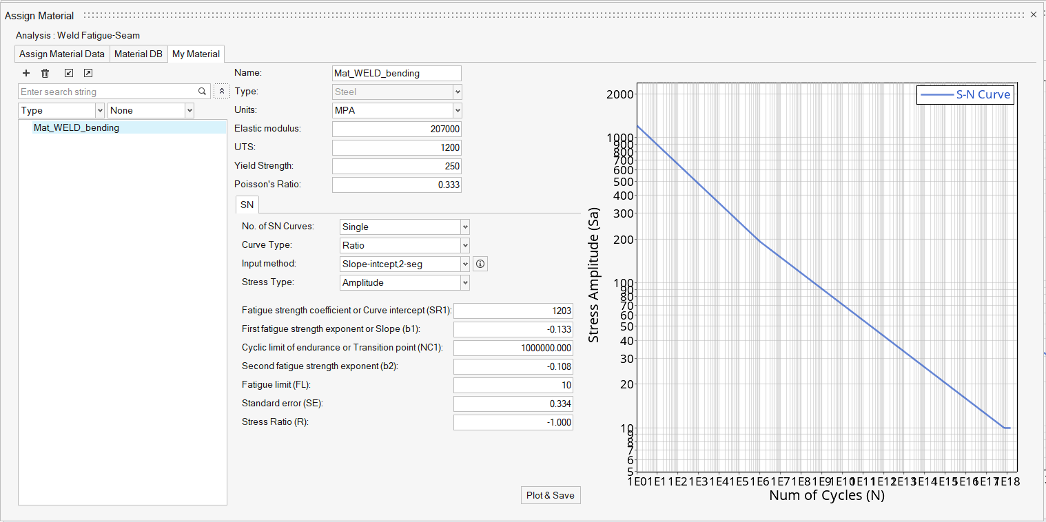

Create a bending material.
Create a membrane material.
- Right-click on both Mat_WELD_bending and Mat_WELD_membrane and select Add to Assign Material List.
- Return to the Assign Material Data tab.
Set Mat_WELD_bending as Material (B) and
Mat_WELD_membrane as Material (M) for both
components.
The Material list is populated with the materials selected from Material Database and My Material.Note: The Material Database contains default bending and membrane materials for seam weld analyses.
- Set BRATIO to 0.6 for both components.
Set TREF_N to 0.1 for both components.
Figure 8.
- Exit the dialog.

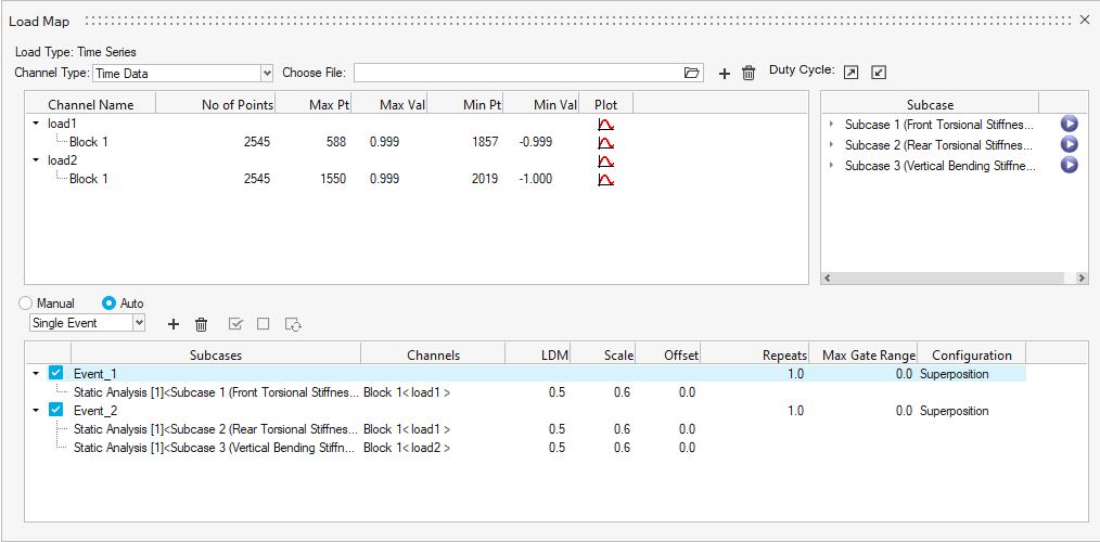

Click the Load Map tool.
Figure 9.
The Load Map dialog opens. - From the Channel Type drop-down menu at the top of the dialog, select Time Data.
Click
in the Choose File
field and browse for load1.csv.
Click
to add the load case.
- Repeat steps 3 and 4 for load2.csv.
- Optional:
Click
to view a plot of the loads.
Figure 10. Load 1
Figure 11. Load 2
Tip: Expand the width of the dialog to view a clearer picture of the plot. - On the bottom half of the dialog, set the radio button to Auto for event creation.
Select both the Block 1 channel under load1 and
Subcase 1, then click
to create the first event.
Next, select both Block 1 channels, Subcase
2, and Subcase 3 then click
A second event is created.Tip: Hold Control while left-clicking to select multiple options. - Activate the checkboxes for the two events.
- Set the LDM to 0.5 for Subcase 1.
Right-click on the LDM field and select Apply value to all
events.
Subcases 2 and 3 inherit the LDM value.
Similarly, set the Scale to 0.6 for all three
subcases.
Figure 12.
- Exit the dialog.

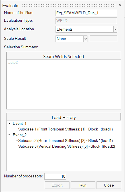

From the Evaluate tool group, click the
Run Analysis tool.
Figure 13.
The Evaluate dialog opens.Figure 14.
- Optional: Enter a name for the run.
Click Run.
Result files are saved to the home directory and the Run Status dialog opens.

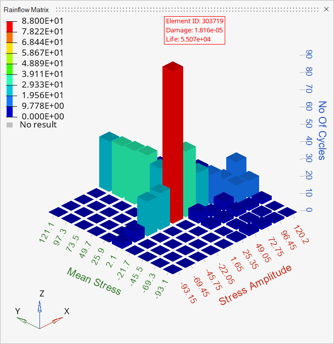

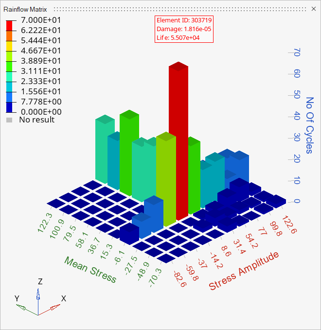

Use the Results Explorer to
visualize various types of results.
Figure 15.
Figure 16. Event 1: Rainflow matrix for element 303719
Figure 17. Event 2: Rainflow matrix for element 303719
