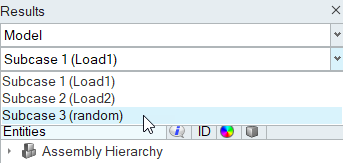

Check That the FE Result File Contains a Random Response Subcase with PSD Stresses
Both are needed to run this type of analysis.
From the Results Browser, click the second drop-down menu
and select Subcase 3 (random).
If the Results Browser is not open, click from the menu bar.

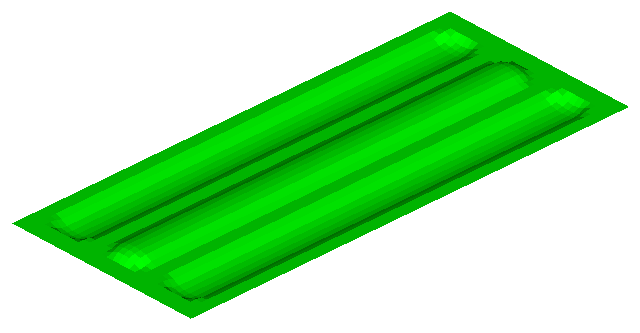

From the View Controls toolbar, click
The Contour panel opens. -
From the panel area, select PSD Element
Stresses (2D) (s) from the first Result type drop-down
menu.
Figure 4.
Click Apply.
The model is contoured.
- Observe the PSD element stress plot in the modeling window then select Clear Contour in the panel area.
- Exit the Contour panel.

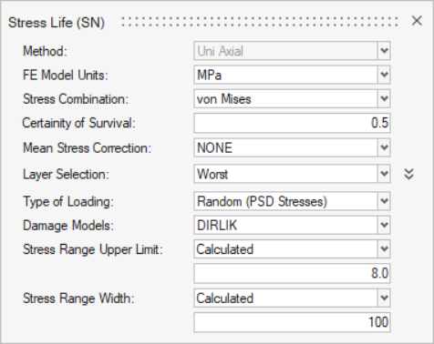

Define the Fatigue Module
Click the SN tool.
The SN tool should be the default fatigue module selected. If it is not, click the arrow next to the fatigue module icon to display a list of available options.
Figure 5.
The SN dialog opens. -
Define the SN configuration parameters.
Figure 6.
- Exit the dialog.

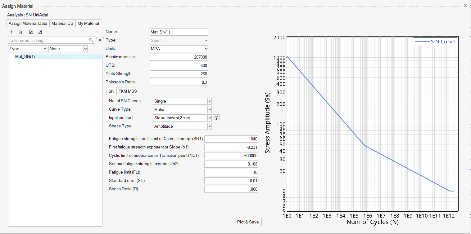

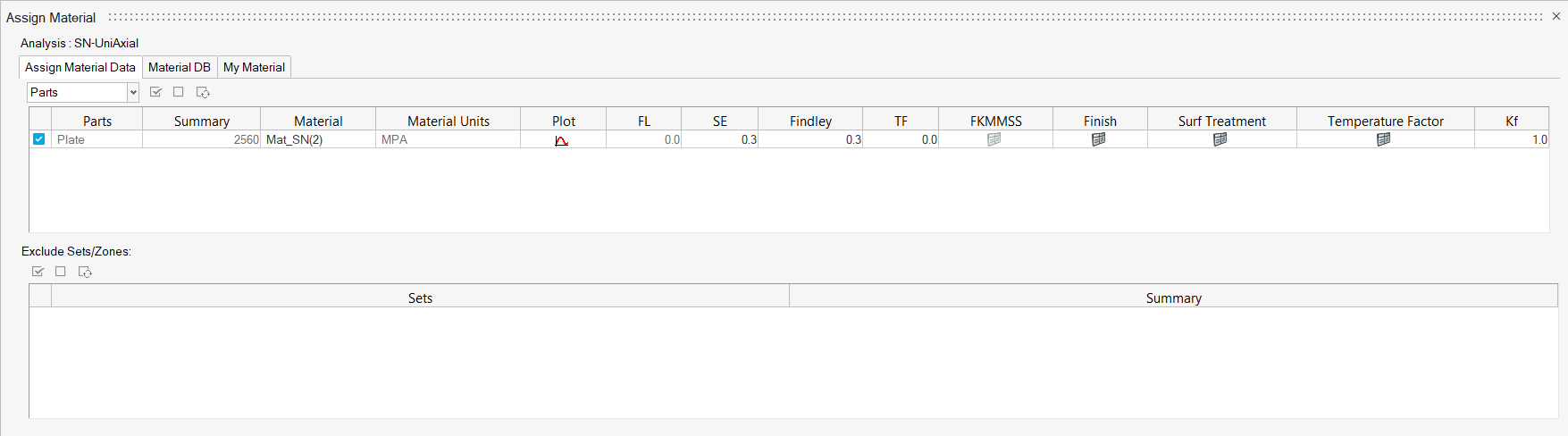

Assign Materials
Click the Material tool.
Figure 7.
The Assign Material dialog opens. - Activate the checkbox next to the part Plate.
Create a new material.
- Right-click on Mat_SN("n") and select Add to Assign Material List.
Return to the Assign Material Data tab and select
Mat_SN("n") from the Material drop-down menu for
Plate.
The Material list is populated with the materials selected from Material Database and My Material.
Figure 9.
- Exit the dialog.

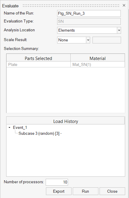

Evaluate and View Results
From the Evaluate tool group, click the
Run Analysis tool.
Figure 12.
The Evaluate dialog opens.Figure 13.
- Optional: Enter a name for the run.
Click Run.
Result files are saved to the home directory and the Run Status dialog opens.

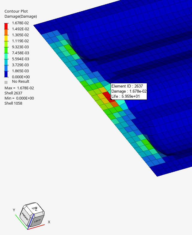

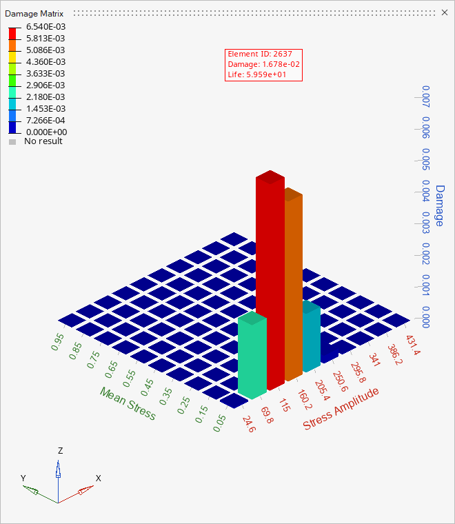

- Once the run is complete, click View Current Results.
Use the Results Explorer to
visualize various types of results.
Figure 14.
Figure 15.
