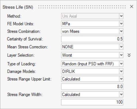

Define the Fatigue Module
Click the SN tool.
The SN tool should be the default fatigue module selected. If it is not, click the arrow next to the fatigue module icon to display a list of available options.
Figure 5.
The SN dialog opens. -
Define the SN configuration parameters.
Figure 6.
- Exit the dialog.

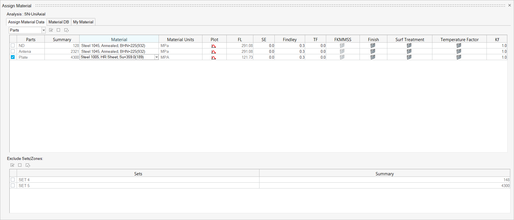

Assign Materials
Click the Material tool.
Figure 7.
The Assign Material dialog opens. - Activate the checkbox next to Plate.
Select a material.
- Click the Material DB tab.
- In the Search field, enter 189 and press Enter.
- From the search results, right-click Steel 1005, HR Sheet, Su = 359.0(189) and select Add to Assign Material List from the context menu.
Return to the Assign Material Data tab. Using the
Material drop-down menu, select Steel 1005, HR Sheet, Su =
359.0(189) for Plate.
The Material list is populated with the materials selected from Material Database and My Material.
Figure 8.
- Exit the dialog.

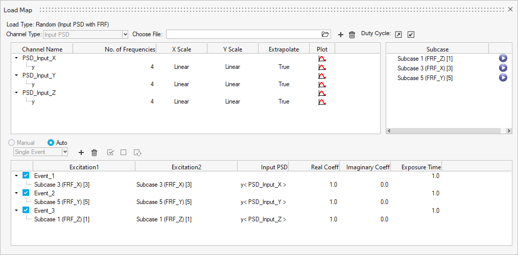

Create a Random Response Event
Click the Load Map tool.
Figure 9.
The Load Map dialog opens. - From the Channel Type drop-down menu at the top of the dialog, select Input PSD: Real & Imaginary.
Load PSD vs Frequency data (input PSD that is to scale the FRF stresses).
Click
in the Choose File
field and browse for psd_X.csv,
psd_Y.csv, and
psd_Z.csv.
Click
to add the load case.
Click
- Optional:
Click
to view a plot of the loads.
- Select Subcase 1 (Load_X), Subcase 2 (Load_Y), and Subcase 3 (Load_Z).
On the bottom half of the dialog, click
to create an Event_1
header.
The possible correlations of Subcase 1, Subcase 2, and Subcase 3 are listed under the event. -
Select the three psd files and drag-and-drop them into the
Event header.
Note: Any blank correlations are not considered in the calculation.The following pairs are created:
- Subcase 1 with psd_X
- Subcase 2 with psd_Y
- Subcase 3 with psd_Z
- Activate the Event_1 checkbox.
Set the Exposure Time for the event to 18000.
Figure 10.
- Exit the dialog.

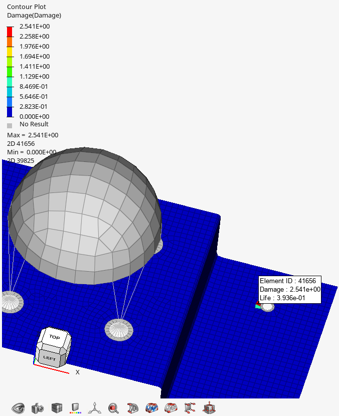

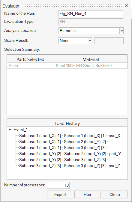

Evaluate and View Results
From the Evaluate tool group, click the
Run Analysis tool.
Figure 11.
The Evaluate dialog opens. - Optional:
Enter a name for the run.
Figure 12.
Click Run.
Result files are saved to the home directory and the Run Status dialog opens.

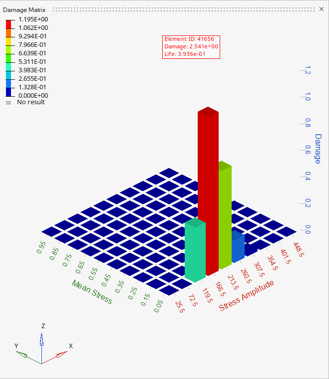

- Once the run is complete, click View Current Results.
Use the Results Explorer to
visualize various types of results.
Figure 13.
Figure 14.
