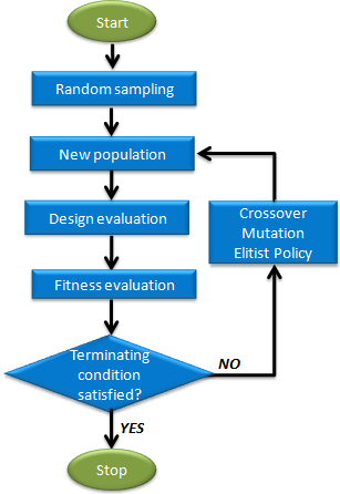

Genetic Algorithm (GA)
Modeled after the evolutionary process theory.
Genetic Algorithm starts with the creation of a population of designs (a generation). These designs are then ranked with respect to their fitness. Fitness is a measure of how good a design is and it is calculated as a function of constraint violation and objective function values. Selected designs are then reproduced through the application of genetic operators, typically crossover and mutation. The individuals that result from this process (the children) become members of the next generation. This process is repeated for many generations until the evolution of a population converges to the optimal solution.
