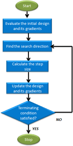

Method of Feasible Directions (MFD)
The fundamental principle behind the Method of Feasible Directions is to move from one feasible design to an improved feasible design, therefore, the objective function must be reduced and the constraints at the new design point should not be violated.
Used for solving constrained optimization problems.

- Method of Feasible Directions terminates if one of the conditions below are
met:
- One of the two convergence criterias are satisfied.
- Absolute convergence (Absolute Convergence)
- Relative convergence (Relative Convergence (%))
- The maximum number of allowable iterations (Number of Evaluations) is reached.
- An analysis fails and the “Terminate optimization” option is the default (On Failed Evaluation).
- The number of evaluations in each iteration is automatically set and varies due to the finite difference calculations used in the sensitivity calculation. The number of evaluations in each iteration is dependent of the number of variables and the Sensitivity setting. The evaluations required for the finite difference are executed in parallel. The evaluations required for the line search are executed sequentially.
