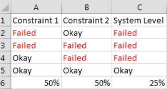

When there are multiple reliability constraints, it becomes important to account for the system reliability as a whole, rather than the reliability of individual constraints.
As an example, consider a design with two probabilistic constraints that are each individually 50% reliable. In Figure 1, the system is 25% reliable since the four runs do not include failures.
