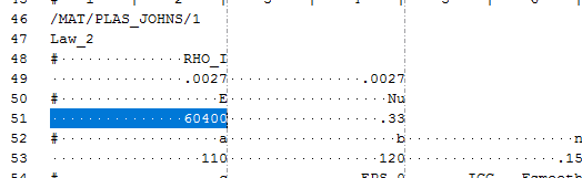

- In the File field, open the TENSILE_TEST_0000.rad file.
In the Find area, enter /MAT/PLAS_JOHNS/1 and click
HyperStudy highlights /MAT/PLAS_JOHNS/1.Figure 5.
Select variable E by highlighting the first 20 fields in row 51.

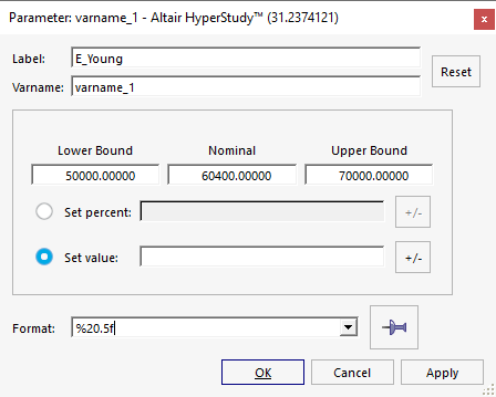

- Right-click on the highlighted fields and select Create Parameter from the context menu.
In the Parameter: varname_1 dialog, define the following
options and click OK.
- In the Label field, enter E_Young.
- Change the Lower Bound to 50000.
- Change the Nominal value to 60400.
- Change the Upper Bound to 70000.
- Change the Format to %20.5f.

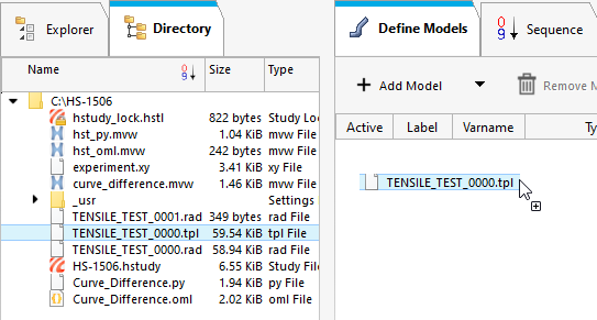

- Go to the Define Models step.
Add a Parameterized File model.

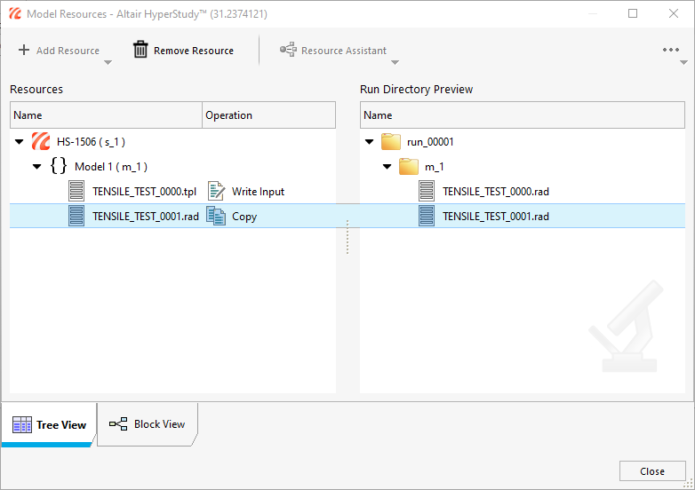

Define a model dependency.
- Click Model Resources.
- In the Model Resource dialog, select Model 1 (m_1).
- Click .
- In the Select File dialog, navigate to your working directory and open the TENSILE_TEST_0001.rad file.
- Set Operation to Copy.
- Click Close.

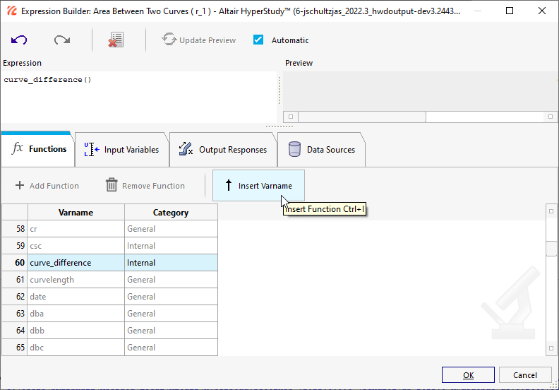

In this step, you will use the curve_difference function to create
and evaluate output responses.

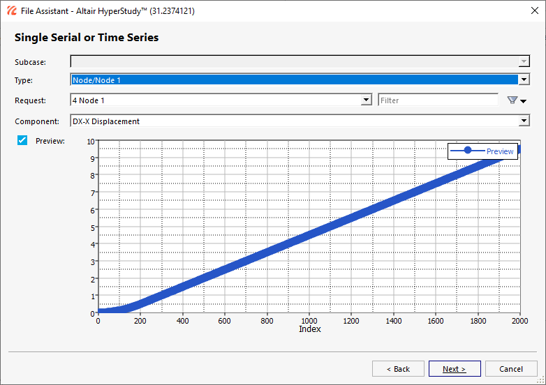

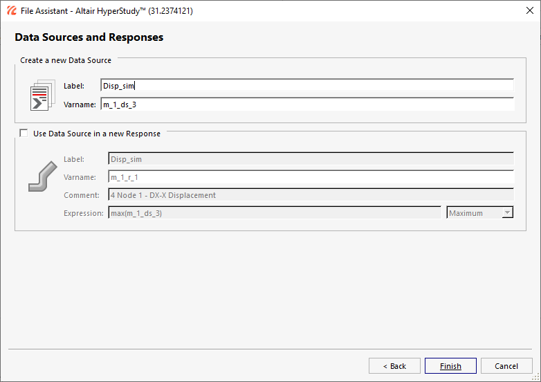

Create a data source labeled Disp_sim.
Create a second data source labeled Force_sim by
repeating step 2.
Define the following options:
- Set Type to Section/SECTION_2.
- Set Request to 2 section 1.
- Set Component to FT-Resultant Tangent Force.

Define the Area Between Two Curves output response.
- Click OK to close the Expression Builder.

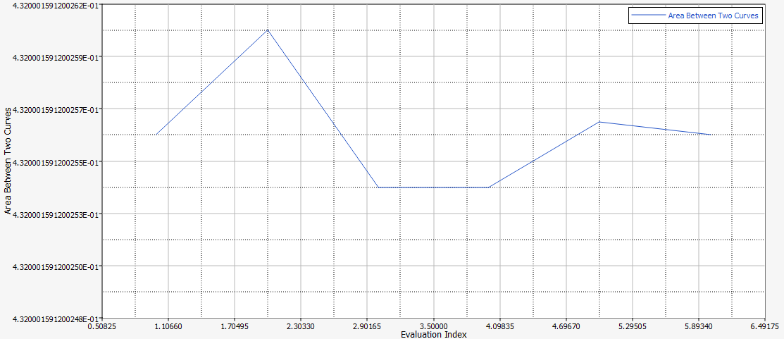

Click the Evaluation Plot tab to plot the optimization
iteration history of the objective.
Figure 16.
