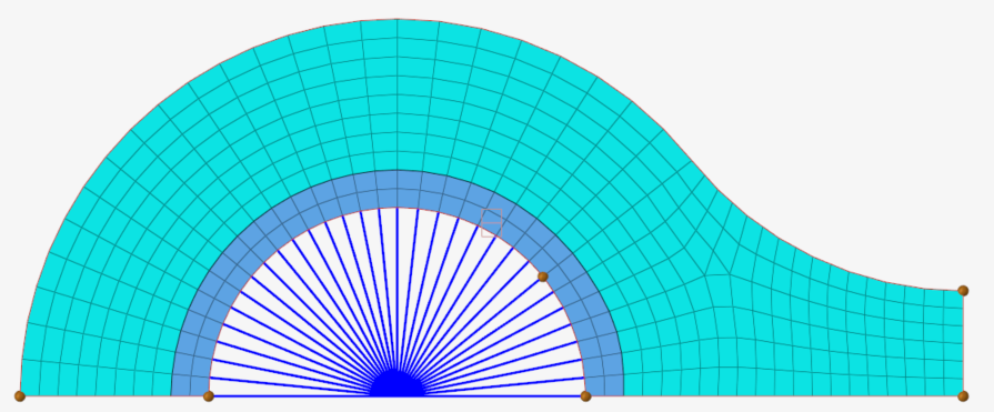

Perform Shape Parameterization in HyperMorph

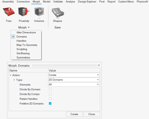

  1. Generate the domains and handles that you will use to manipulate the shape of the mesh and to generate shape perturbations for shape optimization.
    1. In the Morph section of the ribbon area, click Domains.
    2. Select Create, 2D Domains and All elements.
      Figure 3.
    3. Click Create.
      Figure 4.
  2. Click Close.

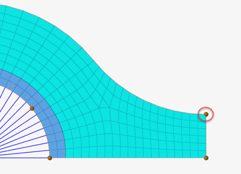

  3. Generate the shape.

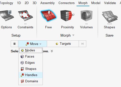

    1. In the Morph group, click Free.
    2. Click Move and select Handles.
      Figure 5.

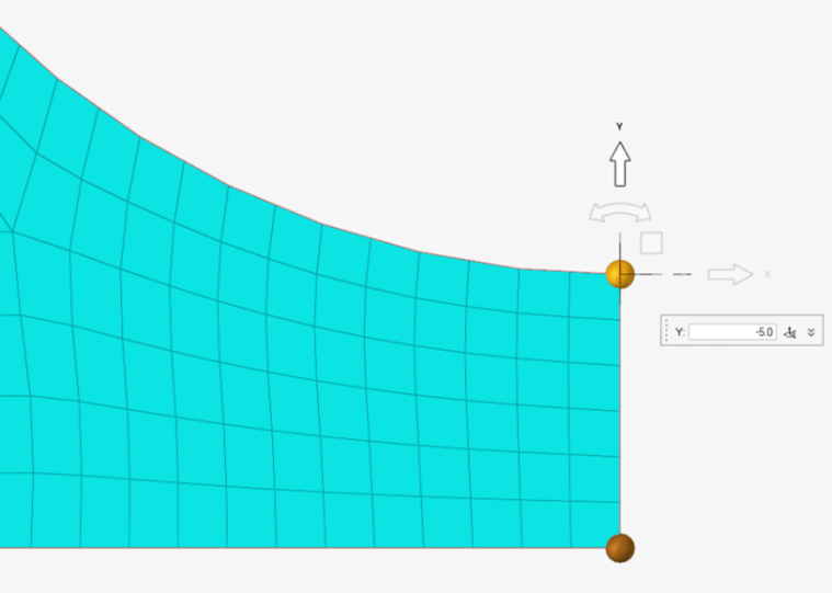

    3. In the modeling window, click the lower yellow handle located at the top right corner of the link.
      Figure 6.
    4. Click on the y axis, enter -5.0 in the field, and hit enter.
      The shape is generated.
    Figure 7.

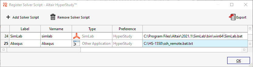

  2. From the menu bar, click Edit > Solver Script.
    The Register Solver Script dialog opens.

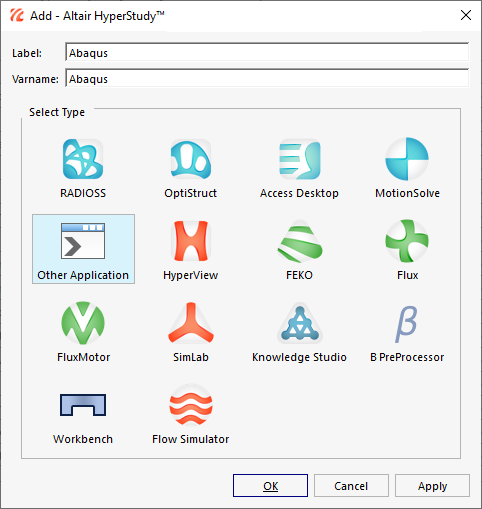

  3. Add solver script.
    1. Click Add Solver Script.
      The Add dialog opens.
    2. In the Label and Varname fields, enter Abaqus.
    3. From the list of solver script types, select Generic.
    4. Click OK.
    Figure 8.
  4. In the Path column of the script Abaqus, click .
  5. In the Open dialog, open the python.exe file.
    Tip: You can also copy and paste the same path and file from the Python Path field.
  6. In the User Arguments column of the Abaqus script, click .
  7. In the Open dialog, navigate to your working directory and open the HS-1550_solverScript.py file.
  8. Optional: ONLY for REMOTE Machines: Register Abaqus as a solver.
    Figure 9.
  9. Click OK.

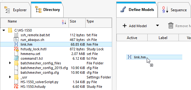

  4. Add a HyperMesh model.
    1. From the Directory, drag-and-drop the HyperMesh (.hm) file link.hm into the work area.
      Figure 10.
    2. In the Solver Input File column, enter link.inp.
      This is the name of the solver input file HyperStudy writes during any evaluation.
