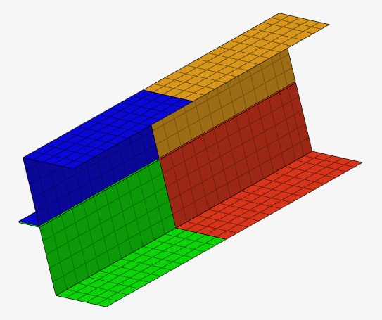

Open model.
- From the menu bar, click .
- In the Open Model dialog, open the boxbeam_morphed_noDV.hm file.
A model appears in the graphics area.Figure 1.

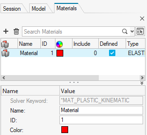

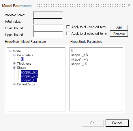

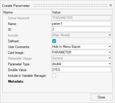

Create and assign parameter to Material.
- Save the HyperMesh model by clicking from the menu bar.

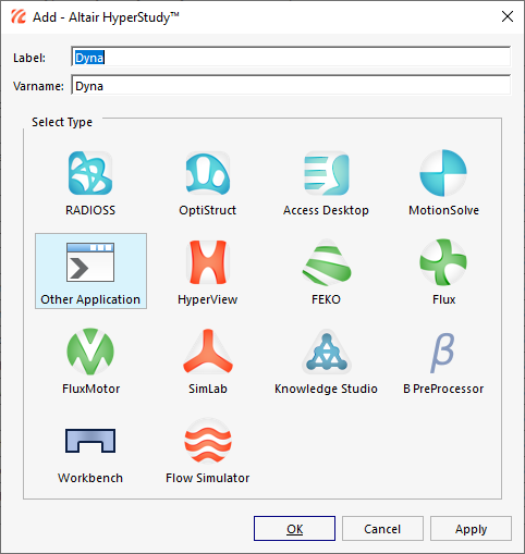

Perform the Study Setup
During this step, you will import the input variables that you created in HyperMesh.
Start a new study in the following ways:
- On the ribbon, click
- In the Add Study dialog, enter a study name, select a location for the study, and click OK.

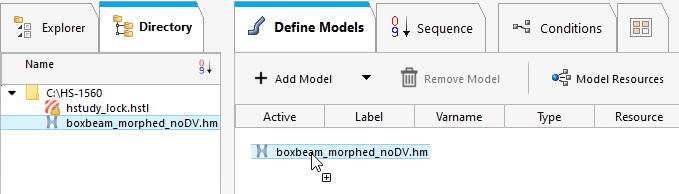

- Go to the Define Models step.
Add HyperMesh model.
Figure 7.

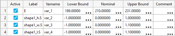

- Go to the Define Input Variables step.
Review the input variable's lower and upper bound ranges.
Figure 9.

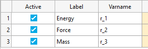

Create and Evaluate Output Responses
- Go to the Define Output Responses step.
Click Add Output Response three times to add three
output responses labeled Energy,
Force, and Mass.
Figure 10.
Define the output response, Energy.
Define the output response, Force.
Define the output response, Mass.
- Click Evaluate to extract the response values.
