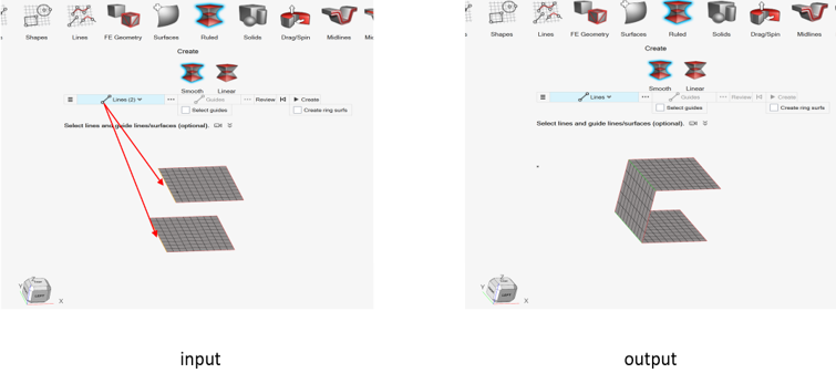

Creation Rules Applied in Tools and Workflows

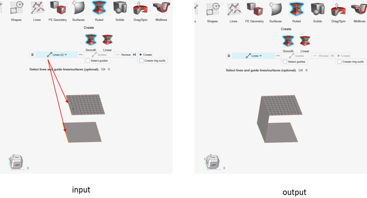

- For CAD geometry inputs, expected output is CAD geometry.Ruled surface creation from two CAD edges gives CAD geometry surface.
- For FE geometry inputs, expected output is FE geometry.Ruled surface creation from two FE geometry edges gives FE geometry surface.

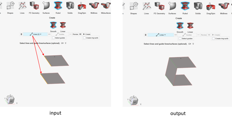

- For mixed inputs (CAD geometry + FE geometry), the expected output is defined by
the option in Preferences.The same is true for the following:
- Ruled surface creation from mixed selection (CAD edge and FE geometry edge)
- Connectivity within or across component
- Orphan nodes locations
- Structural nodes (not associated) selection
CAD edge/CAD line selection results in CAD surface.
FE edge/FE line selection results in FE surface.

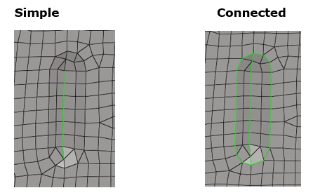

to define options.- Create at features
- Simple - Fast method of identifying features based solely on the angle between normals of adjacent elements. Based on this, the surface is created.
- Edge feature angle
- Feature angle based on angle between normals of adjacent element normals. Based on the settings, features are created on the surfaces.
- Vertex feature angle
- Maintain connectivity of the input surfaces to any attached surfaces.
- Allow open features
- Orphan feature edges can be created with this option, as shown in Figure 5 by the Simple example.
