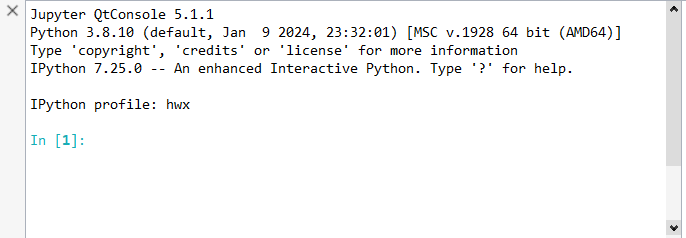

Launch the Python Console in MotionView
  1. Launch a new MotionView session.
  2. Click View > Python Window.
    The Python Console window is launched.

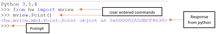

    1.
Python Console Conventions
2.
