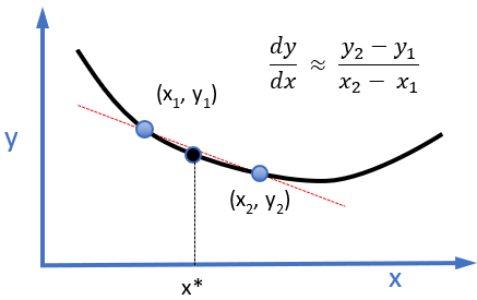

A finite differencing scheme is used to compute the slope. Two values of the signal, one on either side of the point of interest are used as shown in the figure below.
Example
Figure 1. Finite differencing to evaluate the slope of a curve
