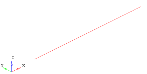

- graph = "1" implies that this element will be represented as a line drawn between the two connecting nodes.

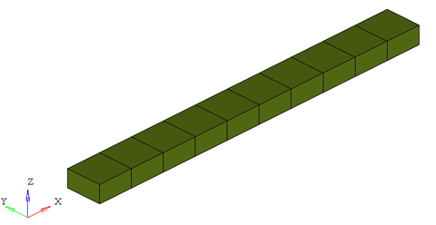

Figure 1. The representation of a beam with graph = 1.

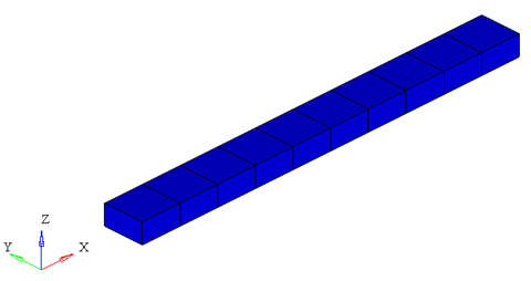

Note: When using graph="0" or graph="1", you will not be able to visualize the stress, strain or displacement contours. To do this, use graph="2" or graph="3".- graph = "2" implies that the beam will be represented by 3D solid elements. This mode is useful when trying to visualize the stress/strain and displacement contours.
Figure 2. The representation of a beam with graph = 2. The beam is represented by 3D elements

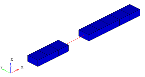

- graph = "3" implies that the beam is represented both as 3D solid elements as well as a line connecting the two nodes of the beam. This is useful when you need to visualize both the center line and the 3D representation of the beam.
Figure 3. The representation of a beam with graph = 3. The 3d elements in the middle of the beam are turned off to show the center line of the beam

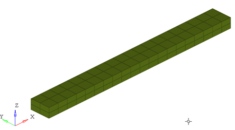

Figure 5.
ngx = ngy = ngz = 2

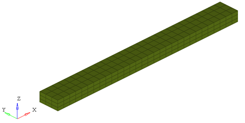

Figure 6.
ngx = ngy = ngz = 3
While increasing the ngx, ngy and ngz results in a better representation of the beam, it also increases the post-processing time taken by MotionSolve to write out the H3D. In addition, large values of ngx, ngy or ngz will increase the file size of the H3D considerably. Consider using the minimum values of these attributes that satisfy your visualization needs.
