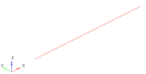

- graph = "0" implies that this element will not be represented in the H3D
- graph = "1" implies that this element will be represented as a line drawn between the two connecting nodes.
Figure 1. The representation of a beam with graph = 1.

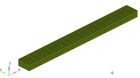

the beam will be represented by 3D solid elements. This
mode is useful when trying to visualize the stress/strain
and displacement contours.
Figure 2. The representation of a beam with graph = 2. The beam is represented by 3D elements

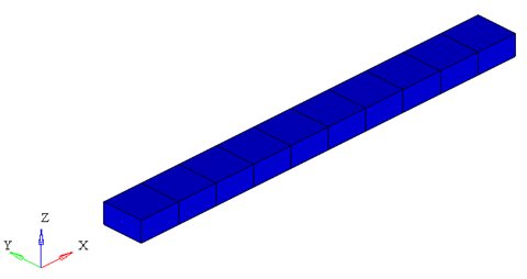

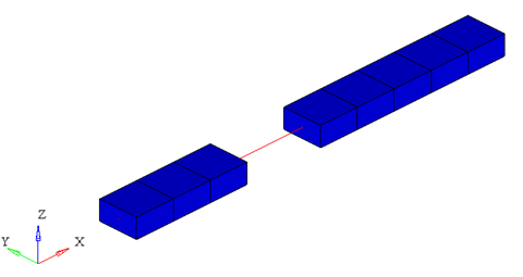

- graph = "3" implies that the beam is represented both as 3D solid elements as well as a line connecting the two nodes of the beam. This is useful when you need to visualize both the center line and the 3D representation of the beam.
Figure 3. The representation of a beam with graph = 3. The 3D elements in the middle of the beam are turned off to show the center line of the beam

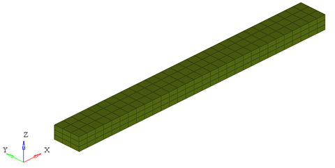

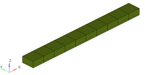

When representing the beam as a solid, the arguments ngx, ngy and ngz determine the number of elements that are used to represent the beam in the animation H3D.
Figure 4. Effect of ngx, ngy and ngz on the 3D representation of a simple beam
ngx = ngy = ngz = 1
Figure 5.
ngx = ngy = ngz = 2
Figure 6.
ngx = ngy = ngz = 3
While increasing the ngx, ngy and ngz results in a better representation of the beam, it also increases the post-processing time taken by MotionSolve to write out the H3D. In addition, large values of ngx, ngy and ngz will increase the file size of the H3D considerably. Consider using the minimum values of these attributes that satisfy your visualization needs.
