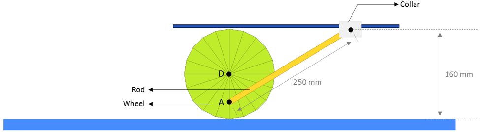

Problem 10: Kinematic Analysis of a Rolling Wheel
Objective
The 80 mm radius wheel shown rolls to the left with a velocity of 900 mm/s. Knowing that the distance AD is 50 mm, determine the velocity of the collar when the wheel has rolled by 90ᵒ CCW from the position shown below.

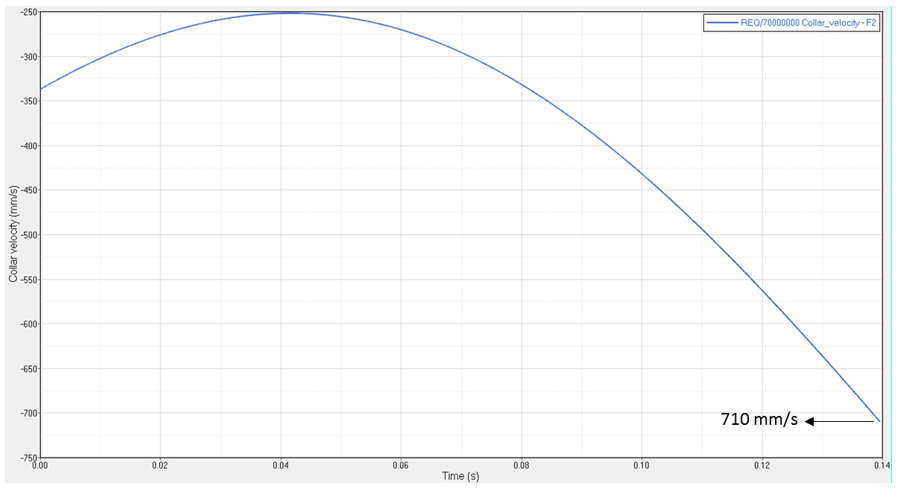

Graphical Results
Result Comparison
| Output | Analytical | MotionSolve | % Error |
| Collar velocity (mm/s) | 710 | 710 | 0 % |
Conclusion
MotionSolve results compare well with analytical results.
