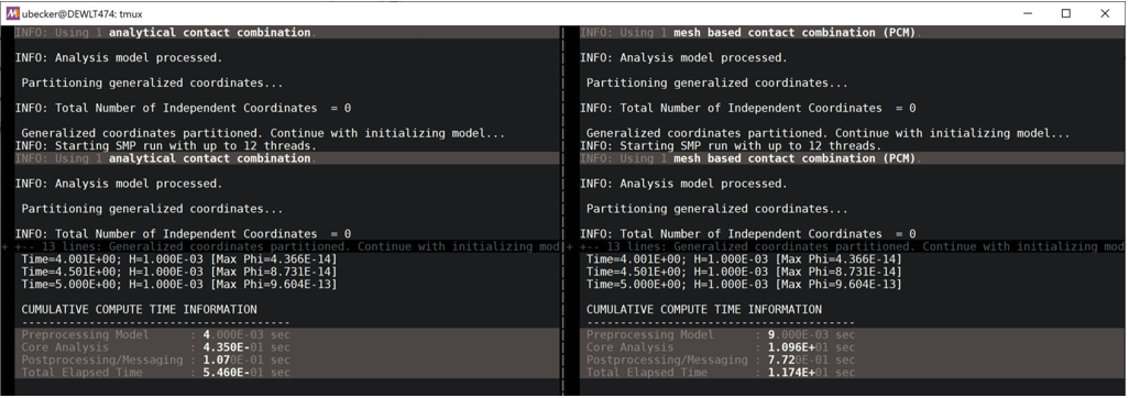

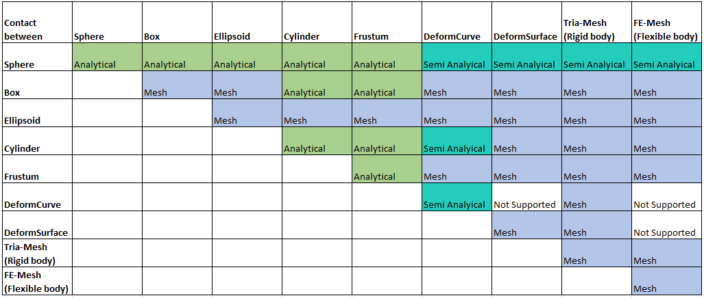

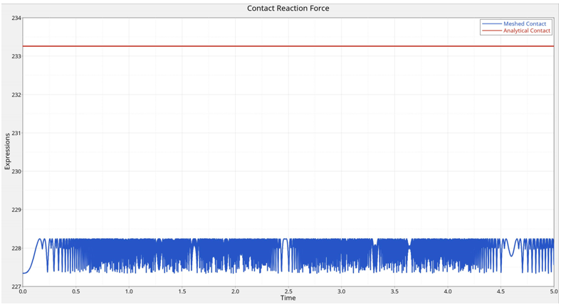

enable_analytical
Specifies whether MotionSolve should use an analytical description, where possible. Select TRUE or FALSE.
The default is FALSE.
See Comment 1 for more details on usage.

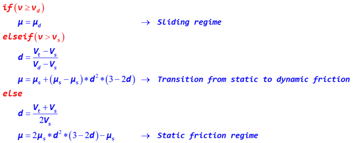

mu_static
Defines the coefficient of static friction when the friction is in the static regime.
MotionSolve uses a step function to transition between the static and dynamic friction regimes.
mu_static > 0
See Comment 7 for more details.
mu_dynamic
Defines the coefficient of dynamic friction when the friction is in the dynamic regime.
MotionSolve uses a step function to transition between the static and dynamic friction regimes. The coefficient of dynamic friction must be smaller than or equal to the coefficient of static friction.
mu_static ≥ mu_dynamic > 0
stiction_trans_vel
The velocity at which the friction regime transitions to stiction.
friction_trans_vel
The velocity at which the friction regime transitions to friction.
|friction_trans_vel| ≥ |stiction_trans_vel|

The problem is solved using 3D analytical contact as well as mesh-to-mesh contact. The contact forces are shown in the plot below.
Figure 3. Contact forces at the box-cylinder interface – Analytical contact (Red) vs. Mesh-to-mesh contact (Blue)
The analytical contact reports a constant force as expected. The mesh-to-mesh contact representation, in contrast, reports a lower force. Moreover, as triangles move in and out of contact, in mesh-to-mesh contact, the force changes to reflect this. The variation in the force can be decreased by using finer tessellations, however this would increase the cost of the simulation.
The image below compares the performance of the analytical contact against the mesh-to-mesh contact. The analytical contact (left) is about 21x faster than the mesh-to-mesh contact (right) for this simple model.
Figure 4. Analytical contact vs. Mesh-to-mesh contact – A performance comparison

    Many geometric combinations are possible for 3D contact. When enable_analytical is set to “TRUE”, MotionSolve uses analytical representations for rigid bodies to compute accurate, fast, and smooth contact forces. When this is not possible, MotionSolve uses a general 3D mesh-to-mesh-contact.
    Support for the different combinations is shown in the table below.
    Figure 5. Table 1: Contact kinematics calculation methods for supported geometries
    In the above table, the entries in each cell have the following meaning:
    Analytical
    Each of the contacting geometries is represented by an analytical expression. Contact between the geometries is determined analytically. Contact point locations and normal are computed without using any tessellation representations. Curved geometries are represented exactly.
    Semi
    One of the geometries is represented analytically. In other words, it is not tessellated. However, the other contacting geometry is tessellated and represented as a mesh. The accuracy is dependent on the accuracy of the tessellation.
    Mesh
    Both geometries are tessellated. A general mesh-to-mesh contact detection method is used. Contact accuracy is dependent on the accuracy of the mesh. The contact detection speed is inversely dependent on the mesh density. In other words, it will take more time to compute the contact kinematics between fine meshes.

  7. Two friction models are supported in MotionSolve
    • Coulomb model of friction which calculates the friction force as the normal force multiplied by the coefficient of friction. This coefficient is calculated as a function of the slip velocity that is explained below
    • A user defined friction force model that can be implemented as a subroutine or a script
      For the first approach, the friction force at the contact patch is computed in the same manner for POISSON, IMPACT and VOLUME force models. The Coulomb friction law is used which models the friction force as a coefficient of friction multiplied by the normal force. The coefficient of friction is modeled as a function of the slip velocity. The frictional force is modeled as a viscous force according to the following equations:
    where,
    V t MathType@MTEF@5@5@+= feaagKart1ev2aqatCvAUfeBSjuyZL2yd9gzLbvyNv2Caerbd9MBZ9 gBHnharuavP1wzZbItLDhis9wBH5garmWu51MyVXgaruWqVvNCPvMC G4uz3bqee0evGueE0jxyaibaieYlf9irVeeu0dXdh9vqqj=hEeeu0x Xdbba9frFj0=OqFfea0dXdd9vqaq=JfrVkFHe9pgea0dXdar=Jb9hs 0dXdbPYxe9vr0=vr0=vqpWqadiaabmqadmaadaGabiaaeaGaauaaaO qaaabbaaaaaG+acXwDLbWdbiaadAfadaWgaaWcbaGaamiDaaqabaaa aa@3DF2@
    is the current slip speed at the point of contact
    V s MathType@MTEF@5@5@+= feaagKart1ev2aqatCvAUfeBSjuyZL2yd9gzLbvyNv2CaerbuLwBLn hiov2DGi1BTfMBaeXatLxBI9gBaerbd9wDYLwzYbItLDharqqtubsr 4rNCHbGeaGqiVu0Je9sqqrpepC0xbbL8F4rqqrFfpeea0xe9Lq=Jc9 vqaqpepm0xbba9pwe9Q8fs0=yqaqpepae9pg0FirpepeKkFr0xfr=x fr=xb9adbaqaaeGaciGaaiaabeqaamaabaabaaGcbaGaamOvamaaBa aaleaacaWGZbaabeaaaaa@37F6@
    is the stiction transition slip speed at which the full value of μ s MathType@MTEF@5@5@+= feaagKart1ev2aqatCvAUfeBSjuyZL2yd9gzLbvyNv2CaerbuLwBLn hiov2DGi1BTfMBaeXatLxBI9gBaerbd9wDYLwzYbItLDharqqtubsr 4rNCHbGeaGqiVu0Je9sqqrpepC0xbbL8F4rqqrFfpeea0xe9Lq=Jc9 vqaqpepm0xbba9pwe9Q8fs0=yqaqpepae9pg0FirpepeKkFr0xfr=x fr=xb9adbaqaaeGaciGaaiaabeqaamaabaabaaGcbaGaeqiVd02aaS baaSqaaiaadohaaeqaaaaa@38D1@ is used for the coefficient of friction
    V d MathType@MTEF@5@5@+= feaagKart1ev2aqatCvAUfeBSjuyZL2yd9gzLbvyNv2CaerbuLwBLn hiov2DGi1BTfMBaeXatLxBI9gBaerbd9wDYLwzYbItLDharqqtubsr 4rNCHbGeaGqiVu0Je9sqqrpepC0xbbL8F4rqqrFfpeea0xe9Lq=Jc9 vqaqpepm0xbba9pwe9Q8fs0=yqaqpepae9pg0FirpepeKkFr0xfr=x fr=xb9adbaqaaeGaciGaaiaabeqaamaabaabaaGcbaGaamOvamaaBa aaleaacaWGKbaabeaaaaa@37E7@
    is the dynamic friction slip speed at which the full value of μ d MathType@MTEF@5@5@+= feaagKart1ev2aqatCvAUfeBSjuyZL2yd9gzLbvyNv2CaerbuLwBLn hiov2DGi1BTfMBaeXatLxBI9gBaerbd9wDYLwzYbItLDharqqtubsr 4rNCHbGeaGqiVu0Je9sqqrpepC0xbbL8F4rqqrFfpeea0xe9Lq=Jc9 vqaqpepm0xbba9pwe9Q8fs0=yqaqpepae9pg0FirpepeKkFr0xfr=x fr=xb9adbaqaaeGaciGaaiaabeqaamaabaabaaGcbaGaeqiVd02aaS baaSqaaiaadsgaaeqaaaaa@38C2@ is used for the coefficient of friction
    is the coefficient of static friction
    is the coefficient of dynamic friction
    Figure 9 illustrates the functional relation between coefficient of friction and slip velocity
    The blue curve depicts the full friction model covering all three regimes: static, transition to sliding friction, and sliding friction. This is the friction model applied when you select cff_type = "COULOMB_ON".
    • The static regime shown in light blue.
    • The transition from static to dynamic friction show in white.
    • The dynamic friction regime shown in light orange.
    The red curve depicts the friction model covering only the sliding friction regime. This is the friction model applied when you select cff_type = "DYNAMICS_ONLY".
    Figure 9. Coefficient of friction as a function of slip velocity
  8. μ is the friction coefficient that is to be applied. As shown in table 3, it is a function of the slip velocity and dependent on the static and dynamic friction coefficients. The friction force opposes the direction of the slip velocity. The table below lists the static and dynamic friction coefficients for some common material pairs. The friction values are extremely sensitive to surface coatings, so both dry and greasy values are specified.
