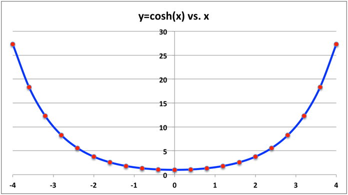

Assume a bead, modeled as a particle, is sliding on a catenary fixed in the global x-y plane as shown in Figure 1. The path of the bead is shown as a red circle, and the catenary as a blue line.
Figure 1. A Bead Sliding on a Catenary
The constraint is represented as: g(x,y) = y - cosh(x) = 0.
The time derivative of the constraint is: g(ẋ,ẏ,x,y) = ẏ - sinh(x)ẋ = 0.
Let MARKER 9 represent the center of mass of the bead. Assume a penalty of 1E4 is used to enforce the constraint, and a penalty of 1E2 to enforce the time derivative of the constraint. The MotionSolve Force_Penalty statement is:
<Force_Penalty
     id       = "1"
     label    = "Particle sliding on a catenary"
     type     = "EXPRESSION"
     expr     = "dy(9) - cosh(dx(9))"
     penalty  = "1E4"
     penalty1 ="1E2"
The displacement constraint for the penalty force is:
g = dy(9)-cosh(dx(9))
The velocity constraint for the penalty force is:
ġ= vy(9)-sinh(dx(9)*vx(9)
The penalty force that is computed by MotionSolve is:
F = -1E4*g - 1E2*ġ
  = -1E4*[dy(9)-cosh(dx(9)] -1E2*[vy(9)-sinh(dx(9))*vx(9)]
The generalized force that is computed by MotionSolve along global-X and global-Y is:

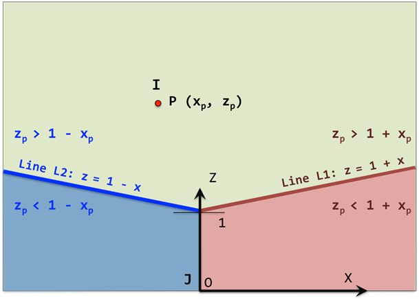

Example 3
This example demonstrates how a simple unilateral constraint can be implemented with Force_Penalty. Figure 3 shows a line L, y=1+x, defined in the coordinate system of a Marker, J.
Figure 3. A Particle P Bouncing Between Two Lines L1: z=1+x and L2: z=1-x
J has origin O, x-axis along X and Z-axis along Z. A point P, belonging to another body, has coordinates (xp,zp) as measured in J. For the sake of convenience, define a Marker I=10, whose origin is at P. The constraint, which we wish to impose, is that as the point P moves, it must not penetrate the material under either L1 or L2. The objectives of this example are:
  • Define the inequality constraints that captures this requirement.
  • Define two Force_Penalty to enforce these constraints.
From simple coordinate geometry considerations, we can see that:
  • The green region, of permissible motion above L1, is represented by: zp > 1 + xp
  • The red region, of impermissible motion below L1, is represented by: zp < 1 + xp
  • The boundary between these regions is represented by line L1: zp = 1 + xp
Similarly, we deduce that:
  • The green region, of permissible motion above L2, is represented by: zp > 1 - xp
  • The blue region, of impermissible motion below L2, is represented by: zp < 1 - xp
  • The boundary between these regions is represented by line L2: zp = 1 - xp
The constraints we wish to impose are:
  • zp ≥ 1 + xpor1 + xp - zp ≤ 0
  • zp ≥ 1 - xpor1 - xp - zp ≤ 0
The Force_Penalty definitions are therefore:
<Force_Penalty                            |<Force_Penalty
   id               = "1"                 |      id               = "2"
   label            = "Enforce 1+x<=z"    |      label            = "Enforce 1-x<=z"
   type             = "EXPRESSION"        |      type             = "EXPRESSION"
   expr             = "1+dx(10)-dz(10)"   |      expr             = "1-dx(10)-dz(10)"
   penalty          = "1E4"               |      penalty          = "1E4"
   penalty1         = "1E2"               |      penalty1         = "1E2"
   unilateral       = "True"              |      unilateral       = "True"
   smoothing_factor = "1.0"               |      smoothing_factor = "1.0"
Figure 4 below shows the X and Z coordinates of particle P (Marker 10), when it starts from an initial condition of Xp=100 mm and Zp=120 mm and falls under the influence of gravity. The acceleration due to gravity is -9810 mm/s2 in the Z direction.
The particle bounces between the two lines and eventually comes to rest at Zp=1 and Xp=0.
