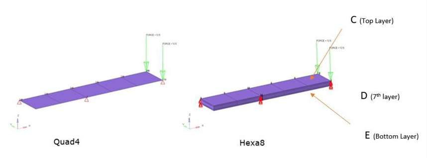

Benchmark Model
Quad4 and Hexa8 elements are used to create one quarter model of the laminated strip simply supported at A. For Quad4 elements Ply laminates are created and for Hexa8 elements the PSOLID property is used. A line load of 10 N/mm is applied at C.
