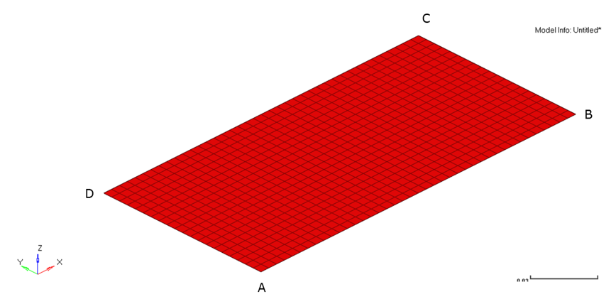

Figure 1. Composite Laminate Shell Subjected to Uniform Constant Temperature
Table 2 lists out all the computed ply failure indices from OptiStruct (OS) based on Tsai-Wu, Hill and Hoffman failure criteria. 800 mesh elements of CQUAD4 element type were used in this study. The model is pinned at point A using a SPC card and a uniform thermal load of 150 °C is applied throughout the domain using a TEMP card.
