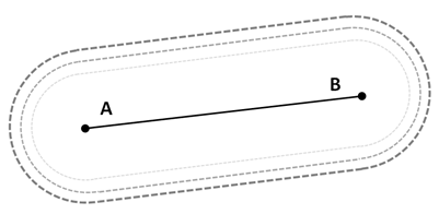

Block Format Keyword Enable explosive material ignition from a detonation line [A,B].

- It is possible to define multiple detonation lines.
- If a detonation time is not defined, /MAT/LAW5 (JWL) material law will instantaneously detonate.
- Detonation times are available in the Starter output file (IPRI ≥ 3).
- Burn fractions are available in time history file with /TH/BRIC card and BFRAC keyword.
- Detonation velocity is taken from /MAT/LAW5 (JWL) material law.
- If A=B, then detonation wave is spherical.
- It is possible to manually set coordinates, instead of providing node_ID with /DFS/DETLINE/.
- node_ID1 and node_ID2 are mandatory.
