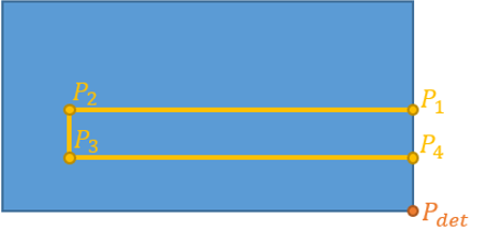

- Node path must be provided in the correct order through an unsortable node group identifier (/GRNOD/NODENS). It defines the screen lines.

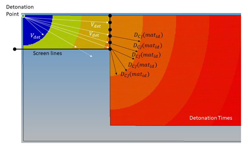

- From an algorithm point of view, all points from the screen lines are considered
as a potential detonation origin. The shortest detonation time is retained within all
sources which have a direct path (if path from a potential source crosses any screen line
then this source is ignored).
Figure 2. Screen Lines are defined into an ordered group of nodes

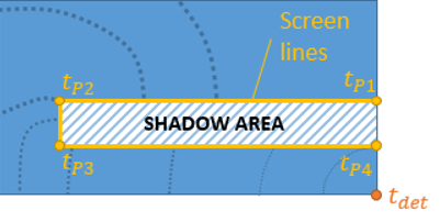

Detonation times are computed for each screen point by calculating the length of the path starting from detonation point.Figure 3.

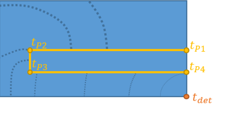

Screen points are considered as a potential detonation source (spherical). An arrival time is computed from each screen point, unless the direct path to the target point is intersected by a screen line.Figure 4.

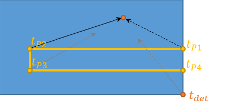

Figure 5. Shortest time is retained as the detonation time

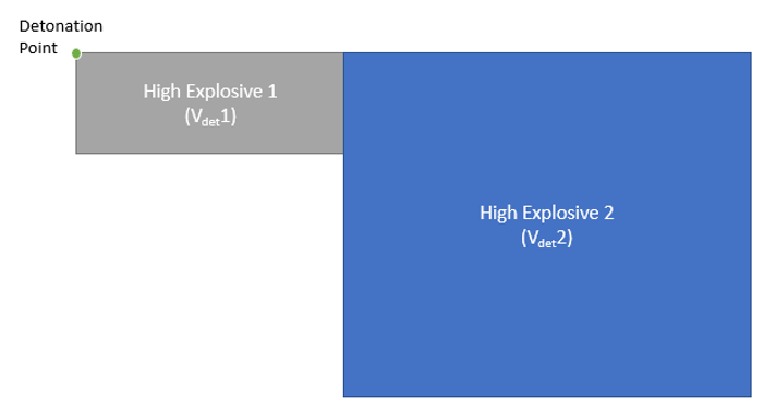

- When a direct path exists from
detonation point (element centroid or screen point), it is then lit using velocity
VDET. Otherwise, detonation velocity is
read form material with identifier mat_ID. This makes detonation of two adjacent explosives possible.
Figure 6. Two adjacent explosive materials with two different detonation velocities
Figure 7. Detonation times are computed with different detonation velocities in each side of the screen lines
