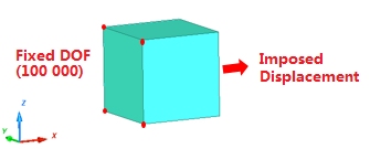

Uniaxial tensile one brick element with imposed displacement and fixed in other side only in X direction.
Figure 2. Problem Description
Units: mm, s, Mg, N, MPa
Table 1 shows curve input or parameter input available for hyperelastic material model.
Properties: /PROP/SOLID with, Isolid=24, Ismstr=10, and Icpre=1.
When using hyperelastic material laws, there are some recommended element property settings. When using solid elements, it is always better to mesh with 8 node /BRICK elements if possible. If not then /TETRA4 or /TETRA10 elements can be used.
Recommend /PROP/SOLID for 8 nodes brick:
  • Ismstr=10
  • Icpre=1 with Isolid=24.
Note: If hourglassing occurs, then Isolid=17 with Iframe=2 can be used.

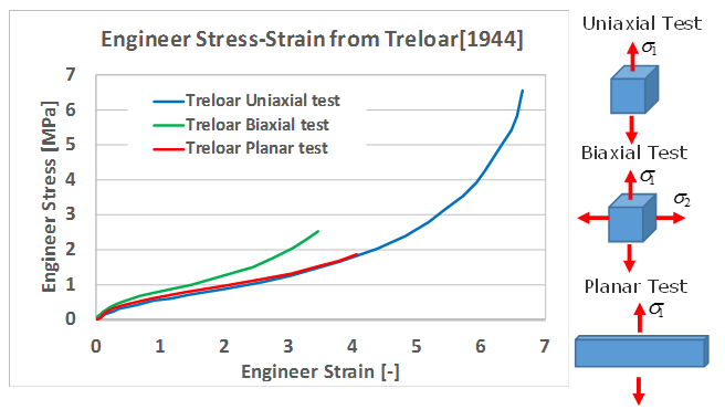

This example demonstrates how to use engineering stress versus strain test as curve input and parameter input different material laws. The hyperelastic data gathered by Figure 3 for 8 % sulfur rubber test data is used. Figure 3 shows the Treloar test data for the 3 strain states most important in characterizing a material, uniaxial tension, equal biaxial extension and pure shear (planar tension). 2
Figure 3. Test Data from Treloar [1944]
Table 1 summarizes which material laws have test data input and/or parameter input in Radioss for hyperelastic material model.

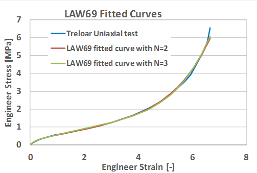

The test and Radioss data can then be plotted to compare how well the material law fits the input test data.
Figure 4. LAW69 Fitted Curve with N=2 and N=3 for Odgen Model

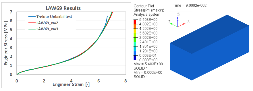

Then the calculated material parameters in the Radioss Engine solution are used.
Figure 5. LAW69 Results from a 1 Element Model with N=2 and N=3
Figure 5 shows the calculated stress strain curve from the 1 element model simulation matches the Treloar test data.
The engineering stress strain curves were calculated from the true stress and true strain in principal direction 1 (P1) from the animation output /ANIM/BRICK/TENS/STRAIN and /ANIM/BRICK/TENS/STRESS using these formulas.
ε e = λ − 1 MathType@MTEF@5@5@+= feaagKart1ev2aqatCvAUfeBSjuyZL2yd9gzLbvyNv2CaerbuLwBLn hiov2DGi1BTfMBaeXatLxBI9gBaerbd9wDYLwzYbItLDharqqtubsr 4rNCHbGeaGqiVu0Je9sqqrpepC0xbbL8F4rqGqFfpeea0xe9vq=Jb9 vqpeea0xd9q8qiYRWxGi6xij=hbba9q8aq0=yq=He9q8qiLsFr0=vr 0=vr0db8meaabaqaciGacaGaaeqabaWaaeaaeaaakeaacqaH1oqzda WgaaWcbaGaamyzaaqabaGccqGH9aqpcqaH7oaBcqGHsislcaaIXaaa aa@3E91@
σ t r = λ ⋅ σ e MathType@MTEF@5@5@+= feaagKart1ev2aqatCvAUfeBSjuyZL2yd9gzLbvyNv2CaerbuLwBLn hiov2DGi1BTfMBaeXatLxBI9gBaerbd9wDYLwzYbItLDharqqtubsr 4rNCHbGeaGqiVu0Je9sqqrpepC0xbbL8F4rqGqFfpeea0xe9vq=Jb9 vqpeea0xd9q8qiYRWxGi6xij=hbba9q8aq0=yq=He9q8qiLsFr0=vr 0=vr0db8meaabaqaciGacaGaaeqabaWaaeaaeaaakeaacqaHdpWCda WgaaWcbaGaamiDaiaadkhaaeqaaOGaeyypa0Jaeq4UdWMaeyyXICTa eq4Wdm3aaSbaaSqaaiaadwgaaeqaaaaa@432E@ , ε t r = ln ( λ ) MathType@MTEF@5@5@+= feaagKart1ev2aqatCvAUfeBSjuyZL2yd9gzLbvyNv2CaerbuLwBLn hiov2DGi1BTfMBaeXatLxBI9gBaerbd9wDYLwzYbItLDharqqtubsr 4rNCHbGeaGqiVu0Je9sqqrpepC0xbbL8F4rqGqFfpeea0xe9vq=Jb9 vqpeea0xd9q8qiYRWxGi6xij=hbba9q8aq0=yq=He9q8qiLsFr0=vr 0=vr0db8meaabaqaciGacaGaaeqabaWaaeaaeaaakeaacqaH1oqzda WgaaWcbaGaamiDaiaadkhaaeqaaOGaeyypa0JaciiBaiaac6gadaqa daqaaiabeU7aSbGaayjkaiaawMcaaaaa@415C@
σ e = σ t r ε e + 1 MathType@MTEF@5@5@+= feaagKart1ev2aqatCvAUfeBSjuyZL2yd9gzLbvyNv2CaerbuLwBLn hiov2DGi1BTfMBaeXatLxBI9gBaerbd9wDYLwzYbItLDharqqtubsr 4rNCHbGeaGqiVu0Jh9qqqrpepC0xbbL8F4rqGqFfpeea0xe9vq=Jb9 vqpeea0xd9q8qiYRWxGi6xij=hbba9q8aq0=yq=He9q8qiLsFr0=vr 0=vr0db8meaabaqaciGacaGaaeqabaWaaeaaeaaakeaacqaHdpWCda WgaaWcbaGaamyzaaqabaGccqGH9aqpdaWcaaqaaiabeo8aZnaaBaaa leaacaWG0bGaamOCaaqabaaakeaacqaH1oqzdaWgaaWcbaGaamyzaa qabaGccqGHRaWkcaaIXaaaaaaa@4391@ , ε e = e ε t r − 1 MathType@MTEF@5@5@+= feaagKart1ev2aqatCvAUfeBSjuyZL2yd9gzLbvyNv2CaerbuLwBLn hiov2DGi1BTfMBaeXatLxBI9gBaerbd9wDYLwzYbItLDharqqtubsr 4rNCHbGeaGqiVu0Je9sqqrpepC0xbbL8F4rqGqFfpeea0xe9vq=Jb9 vqpeea0xd9q8qiYRWxGi6xij=hbba9q8aq0=yq=He9q8qiLsFr0=vr 0=vr0db8meaabaqaciGacaGaaeqabaWaaeaaeaaakeaacqaH1oqzda WgaaWcbaGaamyzaaqabaGccqGH9aqpcaWGLbWaaWbaaSqabeaacqaH 1oqzdaWgaaadbaGaamiDaiaadkhaaeqaaaaakiabgkHiTiaaigdaaa a@41C2@

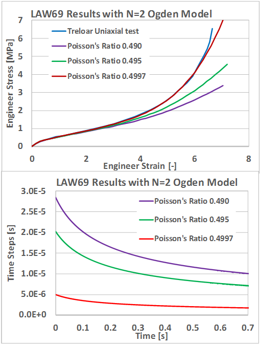

Effect of Poisson’s Ratio and Bulk Modulus
In LAW69, the fitted Ogden parameters are based on assumption of incompressible material which means that ν = 0.5 MathType@MTEF@5@5@+= feaagKart1ev2aqatCvAUfeBSjuyZL2yd9gzLbvyNv2CaerbuLwBLn hiov2DGi1BTfMBaeXatLxBI9gBaerbd9wDYLwzYbItLDharqqtubsr 4rNCHbGeaGqiVu0Jh9qqqrpepC0xbbL8F4rqGqFfpeea0xe9vq=Jb9 vqpeea0xd9q8qiYRWxGi6xij=hbba9q8aq0=yq=He9q8qiLsFr0=vr 0=vr0db8meaabaqaciGacaGaaeqabaWaaeaaeaaakeaacqaH9oGBcq GH9aqpcaaIWaGaaiOlaiaaiwdaaaa@3C34@ . However, in practice is not possible to use ν = 0.5 MathType@MTEF@5@5@+= feaagKart1ev2aqatCvAUfeBSjuyZL2yd9gzLbvyNv2CaerbuLwBLn hiov2DGi1BTfMBaeXatLxBI9gBaerbd9wDYLwzYbItLDharqqtubsr 4rNCHbGeaGqiVu0Jh9qqqrpepC0xbbL8F4rqGqFfpeea0xe9vq=Jb9 vqpeea0xd9q8qiYRWxGi6xij=hbba9q8aq0=yq=He9q8qiLsFr0=vr 0=vr0db8meaabaqaciGacaGaaeqabaWaaeaaeaaakeaacqaH9oGBcq GH9aqpcaaIWaGaaiOlaiaaiwdaaaa@3C34@ because that would result in an infinite bulk modulus, an infinite speed of sound, and thus, an infinitely small solid element Time Step.
K = μ ⋅ 2 ( 1 + ν ) 3 ( 1 − 2 ν ) = μ ⋅ 2 ( 1 + ν ) 3 ( 1 − 2 * 0.5 ) = ∞ MathType@MTEF@5@5@+= feaagKart1ev2aqatCvAUfeBSjuyZL2yd9gzLbvyNv2CaerbuLwBLn hiov2DGi1BTfMBaeXatLxBI9gBaerbd9wDYLwzYbItLDharqqtubsr 4rNCHbGeaGqiVu0Je9sqqrpepC0xbbL8F4rqqrFfpeea0xe9Lq=Jc9 vqaqpepm0xbba9pwe9Q8fs0=yqaqpepae9pg0FirpepeKkFr0xfr=x fr=xb9adbaqaaeGaciGaaiaabeqaamaabaabaaGcbaGaam4saiabg2 da9iabeY7aTjabgwSixpaalaaabaGaaGOmamaabmaabaGaaGymaiab gUcaRiabe27aUbGaayjkaiaawMcaaaqaaiaaiodadaqadaqaaiaaig dacqGHsislcaaIYaGaeqyVd4gacaGLOaGaayzkaaaaaiabg2da9iab eY7aTjabgwSixpaalaaabaGaaGOmamaabmaabaGaaGymaiabgUcaRi abe27aUbGaayjkaiaawMcaaaqaaiaaiodadaqadaqaaiaaigdacqGH sislcaaIYaGaaiOkaiaaicdacaGGUaGaaGynaaGaayjkaiaawMcaaa aacqGH9aqpcqGHEisPaaa@5C83@
The effect of different Poison’s ratio input can be seen in Figure 6. The largest difference in the results is at higher amounts of strain. The results will match the test data better when but this results in a time step that is 4 times lower than ν = 0.495 MathType@MTEF@5@5@+= feaagKart1ev2aqatCvAUfeBSjuyZL2yd9gzLbvyNv2CaerbuLwBLn hiov2DGi1BTfMBaeXatLxBI9gBaerbd9wDYLwzYbItLDharqqtubsr 4rNCHbGeaGqiVu0Jh9qqqrpepC0xbbL8F4rqGqFfpeea0xe9vq=Jb9 vqpeea0xd9q8qiYRWxGi6xij=hbba9q8aq0=yq=He9q8qiLsFr0=vr 0=vr0db8meaabaqaciGacaGaaeqabaWaaeaaeaaakeaacqaH9oGBcq GH9aqpcaaIWaGaaiOlaiaaisdacaaI5aGaaGynaaaa@3DB5@ . Thus, to balance the computation time and accuracy it is recommended to use ν = 0.495 MathType@MTEF@5@5@+= feaagKart1ev2aqatCvAUfeBSjuyZL2yd9gzLbvyNv2CaerbuLwBLn hiov2DGi1BTfMBaeXatLxBI9gBaerbd9wDYLwzYbItLDharqqtubsr 4rNCHbGeaGqiVu0Jh9qqqrpepC0xbbL8F4rqGqFfpeea0xe9vq=Jb9 vqpeea0xd9q8qiYRWxGi6xij=hbba9q8aq0=yq=He9q8qiLsFr0=vr 0=vr0db8meaabaqaciGacaGaaeqabaWaaeaaeaaakeaacqaH9oGBcq GH9aqpcaaIWaGaaiOlaiaaisdacaaI5aGaaGynaaaa@3DB5@ for incompressible rubber material.
The effect of Poisson’s ratio and bulk modulus are similar in other Ogden material law.
Figure 6. Effect of Poisson’s Ratio in Results and in Time Step

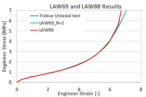

Test Data Input with LAW88
LAW88 supports the input of strain rate dependent loading curves and an unloading curve. In this law, the Ogden equation can be exactly fit by using the uniaxial test data. By using the uniaxial test data input and bulk modulus from in LAW69, LAW88 matches the test curve better than LAW69. If the bulk modulus is not available from test data, then LAW69 could be used to calculate the bulk modulus, which is then written to the Starter output file *0000.out, shown above.

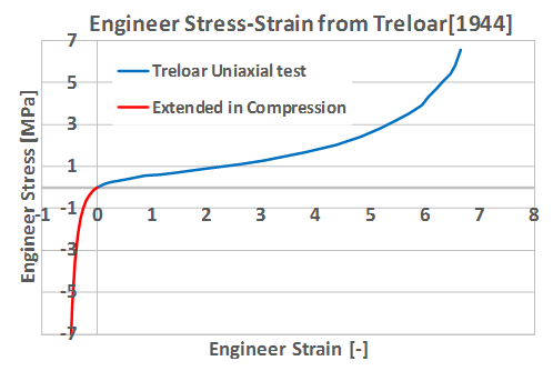

Note: With LAW88, it is recommended to use uniaxial test data that includes both compression and tension.
Figure 7. Results of LAW69 and LAW88 Compared with Test Data

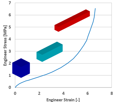

If only uniaxial tension data is available, then LAW69 could be used to compress one element and extract the compressive stress strain data making sure to convert the true stress and strain to engineering stress and strain. Then, the compressive data could be included with the uniaxial tensile data and used in LAW88. This work around is probably only useful if LAW88 is being used with uniaxial tensile stress strain data at different strain rates.
Figure 8. Test Data Extended in Compression

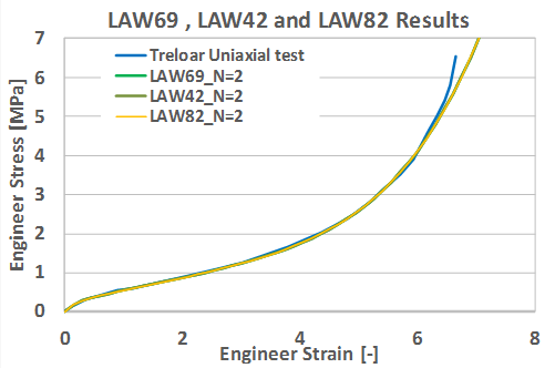

Figure 9 shows the material fit parameters from LAW69 converted into LAW82 match the LAW69 and LAW42 results for Ogden order, N=2.

Figure 9. Results of LAW69, LAW42 and LAW82 Compared with Test Data

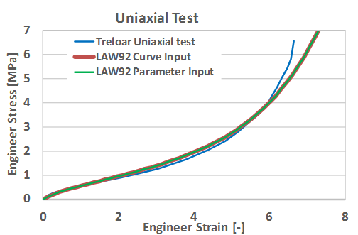

The Arruda-Boyce material model (/MAT/LAW92) can accept either test data input or material parameter input. When using test data, there are three different test data inputs that can be used.
Figure 10. Itype=1: Uniaxial test
Figure 11. Itype=2: Equibiaxial test
Figure 12. Itype=3: Planar test
In LAW92, if the curve input is used then the parameter lines can be left blank. Only one type of test data type can be considered at a time.

Figure 13. Equivalent LAW92 Used with Curve Input and Parameter Input
Figure 13 shows the same results using curve input and parameter input in LAW92.

Only one test type (Itype) can be used in LAW92. Different Arruda-Boyce parameters are calculated for each different type of test data. If uniaxial test type is used in LAW92, it would describe the uniaxial deformation behavior better than biaxial or shear behavior. In order to better describe all the possible deformation behavior, an engineer can set proper weights for each μ ,     D ,   λ m MathType@MTEF@5@5@+= feaagKart1ev2aqatCvAUfeBSjuyZL2yd9gzLbvyNv2CaerbuLwBLn hiov2DGi1BTfMBaeXatLxBI9gBaerbd9wDYLwzYbItLDharqqtubsr 4rNCHbGeaGqiVu0Jh9qqqrpepC0xbbL8F4rqGqFfpeea0xe9vq=Jb9 vqpeea0xd9q8qiYRWxGi6xij=hbba9q8aq0=yq=He9q8qiLsFr0=vr 0=vr0db8meaabaqaciGacaGaaeqabaWaaeaaeaaakeaacqaH8oqBca GGSaGaaGjcVlaaysW7caWGebGaaiilaiaaysW7cqaH7oaBdaWgaaWc baGaamyBaaqabaaaaa@42A7@ from three different test types.
μ = 1 3 μ u n i a x i a l + 1 3 μ e q u i b i a x i a l + 1 3 μ p l a n a r MathType@MTEF@5@5@+= feaagKart1ev2aqatCvAUfeBSjuyZL2yd9gzLbvyNv2CaerbuLwBLn hiov2DGi1BTfMBaeXatLxBI9gBaerbd9wDYLwzYbItLDharqqtubsr 4rNCHbGeaGqiVu0Jh9qqqrpepC0xbbL8F4rqGqFfpeea0xe9vq=Jb9 vqpeea0xd9q8qiYRWxGi6xij=hbba9q8aq0=yq=He9q8qiLsFr0=vr 0=vr0db8meaabaqaciGacaGaaeqabaWaaeaaeaaakeaacqaH8oqBcq GH9aqpdaWcaaqaaiaaigdaaeaacaaIZaaaaiabeY7aTnaaCaaaleqa baGaamyDaiaad6gacaWGPbGaamyyaiaadIhacaWGPbGaamyyaiaadY gaaaGccqGHRaWkdaWcaaqaaiaaigdaaeaacaaIZaaaaiabeY7aTnaa CaaaleqabaGaamyzaiaadghacaWG1bGaamyAaiaadkgacaWGPbGaam yyaiaadIhacaWGPbGaamyyaiaadYgaaaGccqGHRaWkdaWcaaqaaiaa igdaaeaacaaIZaaaaiabeY7aTnaaCaaaleqabaGaamiCaiaadYgaca WGHbGaamOBaiaadggacaWGYbaaaaaa@5D84@
D = 1 3 D u n i a x i a l + 1 3 D e q u i b i a x i a l + 1 3 D p l a n a r MathType@MTEF@5@5@+= feaagKart1ev2aqatCvAUfeBSjuyZL2yd9gzLbvyNv2CaerbuLwBLn hiov2DGi1BTfMBaeXatLxBI9gBaerbd9wDYLwzYbItLDharqqtubsr 4rNCHbGeaGqiVu0Jh9qqqrpepC0xbbL8F4rqGqFfpeea0xe9vq=Jb9 vqpeea0xd9q8qiYRWxGi6xij=hbba9q8aq0=yq=He9q8qiLsFr0=vr 0=vr0db8meaabaqaciGacaGaaeqabaWaaeaaeaaakeaacaWGebGaey ypa0ZaaSaaaeaacaaIXaaabaGaaG4maaaacaWGebWaaWbaaSqabeaa caWG1bGaamOBaiaadMgacaWGHbGaamiEaiaadMgacaWGHbGaamiBaa aakiabgUcaRmaalaaabaGaaGymaaqaaiaaiodaaaGaamiramaaCaaa leqabaGaamyzaiaadghacaWG1bGaamyAaiaadkgacaWGPbGaamyyai aadIhacaWGPbGaamyyaiaadYgaaaGccqGHRaWkdaWcaaqaaiaaigda aeaacaaIZaaaaiaadseadaahaaWcbeqaaiaadchacaWGSbGaamyyai aad6gacaWGHbGaamOCaaaaaaa@59D0@
λ m = 1 3 λ m u n i a x i a l + 1 3 λ m e q u i b i a x i a l + 1 3 λ m p l a n a r MathType@MTEF@5@5@+= feaagKart1ev2aqatCvAUfeBSjuyZL2yd9gzLbvyNv2CaerbuLwBLn hiov2DGi1BTfMBaeXatLxBI9gBaerbd9wDYLwzYbItLDharqqtubsr 4rNCHbGeaGqiVu0Jh9qqqrpepC0xbbL8F4rqGqFfpeea0xe9vq=Jb9 vqpeea0xd9q8qiYRWxGi6xij=hbba9q8aq0=yq=He9q8qiLsFr0=vr 0=vr0db8meaabaqaciGacaGaaeqabaWaaeaaeaaakeaacqaH7oaBda WgaaWcbaGaamyBaaqabaGccqGH9aqpdaWcaaqaaiaaigdaaeaacaaI ZaaaaiabeU7aSnaaDaaaleaacaWGTbaabaGaamyDaiaad6gacaWGPb GaamyyaiaadIhacaWGPbGaamyyaiaadYgaaaGccqGHRaWkdaWcaaqa aiaaigdaaeaacaaIZaaaaiabeU7aSnaaDaaaleaacaWGTbaabaGaam yzaiaadghacaWG1bGaamyAaiaadkgacaWGPbGaamyyaiaadIhacaWG PbGaamyyaiaadYgaaaGccqGHRaWkdaWcaaqaaiaaigdaaeaacaaIZa aaaiabeU7aSnaaDaaaleaacaWGTbaabaGaamiCaiaadYgacaWGHbGa amOBaiaadggacaWGYbaaaaaa@617A@
