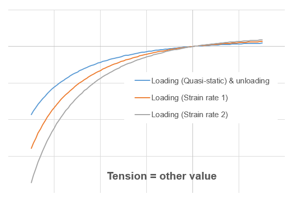

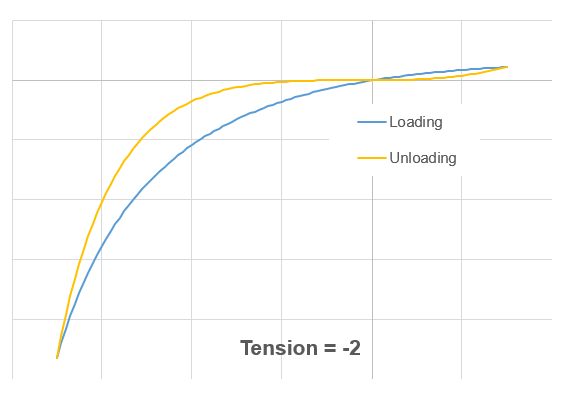

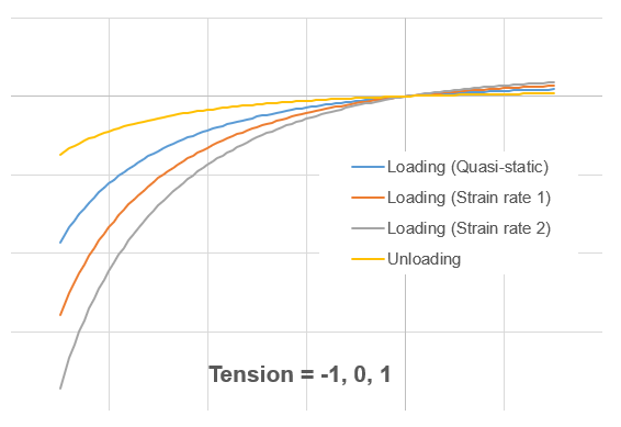

Tension Unloading rate effects option flag. 4
= -2
Unloading curve is used and should have a closed loop (both and compression and tensile) with the quasi-static loading curve. There is no strain rate dependency for this formulation.
= -1 or 1
Unloading curve is used if fct_IDunL is defined. Otherwise, Hys and Shape parameters are used.
= 0 (Default)
Set to 1.
Otherwise, the quasi-static loading curve is used for unloading.
(Integer)

  4. The loading and unloading curves are defined with positive stress and strain in tensile and negative stress and strain in compression.
    The following curves are needed according to Tension flag:
    • Tension = -1, 0, or 1
    • Tension = -2
    • Tension = other value
      Figure 3.
