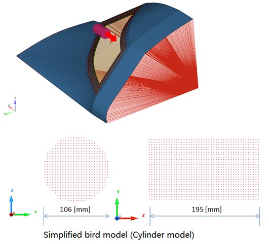

A bird weighing about 1.93kg (4 pounds) with an initial speed of 80m/s impacts a windshield of a plane. The bird model is extremely simplified using a cylinder (diameter: 106mm; height: 195mm), it represents all major options used in a bird strike analysis. The edge of the plane model is fixed using a rigid body. Boundary conditions are applied on the main node.
Figure 2. Problem Description
ex_49_bird_model
Units: mm, ms, kg, KN, GPa

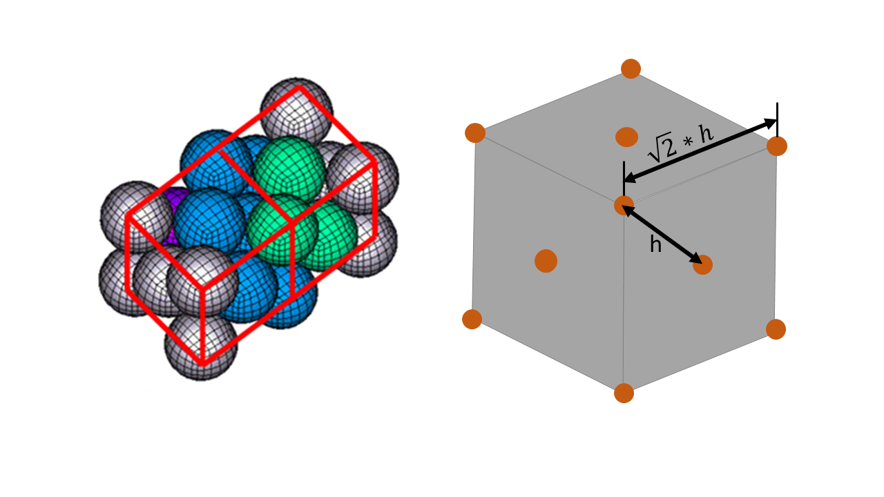

/PROP/TYPE34 (SPH) (face centered cubic)
mp: 1.725149e-4 [ kg ]
qa
2e-30
qb
1e-30
order
0
h
6.286 [ mm ]
Note:
  1. In property, mp is the mass of each particle. The bird model consists of 11190 particles, so the bird weighs 11190*1.725149e-4 = 1.93kg (4 pounds).
  2. For no damping qa was set 2e-30 and qb to 1e-30.
    To simulate a bird strike, the compression phase of the bird will be also considered; therefore, the initial compression wave should properly propagate through the bird. Energy conservation is also important, so that the bird communicates the most realistic amount of energy to the target, thus ensuring that the impact is reasonably conservative.
  3. In property, h MathType@MTEF@5@5@+= feaagKart1ev2aaatCvAUfeBSjuyZL2yd9gzLbvyNv2CaerbuLwBLn hiov2DGi1BTfMBaeXatLxBI9gBaerbd9wDYLwzYbItLDharqqtubsr 4rNCHbGeaGqiVu0Je9sqqrpepC0xbbL8F4rqqrFfpeea0xe9Lq=Jc9 vqaqpepm0xbba9pwe9Q8fs0=yqaqpepae9pg0FirpepeKkFr0xfr=x fr=xb9adbaqaaeGaciGaaiaabeqaamaabaabaaGcbaGaamiAaaaa@36E3@ is smoothing length:
    h = ( m p 2 ρ ) 1 3 = ( 1.725149 ⋅ 10 − 4 2 9.82242 ⋅ 10 − 7 ) 1 3 = 6.286     [ m m ]
    The smoothing length, h MathType@MTEF@5@5@+= feaagKart1ev2aaatCvAUfeBSjuyZL2yd9gzLbvyNv2CaerbuLwBLn hiov2DGi1BTfMBaeXatLxBI9gBaerbd9wDYLwzYbItLDharqqtubsr 4rNCHbGeaGqiVu0Je9sqqrpepC0xbbL8F4rqqrFfpeea0xe9Lq=Jc9 vqaqpepm0xbba9pwe9Q8fs0=yqaqpepae9pg0FirpepeKkFr0xfr=x fr=xb9adbaqaaeGaciGaaiaabeqaamaabaabaaGcbaGaamiAaaaa@36E3@ is highly recommended to use the minimum distance between each particle and its closest neighbor.
  4. SPH correction order is used to satisfy the consistency conditions and to ensure a better representation when the particles are not so well organized than into a hexagonal compact net. High order value is very expensive. In this example, order is set to 0.

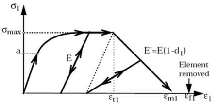

ε t 1 (Tensile failure strain in principle strain dir. 1)
0.01
ε m 1 (Maximum tensile failure strain in principal strain dir. 1)
0.03
element deleted at ε f 1 (Tensile strain for element deletion in principal strain dir. 1)
0.06
Figure 3.
ex_49_glass_matrix

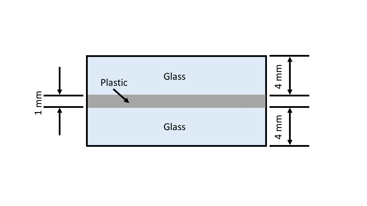

/PROP/TYPE11 (SH_SANDW):
Material Properties
Thickness of windshield
9 [mm]
Number of layers, N
9
Ithick
1
Figure 4. Windshield consisting of composite material with matrix glass and plastic fabric
ex_49_plastic_fabric

  • Bird modeling
    The bird model consists of 11190 particles, the distribution follows a hexagonal compact net. The cell distribution must be cubic face centered. The diameter of each particle is about 5.0 mm.
    Figure 5. Perspective View of the Cubic Centered Faces Net

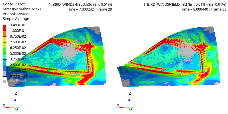

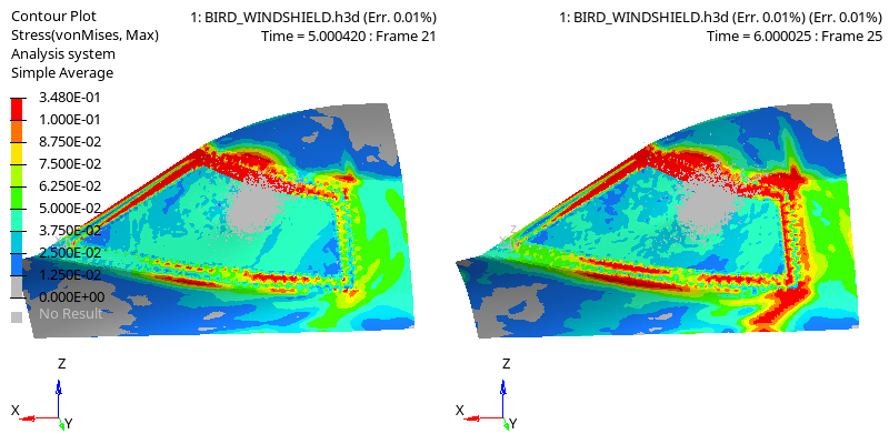

Figure 6 shows von Mises stress of the windshield at time 3ms ~ 8ms.
Figure 6. von Mises Stress at time 3ms~8ms
ex_49_contour_plot
ex_49_contour_plot3

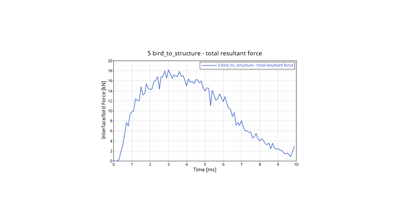

The Interface Force between the bird and the windshield is shown in Figure 7.
Figure 7. Interface Force between Bird and Windshield
ex_49_interface_force
