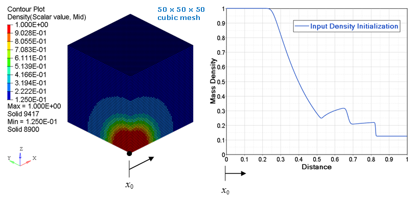

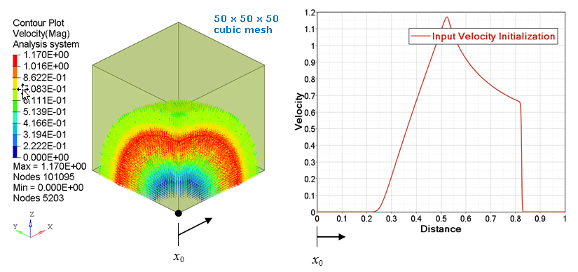

- type = 1: a planar initialization is performed where the 1D results are mapped onto a plane which is normal to the vector defined from node_ID1 to node_ID2. The abscissa values in an input function are the distance along the plane’s normal vector. The ordinate values from the input function are a constant value for the entire plane at a given distance along the normal. See Figure 1 and Figure 2.

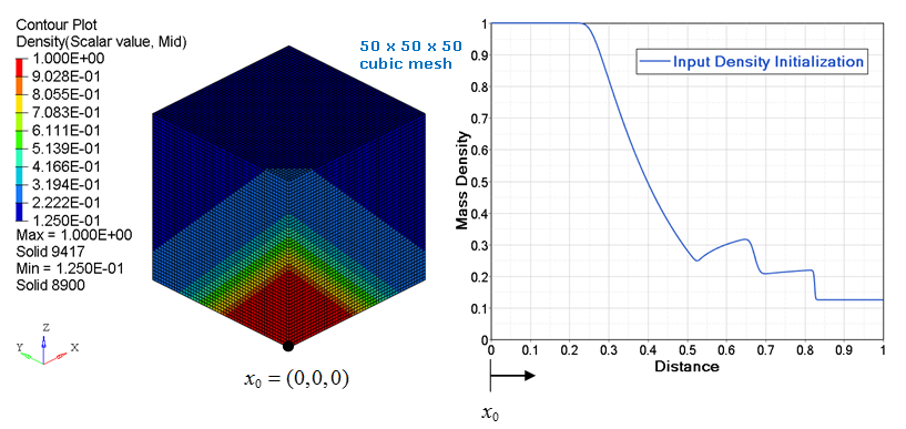

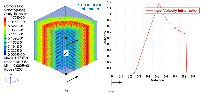

- type = 2: a cylindrical initialization is performed where the local z cylindrical axis is defined from node_ID1 to node_ID2. The abscissa values in an input function are the radial distance from the local z cylindrical axis. The ordinate values from the input function are a constant value for the entire cylindrical surface at given radial distance. See Figure 3 and Figure 4.

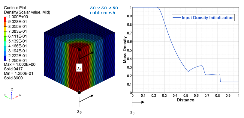

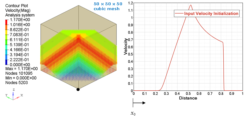

- type = 3: a spherical initialization is performed, using the origin defined by node_ID1. The abscissa values in an input function are the radial distance from origin. The ordinate values from the input function are a constant value for the entire spherical surface at given radial distance. See Figure 5 and Figure 6.

Figure 1. Mass Density (with input function) Planar Mapping on a 50 x 50 x 50 Cubic Mesh
Figure 2. Velocity (with input function) Planar Mapping on a 50 x 50 x 50 Cubic Mesh
Figure 3. Mass Density (with input function) Cylindrical Mapping on a 50 x 50 x 50 Cubic Mesh
Figure 4. Velocity (with input function) Cylindrical Mapping on a 50 x 50 x 50 Cubic Mesh
Figure 5. Mass Density (with input function) Spherical Mapping on a 50 x 50 x 50 Cubic Mesh
Figure 6. Velocity (with input function) Spherical Mapping on a 50 x 50 x 50 Cubic Mesh
