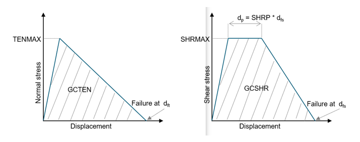

- The two
parameters GCTEN and GCSHR are
respectively the areas under the curves of stress versus displacement for
pure tension and pure shear.
Figure 1. Stress- displacement curves for pure tension and pure shear
- The failure
displacement limits are defined with:
- In pure tension
- In pure shear
Element is deleted when one failure limit is reached.
