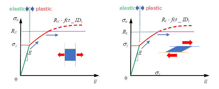

    • After reaching the yield stress (defined in fct_ID1), the material goes into the plastic phase. After reach the maximum stress RN (in tension) or RS (in shear), the stress in material will not increase (Figure 1).
    • The plastic displacement is accounted for when fct_ID1 is specified. This is usually a non-decreasing function, which represents true stress as a function of the plastic displacement. The first abscissa value of the function should be “0” and the first ordinate value is the "yield stress". The function may have a stress decrease portion to model material damage.

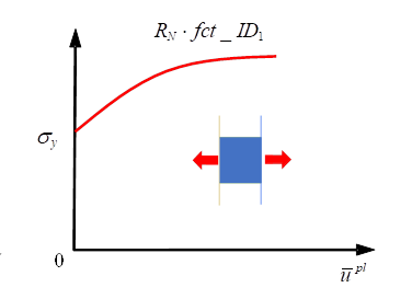

  3. Plastic displacement.
    The complete element displacement u ¯ MathType@MTEF@5@5@+= feaagKart1ev2aaatCvAUfeBSjuyZL2yd9gzLbvyNv2CaerbuLwBLn hiov2DGi1BTfMBaeXatLxBI9gBaerbd9wDYLwzYbItLDharqqtubsr 4rNCHbGeaGqiVu0Je9sqqrpepC0xbbL8F4rqqrFfpeea0xe9Lq=Jc9 vqaqpepm0xbba9pwe9Q8fs0=yqaqpepae9pg0FirpepeKkFr0xfr=x fr=xb9adbaqaaeGaciGaaiaabeqaamaabaabaaGcbaGabmyDayaara aaaa@3708@ can be subdivided into an elastic portion u ¯ e MathType@MTEF@5@5@+= feaagKart1ev2aaatCvAUfeBSjuyZL2yd9gzLbvyNv2CaerbuLwBLn hiov2DGi1BTfMBaeXatLxBI9gBaerbd9wDYLwzYbItLDharqqtubsr 4rNCHbGeaGqiVu0Je9sqqrpepC0xbbL8F4rqqrFfpeea0xe9Lq=Jc9 vqaqpepm0xbba9pwe9Q8fs0=yqaqpepae9pg0FirpepeKkFr0xfr=x fr=xb9adbaqaaeGaciGaaiaabeqaamaabaabaaGcbaGabmyDayaara WaaWbaaSqabeaacaWGLbaaaaaa@381F@ (before yield stress is reached) and a portion of the plastic displacement u ¯ p l MathType@MTEF@5@5@+= feaagKart1ev2aaatCvAUfeBSjuyZL2yd9gzLbvyNv2CaerbuLwBLn hiov2DGi1BTfMBaeXatLxBI9gBaerbd9wDYLwzYbItLDharqqtubsr 4rNCHbGeaGqiVu0Je9sqqrpepC0xbbL8F4rqqrFfpeea0xe9Lq=Jc9 vqaqpepm0xbba9pwe9Q8fs0=yqaqpepae9pg0FirpepeKkFr0xfr=x fr=xb9adbaqaaeGaciGaaiaabeqaamaabaabaaGcbaGabmyDayaara WaaWbaaSqabeaacaWGWbGaamiBaaaaaaa@391B@ . In the simplest case of uni-axial tension and compression, plastic displacement is calculated as:
    u ¯ p l = u ¯ − u ¯ e = u ¯ − σ t r E MathType@MTEF@5@5@+= feaagKart1ev2aaatCvAUfeBSjuyZL2yd9gzLbvyNv2CaerbuLwBLn hiov2DGi1BTfMBaeXatLxBI9gBaerbd9wDYLwzYbItLDharqqtubsr 4rNCHbGeaGqiVu0Je9sqqrpepC0xbbL8F4rqqrFfpeea0xe9Lq=Jc9 vqaqpepm0xbba9pwe9Q8fs0=yqaqpepae9pg0FirpepeKkFr0xfr=x fr=xb9adbaqaaeGaciGaaiaabeqaamaabaabaaGcbaGabmyDayaara WaaWbaaSqabeaacaWGWbGaamiBaaaakiabg2da9iqadwhagaqeaiab gkHiTiqadwhagaqeamaaCaaaleqabaGaamyzaaaakiabg2da9iqadw hagaqeaiabgkHiTmaalaaabaGaeq4Wdm3aaSbaaSqaaiaadshacaWG YbaabeaaaOqaaiaadweaaaaaaa@4625@
    Total normal displacement is the sum of plastic normal displacement and elastic normal displacement.

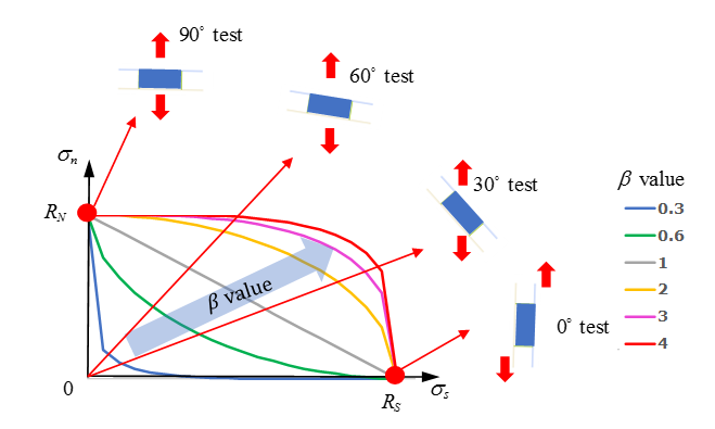

  5. The normal and shear DOF are coupled in the plastic region. The normalized effective true stress ( σ y ) is calculated from normal ( σ n ) and shear stress ( σ s ), as:
    σ y = [ ( σ n R N ⋅ f N ( 1 − α ⋅ sym ) ) β + ( σ s R S ⋅ f S ) β ] 1 β MathType@MTEF@5@5@+= feaagKart1ev2aaatCvAUfeBSjuyZL2yd9gzLbvyNv2CaerbuLwBLn hiov2DGi1BTfMBaeXatLxBI9gBaerbd9wDYLwzYbItLDharqqtubsr 4rNCHbGeaGqiVu0Je9sqqrpepC0xbbL8F4rqqrFfpeea0xe9Lq=Jc9 vqaqpepm0xbba9pwe9Q8fs0=yqaqpepae9pg0FirpepeKkFr0xfr=x fr=xb9adbaqaaeGaciGaaiaabeqaamaabaabaaGcbaGaeq4Wdm3aaS baaSqaaiaadMhaaeqaaOGaeyypa0ZaamWaaeaadaqadaqaamaalaaa baGaeq4Wdm3aaSbaaSqaaiaad6gaaeqaaaGcbaGaamOuamaaBaaale aacaWGobaabeaakiabgwSixlGacAgadaWgaaWcbaGaamOtaaqabaGc daqadaqaaiaaigdacqGHsislcqaHXoqycqGHflY1ciGGZbGaaiyEai aac2gaaiaawIcacaGLPaaaaaaacaGLOaGaayzkaaWaaWbaaSqabeaa cqaHYoGyaaGccqGHRaWkdaqadaqaamaalaaabaGaeq4Wdm3aaSbaaS qaaiaadohaaeqaaaGcbaGaamOuamaaBaaaleaacaWGtbaabeaakiab gwSixlGacAgadaWgaaWcbaGaam4uaaqabaaaaaGccaGLOaGaayzkaa WaaWbaaSqabeaacqaHYoGyaaaakiaawUfacaGLDbaadaahaaWcbeqa amaalaaabaGaaGymaaqaaiabek7aIbaaaaaaaa@6268@
    Where,
    f N and f S
    Functions of fct_IDN and fct_IDS.
    fct_IDN and fct_IDS
    Specify a scaling coefficient for normal and shear stress as a function of the plastic displacement rate.

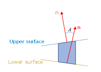

    sym MathType@MTEF@5@5@+= feaagKart1ev2aaatCvAUfeBSjuyZL2yd9gzLbvyNv2CaerbuLwBLn hiov2DGi1BTfMBaeXatLxBI9gBaerbd9wDYLwzYbItLDharqqtubsr 4rNCHbGeaGqiVu0Je9sqqrpepC0xbbL8F4rqqrFfpeea0xe9Lq=Jc9 vqaqpepm0xbba9pwe9Q8fs0=yqaqpepae9pg0FirpepeKkFr0xfr=x fr=xb9adbaqaaeGaciGaaiaabeqaamaabaabaaGcbaGaci4CaiaacM hacaGGTbaaaa@38DD@
    sin A MathType@MTEF@5@5@+= feaagKart1ev2aaatCvAUfeBSjuyZL2yd9gzLbvyNv2CaerbuLwBLn hiov2DGi1BTfMBaeXatLxBI9gBaerbd9wDYLwzYbItLDharqqtubsr 4rNCHbGeaGqiVu0Je9sqqrpepC0xbbL8F4rqqrFfpeea0xe9Lq=Jc9 vqaqpepm0xbba9pwe9Q8fs0=yqaqpepae9pg0FirpepeKkFr0xfr=x fr=xb9adbaqaaeGaciGaaiaabeqaamaabaabaaGcbaGaci4CaiaacM gacaGGUbGaamyqaaaa@3994@
    A MathType@MTEF@5@5@+= feaagKart1ev2aaatCvAUfeBSjuyZL2yd9gzLbvyNv2CaerbuLwBLn hiov2DGi1BTfMBaeXatLxBI9gBaerbd9wDYLwzYbItLDharqqtubsr 4rNCHbGeaGqiVu0Je9sqqrpepC0xbbL8F4rqqrFfpeea0xe9Lq=Jc9 vqaqpepm0xbba9pwe9Q8fs0=yqaqpepae9pg0FirpepeKkFr0xfr=x fr=xb9adbaqaaeGaciGaaiaabeqaamaabaabaaGcbaGaamyqaaaa@36BC@
    The angle between the normal of the lower surface and the normal of the upper surface of the solid element.
    Figure 3.
    α MathType@MTEF@5@5@+= feaagKart1ev2aaatCvAUfeBSjuyZL2yd9gzLbvyNv2CaerbuLwBLn hiov2DGi1BTfMBaeXatLxBI9gBaerbd9wDYLwzYbItLDharqqtubsr 4rNCHbGeaGqiVu0Je9sqqrpepC0xbbL8F4rqqrFfpeea0xe9Lq=Jc9 vqaqpepm0xbba9pwe9Q8fs0=yqaqpepae9pg0FirpepeKkFr0xfr=x fr=xb9adbaqaaeGaciGaaiaabeqaamaabaabaaGcbaGaeqySdegaaa@3795@
    Scale factor used to describe the moment effect (like in the peeling test) defined between 0.0 and 1.0.
    β
    Can be fitted with normal and shear combined test. Like the 60° test or the 30° test.
    At least one combined test is needed to fit the parameter β . Figure 4 shows the effect of β on maximum stress in the combined test.
    Figure 4.
