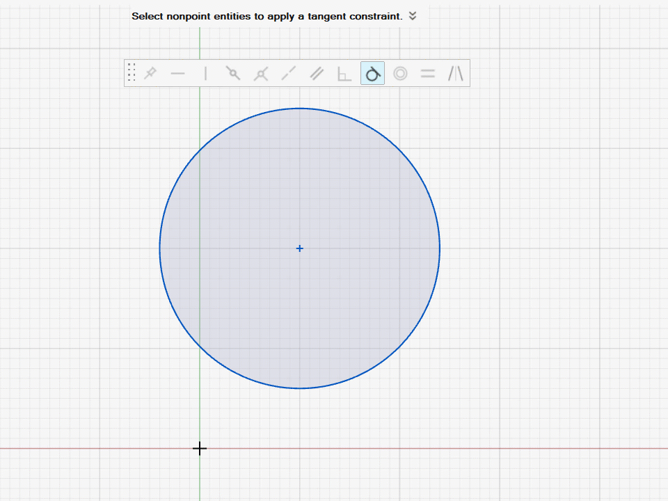

- In sketch mode, select the entities you want to constrain.
Select or deselect an icon on the Constraint Toolbar. When a constraint is
selected, it allows you to quickly select entities in the sketch to apply
constraints.
Tip:- Drag the Constraint Toolbar to the left or right side of the workspace to dock it.
- Use the Show Constraint Toolbar checkbox under Sketching in to show or hide the toolbar.
- Constraints are also available on the context menu: right-click a sketch entity, then select or deselect the icons at the top of the context menu to apply or remove constraints.
- You can select the red and green sketch axes to apply
constraints.

Click two lines to constrain them to be perpendicular. Tangent
Click a line and a circle/arc (or two circles/arcs) to constrain them to be tangent to each other. Concentric

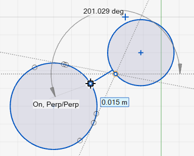

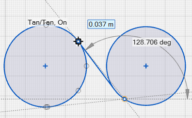

Use Inferences
Inferences are constraints that are applied automatically as you sketch to help you quickly create accurate sketches.
- In sketch mode, select the entities you want to modify.
As you modify the entities, inferences are displayed to help you.
Constraint Description Tan/Tan When you sketch a line between two circles, the Tan/Tan inference helps you make the line tangent to both circles.
Perp/Perp When you sketch a line between two circles, the Perp/Perp inference helps you make the line perpendicular to both circles.
