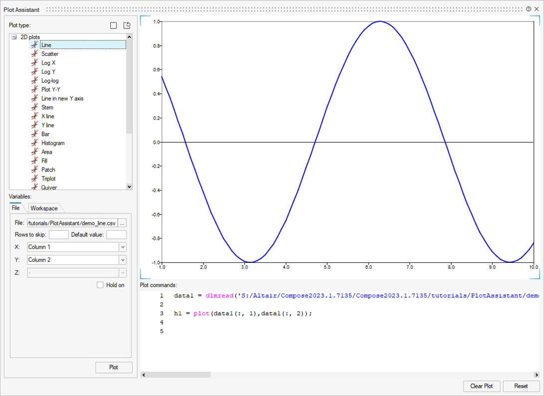

The Plot Assistant appears with tabs for plotting data from a delimited file, such as a .csv, or your OML workspace. The 2D line plot is generated on startup using data from the demo_line.csv file.
Select the data to plot:
To Plot from Do this Delimited file Select the File tab. Any headers in your file are automatically populated in the list of variables:
Otherwise, the column number is displayed:
Options include:- Rows to skip: The number of rows from the beginning of the file that dlmread does not read. This is useful when a file contains multiple lines of headers before the numeric data. The Plot Assistant tries to determine the number of rows to skip automatically when a file is selected.
- Default value: The value to be used in the output for empty or non-numeric values of the input file. If left empty, the value is set to 0.

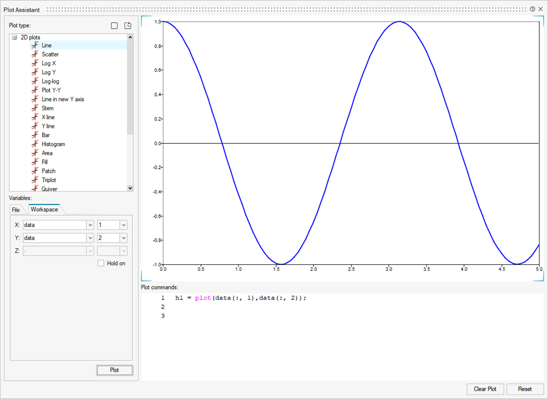

OML Workspace Select the Workspace tab, then select the desired numerical variables for X, Y and Z.
If you select a matrix variable, choose the column to plot:
Click the Plot button.
The plot is created based on your data selections:

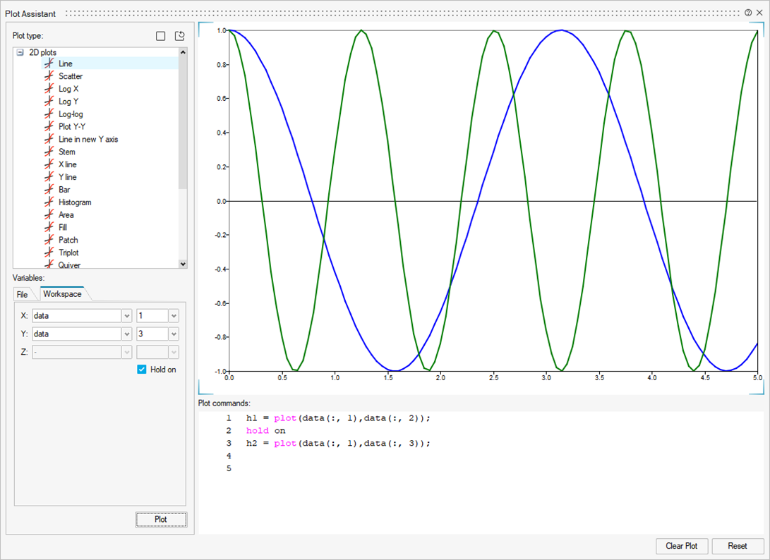

To add a curve to the plot, select Hold on, select a new
variable from the workspace or file, then click Plot
again.

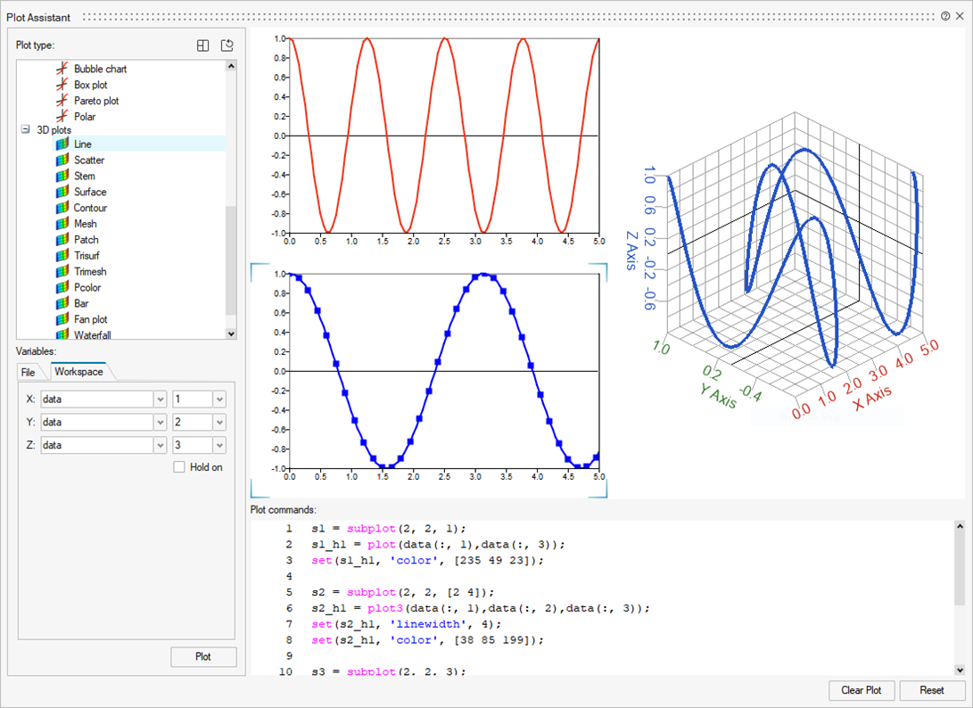

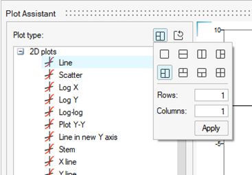

To create a subplot, click the Configure plot layout
icon and select one of the predefined layouts.
Alternatively, you can type the number of rows and columns and click Apply. The maximum number of rows and columns is four.To plot on a specific subplot, click on it. The blue lines on the subplot corners indicate the active subplot.
In the Plot commands window, the commands are grouped per subplot. -

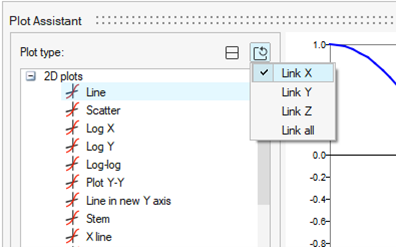

To link the subplot axes, click the Link subplot axes
icon and select one or more axes.
Click Link all to select or deselect all the axes.The selected axes are linked and synced between subplots. For example, if Link X is selected and you zoom in and out, or otherwise change the X axis range on one subplot, then the same range change is applied to the X axis of the other subplots. The Z axis is ignored in 2D plots.
