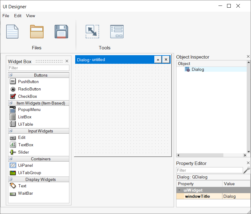

The UI Designer opens in a new window.
Drag objects from the Widget box into the Dialog to create your GUI
design.

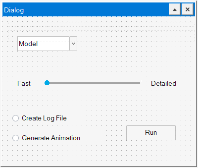

The following example shows a simple GUI with a list box, slider, radio buttons, push button and labels.
Modify the location, name, and properties of each object as required for your

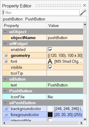

- To modify properties, select an object, then modify the desired
properties in the Property Editor.
You can also right-click an object and define a number of properties through the context menu.

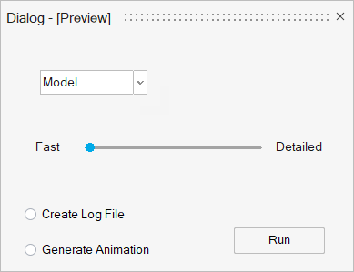

From the UI Designer ribbon, select the
Preview button.
A preview of your graphical user interface design is displayed. Review your design, then close the Preview window.

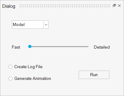

Run the file.
The software produces a GUI based on the code file you saved through the UI Designer.
