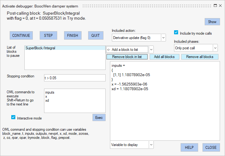

vssAreModesFixed(block)- List of blocks: SuperBlock/Integral
- Included action: Derivative update (flag 0)
- Include try mode calls
- Included phases: Only post call

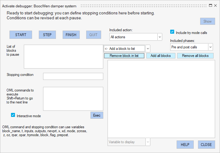

inputs
x
xdClick START to enter the first pause and see the results to the right. The initial values are shown at t = 0. To skip other similar calls until a certain time, set the stopping condition to a later time:
t > 0.05
Click CONTINUE to see the values at that time.
