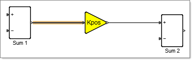

Selecting and Displaying Links
Hover over a link or link segment that you want to select.
Hovering over a link highlights or pre-selects the link which is useful when you are trying to locate a specific point or segment of a link.
Click to select the link. The software displays the status of the link as
follows:

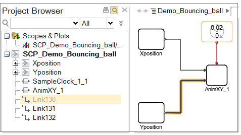

- Link Display
- The Project
Browser includes a filter to show or hide
different object types. If the filter is turned on to display links, then
every selected link in the block diagram is also selected in the Project Browser. The following
figure shows you a model of a bouncing ball diagram with Link 130
selected:

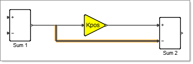

Moving Link Points and Segments
You can move links and points as required for your model.
- To move a point on a link, select any point other than the start and end point, as these are confounded with the ports. Move the point as required.
- To move link segments, select one or more link segments and move as required. By default, the orthogonal alignment of the links is preserved.
