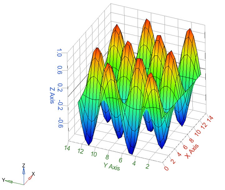

Consider the surface data shown below.
The files used in the example can be found at the following location:
<Twin Activate Installation> \hwx\databases\activate\extensions\romAI\_bin\romAIDirector\demos\romAI\auto_exploration
The auto_explore.oml file can be used to plot the surface data and write it out as .CSV file.
