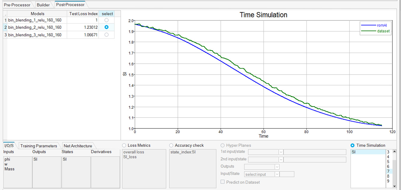

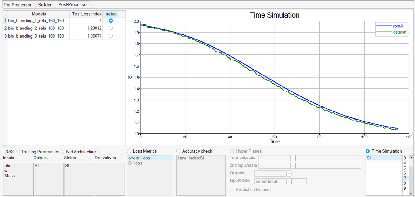

- Start the training procedure.
- After the model training is finished, the post-processor opens. The best model is
automatically selected and is indicated by a value of 1 in Test Loss Index
column.
- Click the Time Simulation radio button and use the seventh segment and compare the plot with other two trained model.
As you can see, the above two results are different even when the inputs and settings were the same for all the trained models.
