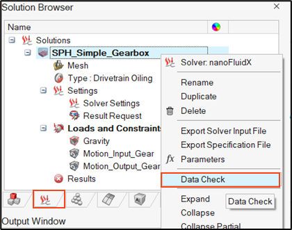

Verify the model using Data Check
- Access Data Check from the Solution Browser.
- Right-click the Solution Name and select Data Check.

- To export the model, right-click the Solution Name in the Solution Browser and select Export Solver Input File, similar to as shown in Figure 1.
- Choose to export only the configuration files (*.cfg) or both the particle (*.prtl) and configuration files.
