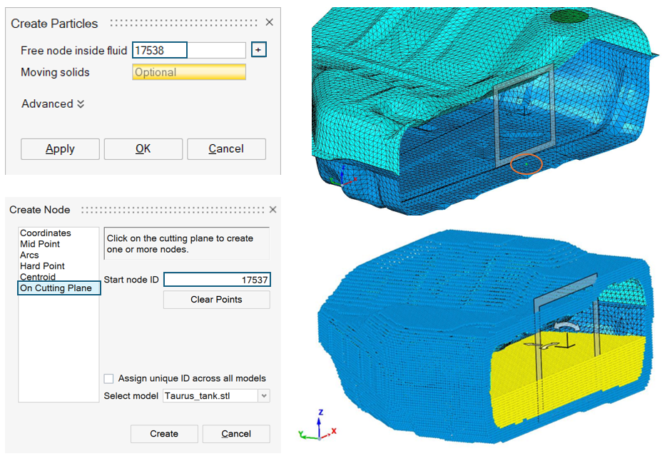

Create particles in SimLab.
Analysis > Particles
This tool generates particles for thin-section or sheet bodies using FE models as input. The particles are uniformly distributed with a specified distance between neighbors in the global coordinate system, ensuring a minimum of three layers within the volume. If the input body lacks a closed volume, particles will first enclose the surface, and then additional particles will be added to meet the specified quantity.
Figure 1. Particle Creation in SimLab
