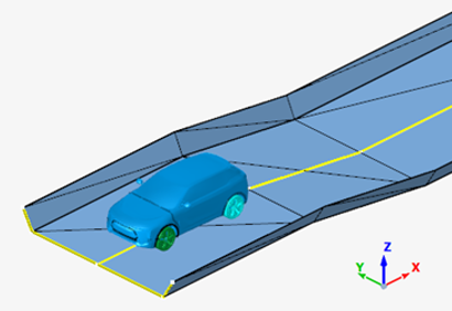

AutoDomain
Analysis > Boundary Conditions > AutoDomain
For simple vehicle wading cases, once the vehicle is positioned in the channel, the domain can be created using the AutoDomain tool.
Figure 3.
Alternatively, the vehicle may be positioned in the channel manually using the Move tool. After positioning of the vehicle you can define the domain using the Domain tool.
