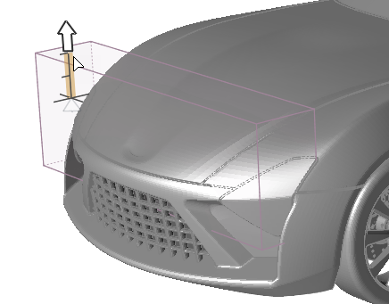

  7. Edit the size of the bounding volume in the modeling window by completing one of the following:
    • Click and drag a face of the bounding volume.
      Figure 4.

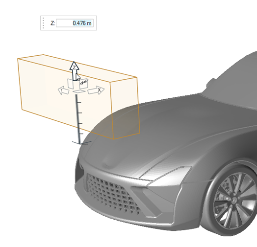

  8. Move the bounding volume by clicking in the microdialog and using the graphical manipulators.
    Figure 5.
